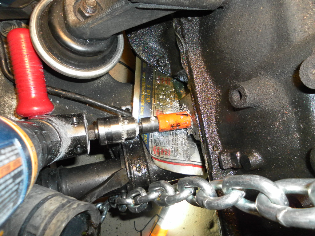

Halon 04-05-2011 08:28 PM
Re: Project Lex

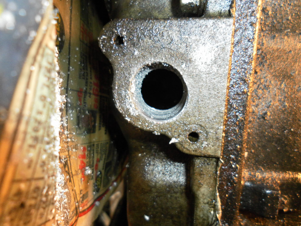

2 Attachment(s)

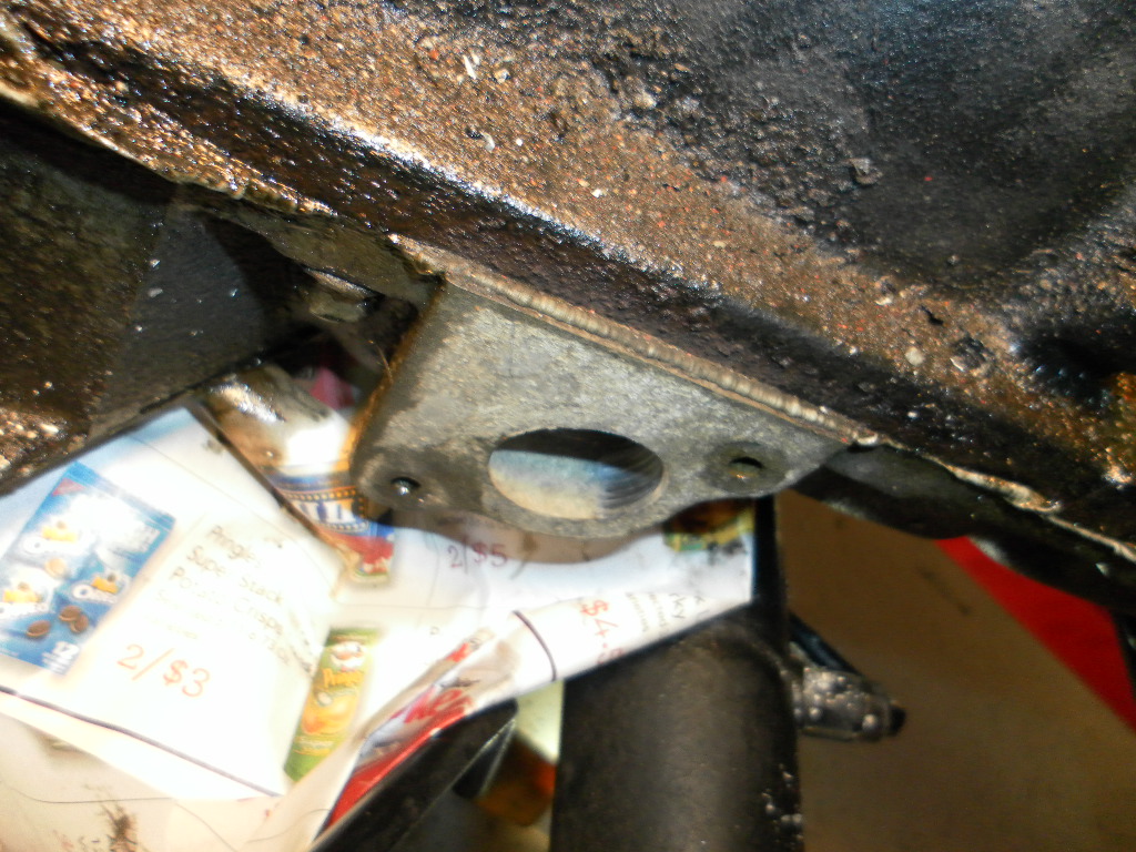

Didn't get a whole lot done. What I discovered is it appears to be impossible to completely remove the lower oil pan without either removing the engine, or removing this big arse cross-member. I needed about another 1/4" but couldn't jack the motor up any further to get that extra little bit. Oh well.
I was however able to just drop it as far as it will drop, and can slide some newspaper in there. You can see where I circled, that's where I need to drill for the oil drain line. So the newspaper should catch almost all of the metal flakes from getting into the lower oil pan.
Now just need to get a right angle drill, a Uni-bit, and that should take care of that.
http://mitsustyle.com/forums/attachm...1&d=1302049698

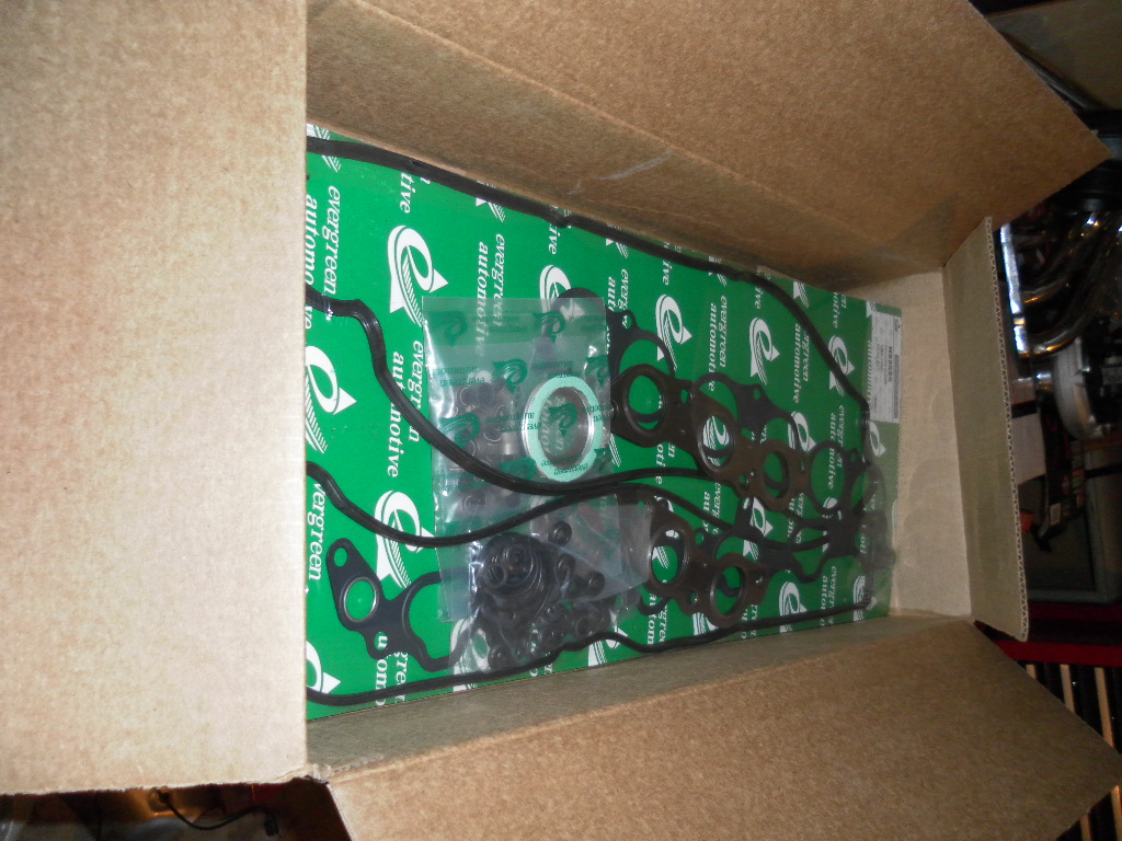

Halon 04-27-2011 09:57 PM
Re: Project Lex
4 Attachment(s)
Got home from Naw'lens today.
Went to MAPerformance and picked up a couple things as well. As always, thanks for the great prices guys!

Also had some parts waiting for me in the mail. Time to get some work done!!
Ebay Gasket kit:
http://mitsustyle.com/forums/attachm...1&d=1303955594

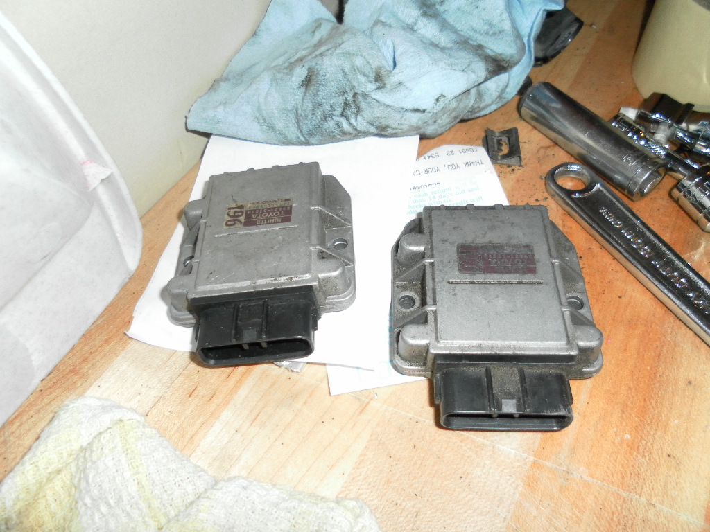

2 used ignitors from Ebay (one to replaced my burnt one, and one for a spare):

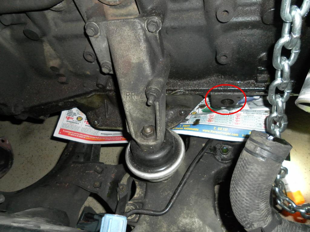

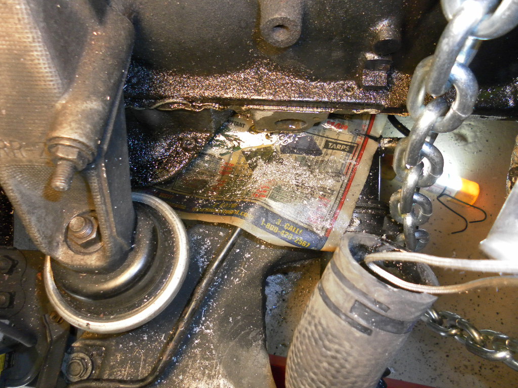

Not too much to update. But I've gotten the oil drain hole drilled out with a 7/8" hole saw. And the two bolt holes are tapped (M6x1.0).
Here's some pics:
Drilling the hole

Hole drilled:
http://mitsustyle.com/forums/attachm...1&d=1304556698

I dropped the lower oil pan and put that newspaper that you see in the pics there to catch the shavings. Apparently some people do it without dropping the pan at all. I didn't want to risk that so that's why I dropped the lower pan so I could catch the shavings on that newspaper.
As for ignitors, yeah I'll cross that road when I ditch the stock distributor. For now I'm keeping the distributor. Try to do things 1 by 1 as much as I can to make troubleshooting as simple as possible.

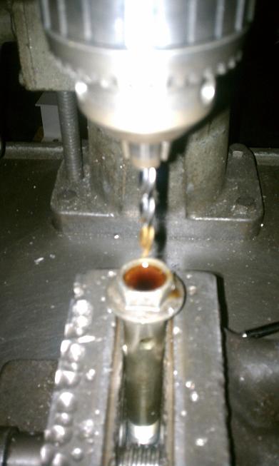

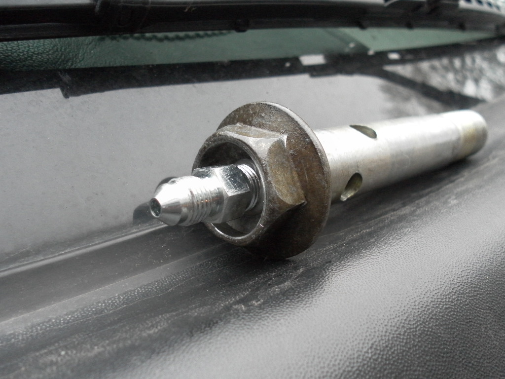

Drilled the oil filter union bolt to accept a 1/8npt fitting for my oil feed. You can either buy one for an IS300 for like $25 and it's already tapped, or just drill the stocker. And well, considering I already had a 1/8npt tap, and access to free drill bits and a drill press, that was an easy choice :)
Lots o lube:
http://mitsustyle.com/forums/attachm...1&d=1304993414
Pilot drilled:
http://mitsustyle.com/forums/attachm...1&d=1304993777
Hole drilled using "R" size drill bit, and de-burred:
Tapped for 1/8npt. Wish I coulda tapped further but it was getting HARD. That look good enough to you guys?:
1/8npt to -3AN fitting installed. Used some liquid pipe thread sealing compound on it:

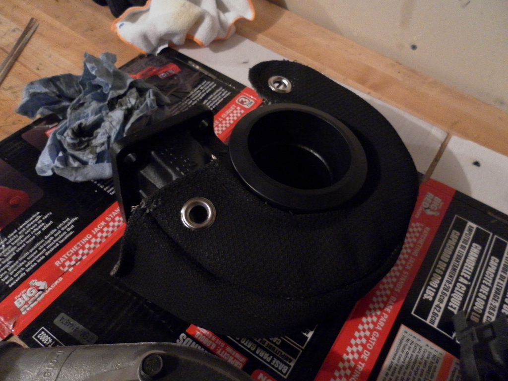

Re: Project Lex
7 Attachment(s)

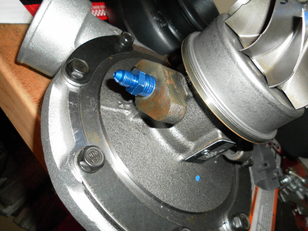

So far no other plans other than a new set of plugs. In the future, I will have to look into something, and I'm unsure which route I will go at this point.
Anyhow more updates. Got the oil pan installed. Went to put the Felpro gasket on and it's the complete wrong shape. Come to find out there's a couple different oil pan designs, and of course the gasket was for the other one. Somabitch. The gasket did come with 4 bottles of RTV however, so I just "Tpunx'd that shit" and hopefully that will suffice. We shall see...
Once I was done with that, like Spazzy mentioned I just grabbed some gasket material I had laying around and made a gasket for the oil drain flange. Gave it a coat of copper spray for good measure. So that should be done.
Installed the oil feed fitting into the turbo. I used a little bit of liquid pipe thread sealer.

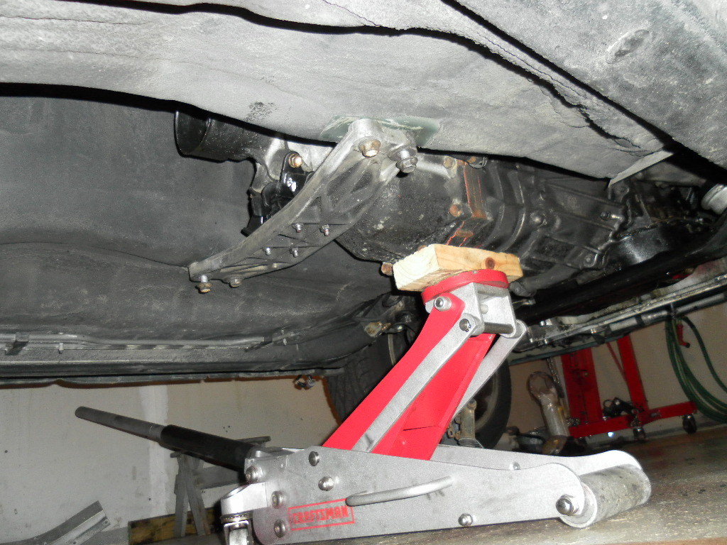

Decided to try and tackle the tranny. First I had to remove the rest of the exhaust. Once I got that off, I removed the driveshaft.
http://mitsustyle.com/forums/attachm...1&d=1305169518

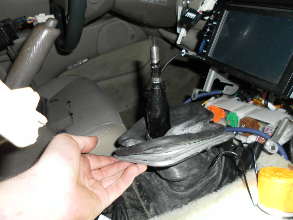

Then started at the Tranny. I got all the motor to tranny bolts off. Slave Cylinder off, Starter off. Took 2 of the 4 tranny mount bolts off. Took the reverse light plug off. And that's where it sits.
What's left is I need to find the speedometer cable and remove it. Then I have to figure out how to unhook the damn shifter in the car. I took the 4 bolts off that hold it to the tunnel. Looking online people say the shifter should just lift off? Mine doesn't budge. Dumb little thing I'm sure, just gotta figure it out. Then just remove those last two bolts on the tranny mount and she should be on the floor. Aaron hit me up tomorrow I need to borrow that tranny jack if at all possible.
In comparison to a DSM tranny, so far it seems about the same. Probably just because I've done a DSM one so many times, and it's my first time doing this.

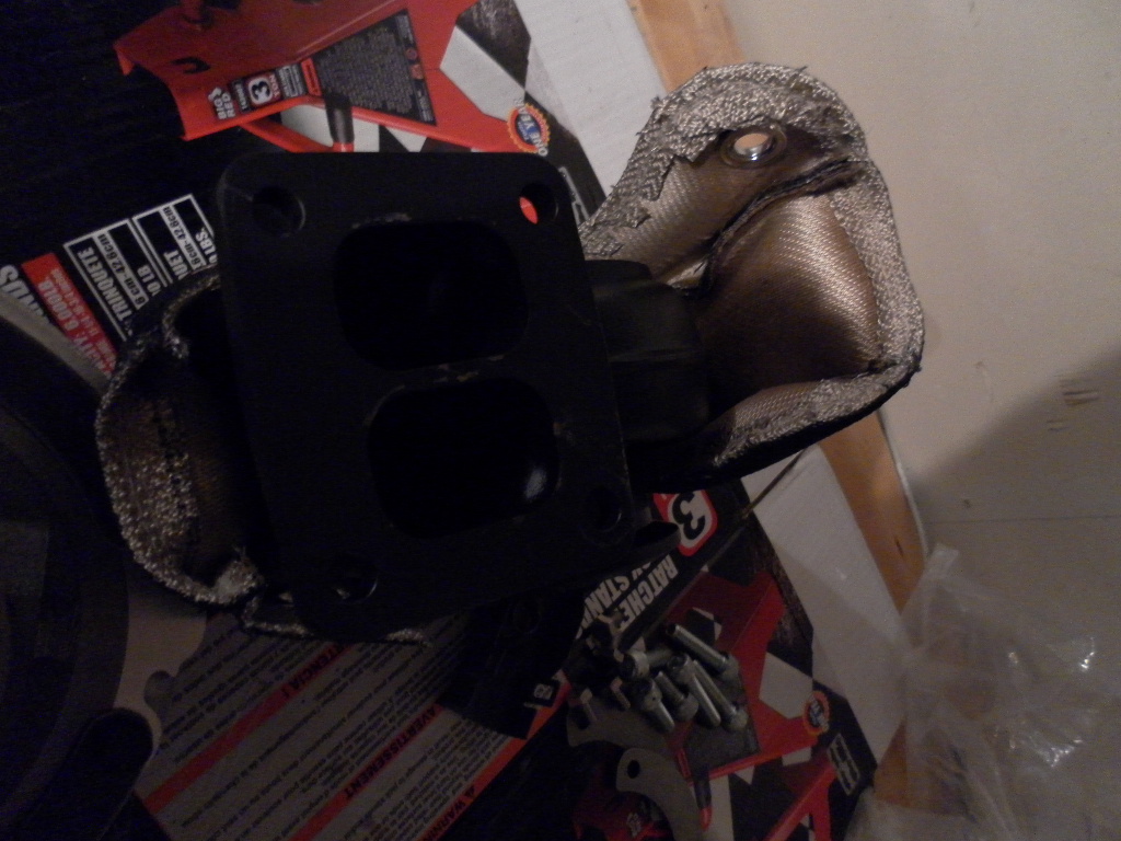

Also pics of the sweet turbo blanket :)

Also, did that turbo blanket come black, or did you paint it? Looks pretty good in black I must say!
Halon 05-12-2011 12:25 AM
Re: Project Lex
Yeah clutch job. Just throwing in a cheap 6-puck ebay disc using the stock PP to get me by this year.
And yeah the turbo blanket came black already. Does look nice. Wonder what it will look like after a season of abuse though...

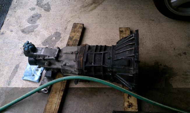

Re: Project Lex
1 Attachment(s)
Tranny is off Yaay.
