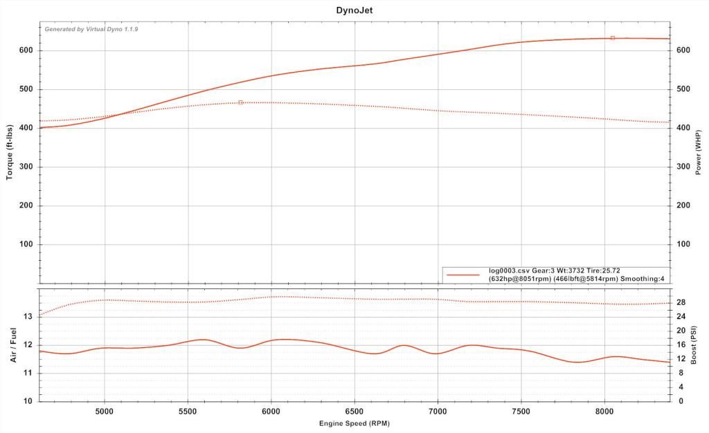

Few full logs...
http://i21.photobucket.com/albums/b2...ps8ab70512.jpg
Upping boost now.

Murlo26 09-22-2012 09:32 PM
Re: Dave's Evo X Build/The Life of Dave blog
Da fuck?
Apparently my car felt like starting to spool sooner...3800rpms?
http://i21.photobucket.com/albums/b2...pse5cbf60c.jpg
Jon, what are you doing to me?
