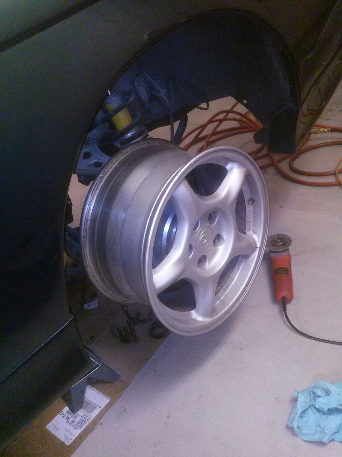

So in the mean time while I'm waiting for the new diff, decided to work on the rear brakes. The 16" FD rims I picked up as my poor mans drag setup didn't clear the calipers by a nut hair. So I ground a couple spots down on the calipers ever so slightly. Then primed and painted them to match the fronts I did a couple years ago. Here's how the sit now drying. Then they'll get the Supra stickers and some coats of clear, and then back on the car!

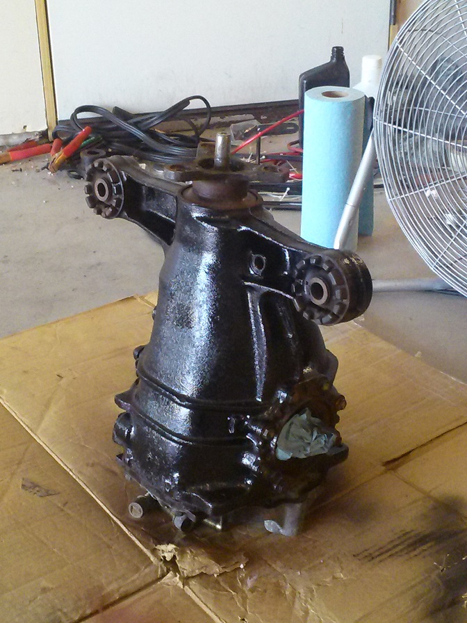

The new diff showed up. I slapped a coat of primer then a coat of black on it to clean it up. Will try to get it mounted up in there over the next couple days.

Most likely the carrier bearing or pinion bearing are going bad. With that much shavings, I'd say the bearings are worn out causing that noise.

So, all that work on the rear calipers was for not. Lesson of the weekend, don't grind calipers down no matter how many people on the internet say they've done it and it's OK, they now leak and are trash :(
So I'm just going back to my original plan which was to ditch them for some Supra NA rear brakes. SC300 are the smallest, Supra NA are bigger, and TT bigger yet + 2 piston. So while I suppose this is a downgrade from what I had, it's still an upgrade over stock.

The TT ones do not clear 16" wheels. So anyone who wants to run smaller than 17" rims, say for a track setup, either have to run the NA brakes or shave down the TT's a little to clear. Apparently others have shaved them to clear the FD wheels before, but apparently I shaved a little too much. So NA brakes it is.

Well with the new differential installed, the noise is gone! I had the other differential looked at by MAP, nothing really stood out as being that bad however he did find that the backlash was out of spec by about double. He was able to bring it back within spec. So hopefully at some point here I'll be able to find time to swap it back in to see if that fixed the noise, not sure when that will be though. Until then, I'll just enjoy it with this diff installed for now.

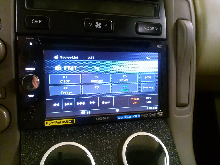

First, I feel like the sound quality coming from the China head unit left a bit to be desired. The aux input plug was becoming intermittent, and the bluetooth streaming was just horrendous, it's like it only streamed treble. So, I picked up a new Sony unit off Amazon for $150. It doesn't have GPS but I never really used that anyway, just use my phone. It does do DVD though, has aux in, USB in, and bluetooth which included a mic. So that is installed, and man everything sounds so much better. So if anyone wants a china unit, I have one up for bid lol.

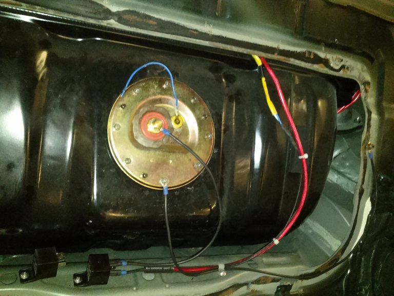

Also, I had my twin 255's installed but still on stock wiring. So I picked up some relays and did a rewire. I bought a bulkhead stud connector off Summit that seems to work good for passing the power through the tank lid rather than connecting it back to the stock small wiring for passing through that which seems kind of like a waste to go through all that just to have it connect back down to a tiny wire at the end. Can immediately tell they are louder than they used to be. I mounted both relays so I'd have an installed spare in case the one dies. I've never had one die on me before but I've read several stories of relay failures so I figured for how cheap they are why not have one in there ready to rock just in case.
