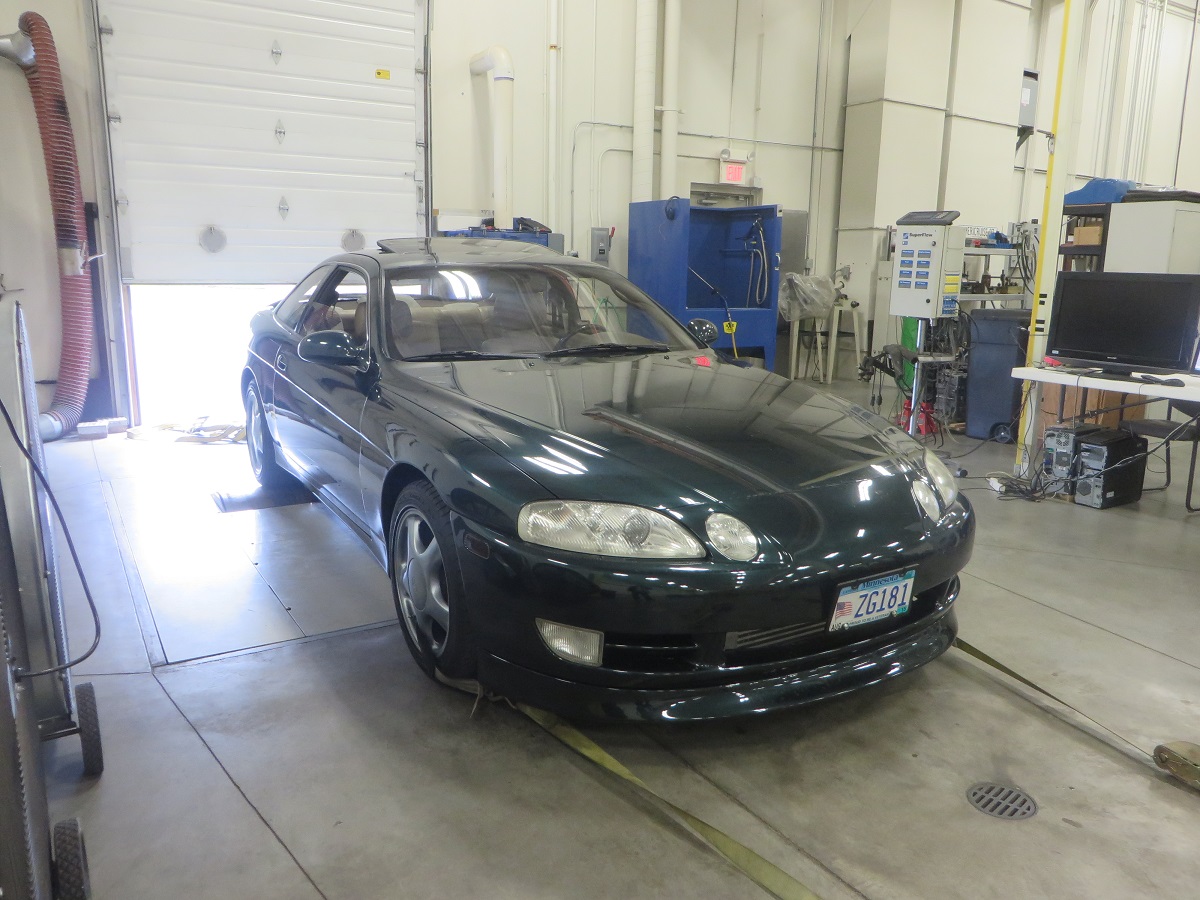

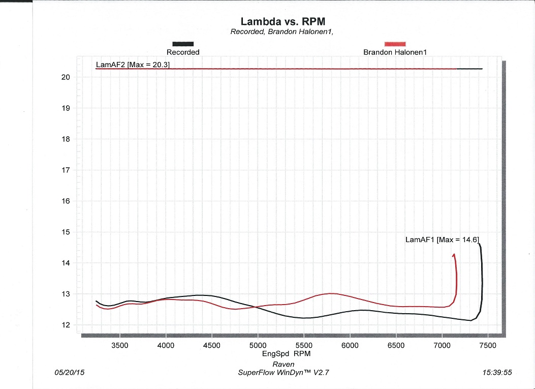

4 Attachment(s)
RavenWorks dyno session today went extremely well with Bob. 1st pull was on WG only boost (10psi creeping to 13psi). Pull was smooth, zero issues, and made 450hp/380tq. Over the course of the next 2hrs or so, we had it up to 20psi. We were trying to keep it at a decent yet conservative boost level, and same conservative mindset for the tune, don't shoot for the moon. Ended up at 545hp/462tq @ 20psi (falling to 17psi by redline). Full boost around 4300rpm, rev'd it out to 7600rpm (again, conservative redline). These are heart breaker SuperFlow numbers (probably closer to 575 on a DynoJet). Also the WB reading were off by about .5-.6, we were actually right around 12.1. Extremely happy with the results. Car never skipped a beat the entire time, ran absolutely flawlessly. That's plenty for me to have fun with this season, so just leaving it at that. Next year if everything holds together, I'll go for more.
Huge thanks to Bob, he did a great job and was a pleasure dealing with him. Also props to Shane as he had the idle/drivability already dialed in so well we didn't touch it. Shane couldn't do WOT tunes because of issues, so that was the goal of this session. Lucky to have such great resources locally! Also might I add, the RavenWorks facility was in a class of its own, so clean and so much impressive machinery.

Curious why the boost falls to 17psi. Surely your turbo can provide more airflow than that. Is the boost controller set to 17 and spikes to 20psi maybe? If it held 20psi I think it would be in the upper 500s for peak power.
That could be, but who knows. I'm sure the fact that I just have a 10lb WG spring doesn't help. Later tonight I can post a snap shot of the log that shows the boost level. Once I want to turn it up more, I'll be adding more springs to the WG which I'm hoping will help keep the boost curve flatter. I have an 11psi and 5psi spring, that can all be added since they are different physical sizes. So if I have all 3 in there, I should be at about 26psi on WG alone, no MBC.

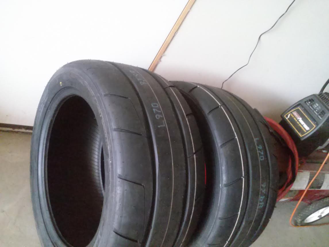

1 Attachment(s)
Need to get these babies mounted asap!

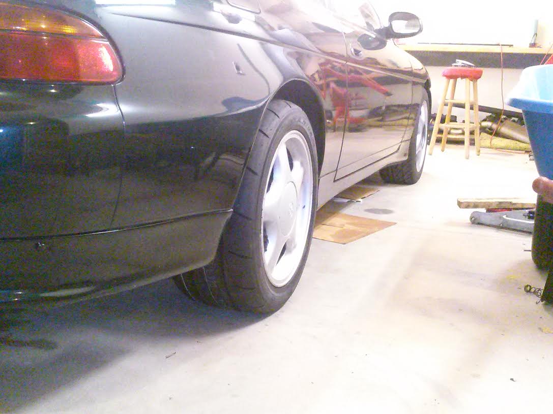

1 Attachment(s)
And on. Mounting the tires fucked up the plastidip on the wheel, so I just peeled it all off. Peeled off pretty easy. I hated the way it turned out anyway so no big deal. But kinda sucks if I want to dip them again a different color, seems like every time I swap on tires I'd have to re-dip them.
