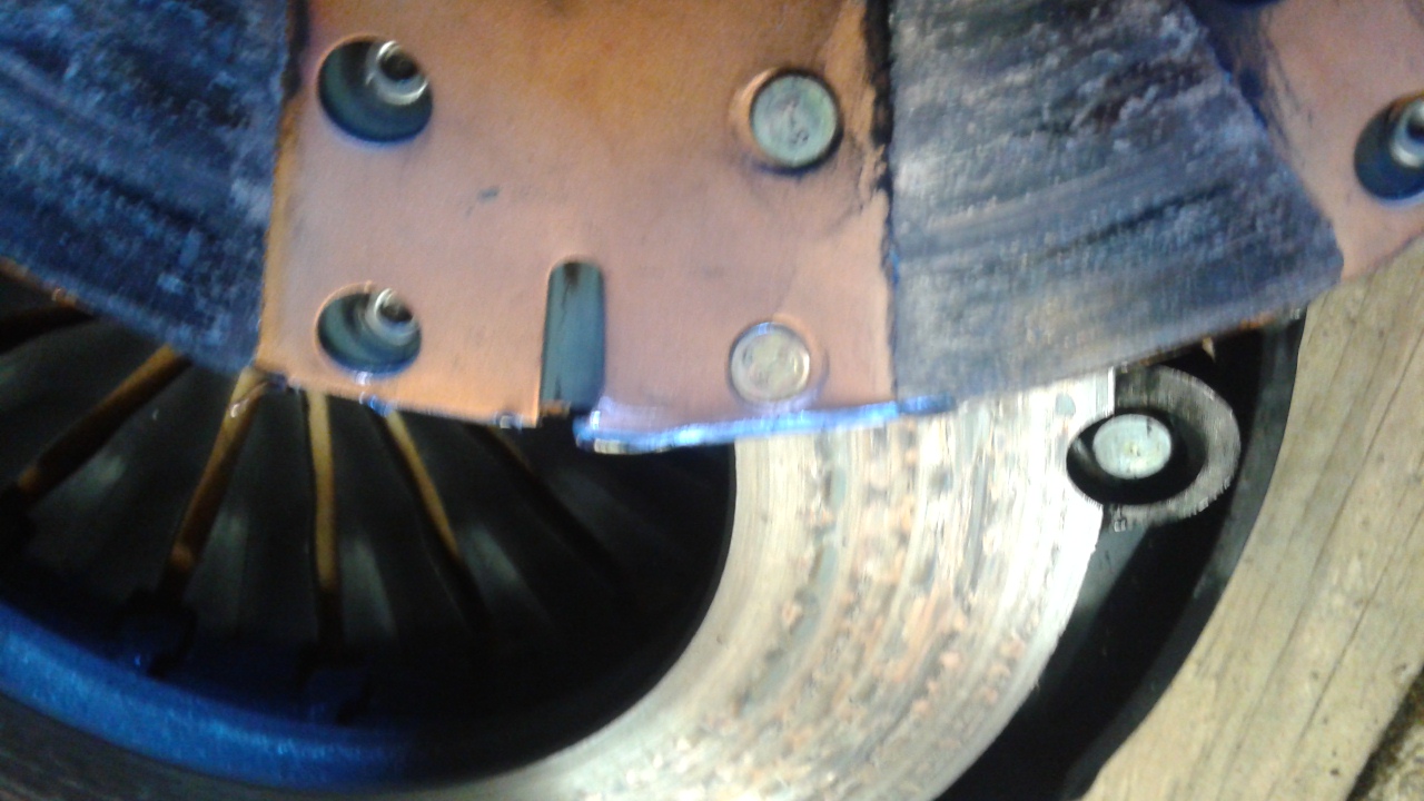

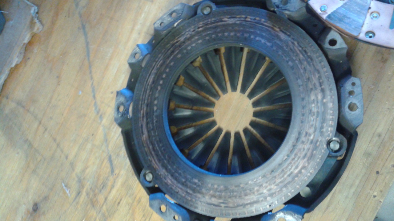

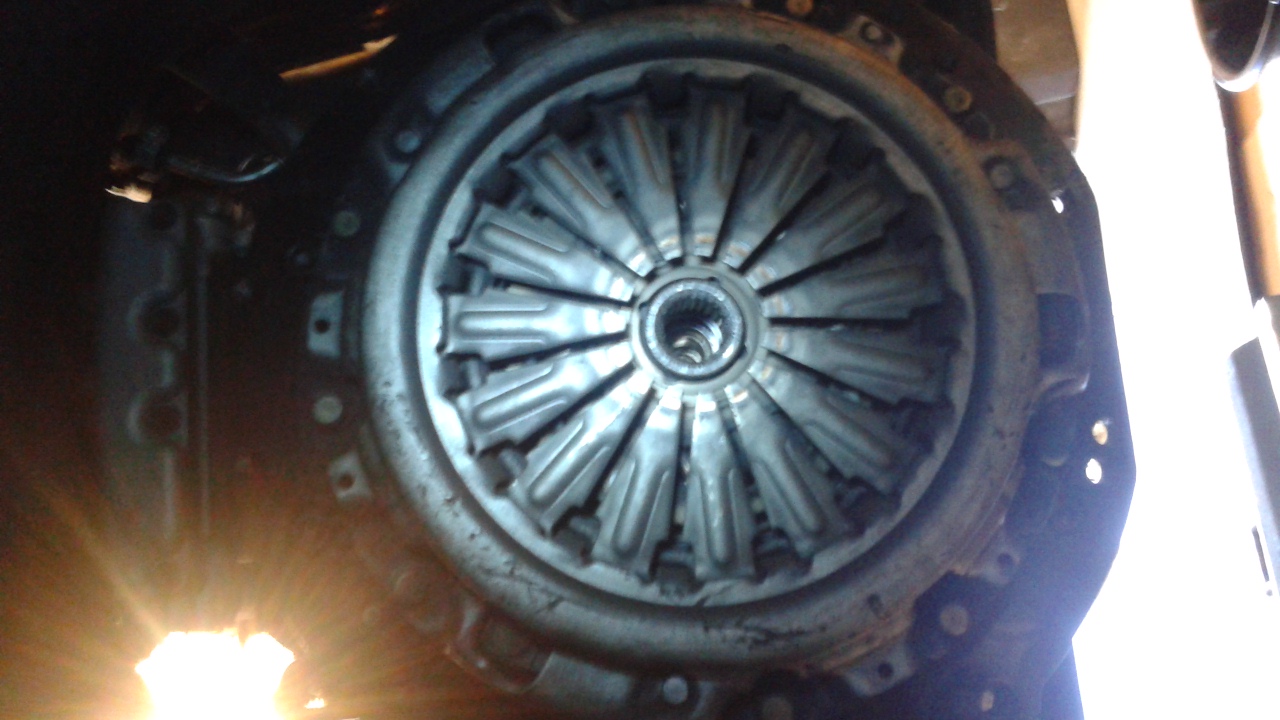

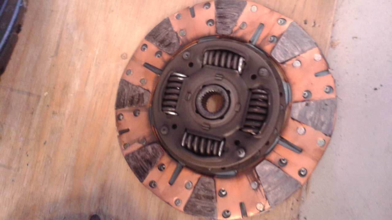

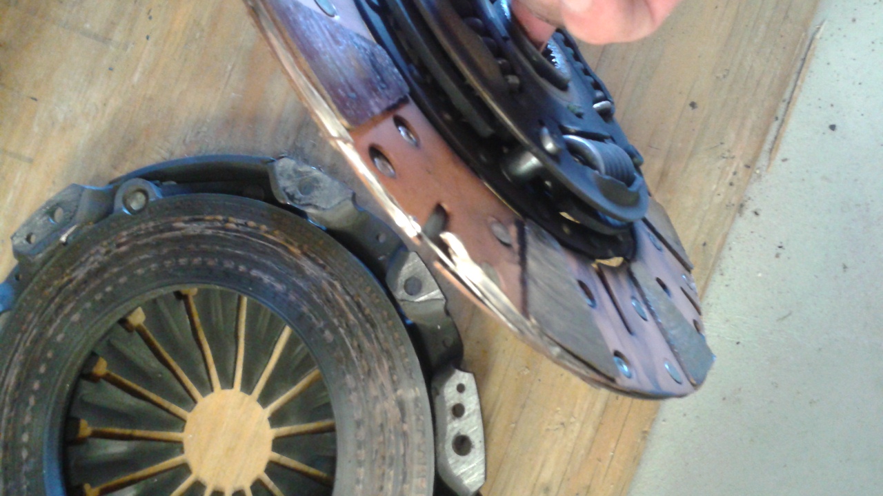

Got the trans out. Took a total of probably 5hrs over the course of 3 days. The FFIM that I had put on made it a bitch because it hit the brake boost when I was trying to tilt the engine back to get at the last too bolts. So that delayed me a bit. That manifold is too f-ing big. I am going to look for something else, I really hate it and I don't want to put it back on. But none the less it's out.
The clutch disc looks like shit. Nothing was welded together, but it was stuck to the pressure plate where the center piece was falling apart and wrapping around the pressure plate clamping surface. Maybe that's what was causing the issue? But truthfully not the smoking gun I thought I was going to find.
Anyway, gotta wait for the Collins kit to arrive. In the mean time I'm sourcing a new clutch setup and also a new intake manifold setup. I did get the new slave in for the new adapter, holy fook it's beefy!

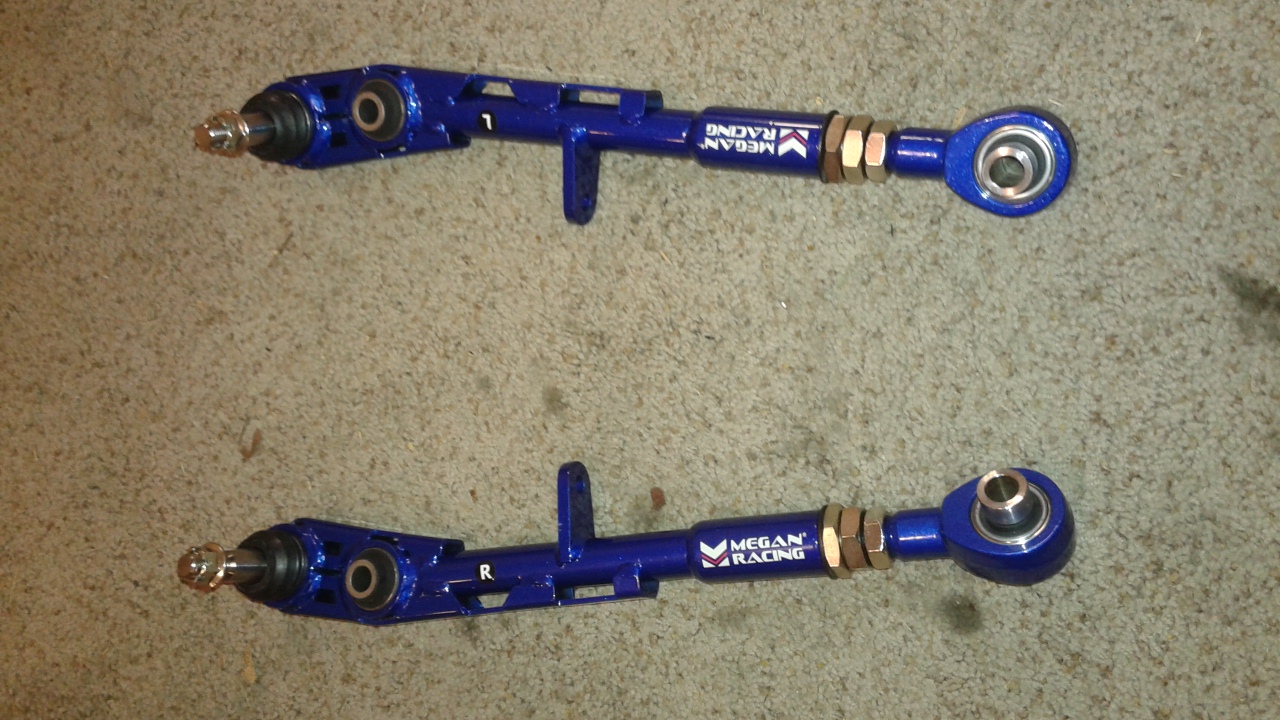

Also got my Megan rear lower control arms in. That should help me deal with camber and hopefully get a better footprint to help with traction.
That's all for now, here's some pics!

Speedfreak 03-28-2016 10:42 PM
Re: Project Lex
I don't remember what exactly your clutch problems were, but that disc is fubar'd. And like the issue. Cant tell from the pics, is it warped at all?

Halon 03-28-2016 10:49 PM
Re: Project Lex
Momin, the problem is basically the clutch wouldn't disengage anymore. You pressed the clutch pedal, it felt normal, but it just didn't actually disengage. So like if you had the car off, put it in 1st gear, pressed the clutch and started the car, it would lurch forward as you're cranking it because it's not disengaged. Maybe you're right though, it does seem a bit warped so maybe that was wedging it in there just enough that it wouldn't disengage.

asshanson 03-29-2016 03:36 AM
Re: Project Lex
It's hard to tell from pics, but is the disc edge totally fubar'd? If so, that's fubar.

Halon 03-29-2016 07:11 AM
Re: Project Lex
It's a JWT clutch for a 350z.
Yeah the edges are nasty, what even would cause something like that?
tehehodi 03-29-2016 08:12 AM
Re: Project Lex
Was the inspection plate on? Maybe something fell in there?. Some rivets pop off?

tehehodi 03-29-2016 09:34 AM
Re: Project Lex
Is the pilot bearing still okay? Maybe something got jarred to cause the outer ring of the disc to catch something. Probably excessive heat or something and warped the whole thing.
Halon 03-29-2016 09:40 AM
Re: Project Lex
Yeah I'm not really sure. You can see what I can see, I don't really know anything more than that. I think excessive heat is a likely contributor, especially considering it finally let go at the track after launching which involved a little bit of slipping / dumping the clutch.
Speedfreak 03-29-2016 01:48 PM
Re: Project Lex
I can stop by as well. Can help with the hood, and would like to see the disc and pressure plate. I'm guessing the distortion of the disc (and friction discs on the disc) is likely the issue. It doesn't take much variance in thickness(including overall "thickness" caused by warping..) of the disc or cut of a flywheel for a setup to hangup or not fully disengage.
The heat spots on the pressure plate indicates this thing isn't disengaging, combined with your last day at the track..

b00sted_spyder 03-29-2016 08:45 PM
Re: Project Lex
Put the clutch disk on the pressure plate. It should lay nice and flat when your press one side to the other side. How is the input shaft on the transmission? Can you see what else rubbed on the clutch disk?

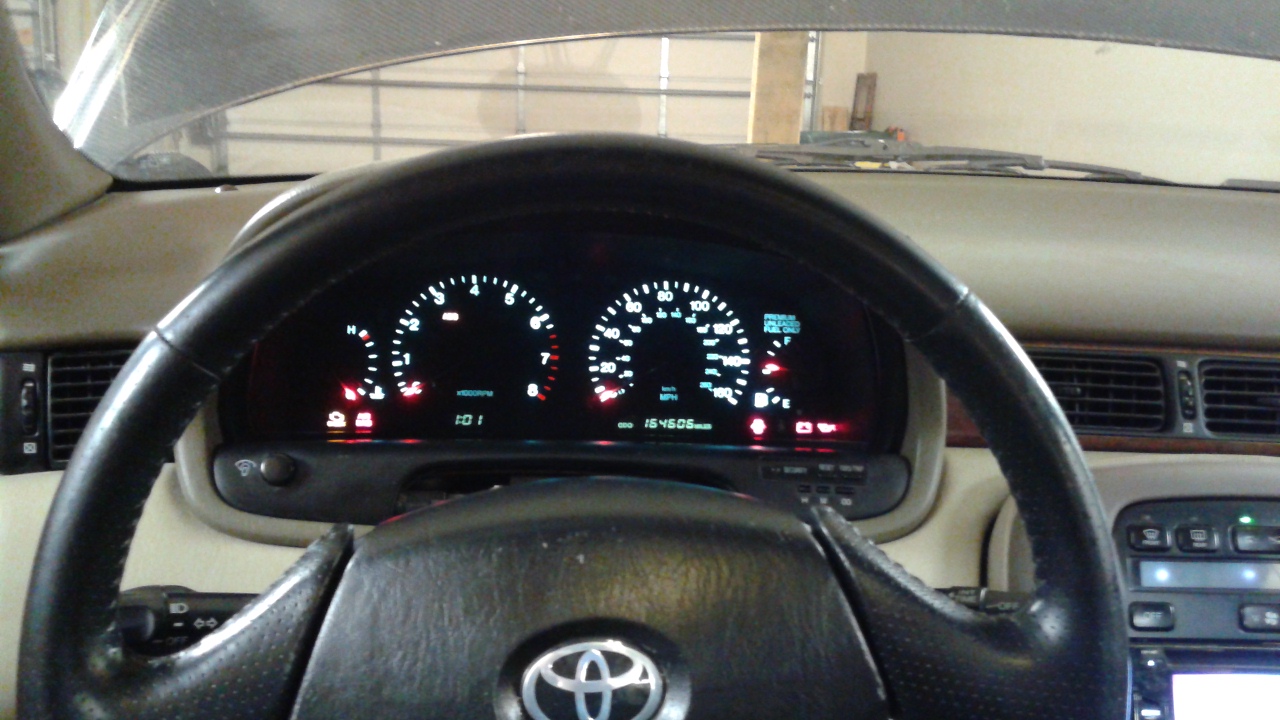

Some minor updates. Got my gauge cluster back from Tanin. Looks phenominal. So good I removed the climate control and will be sending that to them as well so they can update it to match.

Looks good! What did they do to the gauge cluster though?
Halon 04-04-2016 10:19 AM
Re: Project Lex
The back lighting is all white LED now, compared to 90's style yellowish-greenish-white back lighting. If you look at the odometer, they didn't touch that, so good comparison of seeing the old color to the new color. Just makes it look a lot more modern if you see it in person.
And 2 of the needles were completely burnt out (gas and temp needles), and the tach needle was starting to show signs of dying as well. The cluster is basically pitch black, so you need it to be lit up, even in the day time, to see anything. So those needles being burnt out were kind of annoying. Each of those needles has something like 10 LED's in them, so it's actually pretty expensive to fix. So what they offer is just their "fire tip" option. So instead of paying for 10 LED's in a needle, they just install 1 LED at the tip, so just the tip is lit. So they did that to all the needles with red LED's.
And they let you custom pick whatever color LED you want. I just went with white and red as I thought it was a simple and clean look.

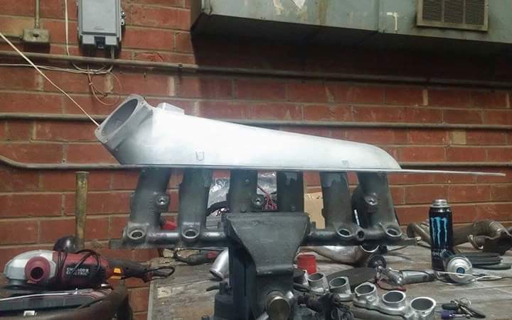

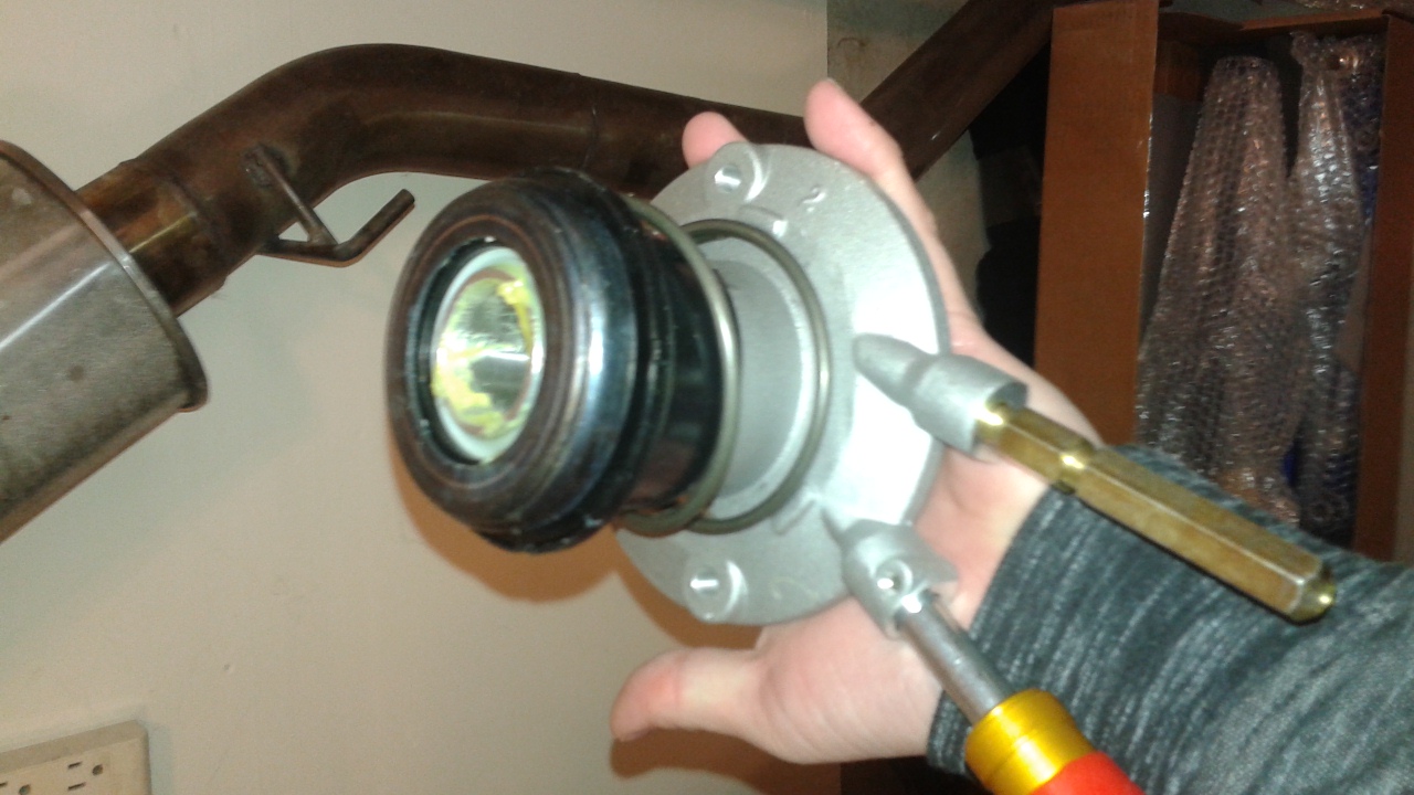

Been awhile since I've updated this. Not a ton to update. But I ordered the Collins new A340 CD009 adapter kit. I'll be running his custom flywheels with a single disc clutch which should hold my power goals. Just waiting on that to arrive and I can start getting the trans back in.
Waiting on the new intake manifold to arrive as well. Once it arrives, I'm going to be taking it, and a bunch of other bits, in to get powder coated.
I got my spare set of 92 style valve covers here. I did Ali's mod where I have two large breathers on top now (1/2 NPT to 5/8" Barb). I will be sending in these covers to get powder coated.
