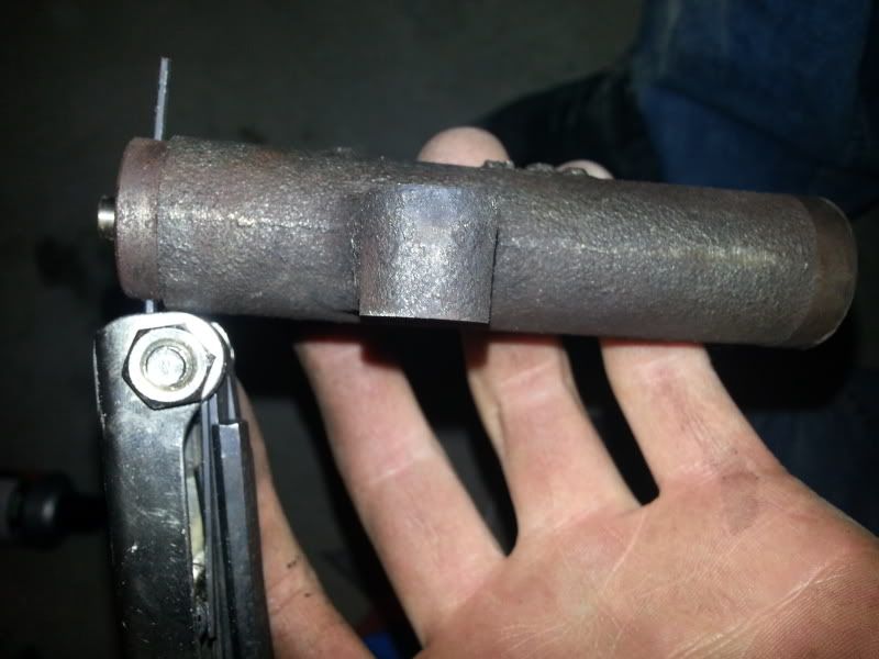

gotta put the tensioner in a vice and slowly squeeze it in is much easier if you do it slow
99gsxjoel 03-26-2013 01:10 AM
Re: joel's build
Hahaha thats the other issue. No table vice.
golden763 03-26-2013 01:11 AM
Re: joel's build
lol that could be an issue. Um can also use a big channel locks?? done that before
blackawdtsi 03-26-2013 01:26 AM
Re: joel's build
Actually, you HAVE to do it slow. If you go too fast, you'll rupture a seal.
What city are you in, Joel?
I've used a car and jack before... Not the best way but it gets the job done.

99gsxjoel 03-26-2013 01:51 AM
Re: joel's build
Thanks for the floor jack idea... lol

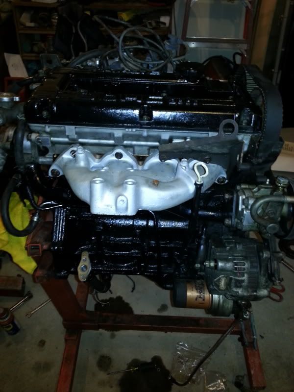

99gsxjoel 03-29-2013 06:09 AM
Re: joel's build
Everything is all assembled and ready to go back into the engine bay. Going to try and get most of it done tomorrow. And have it running and driving sometime this weekend.

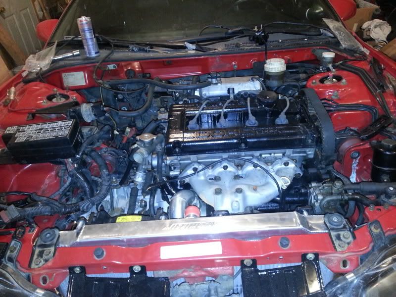

99gsxjoel 03-30-2013 03:02 AM
Re: joel's build
Big update tonight.
Installed the clutch and trans, and dropped it in the bay
Got all the wiring and vacuum lines hooked up. Starter and axles installed. It is getting close to being ready to start.
