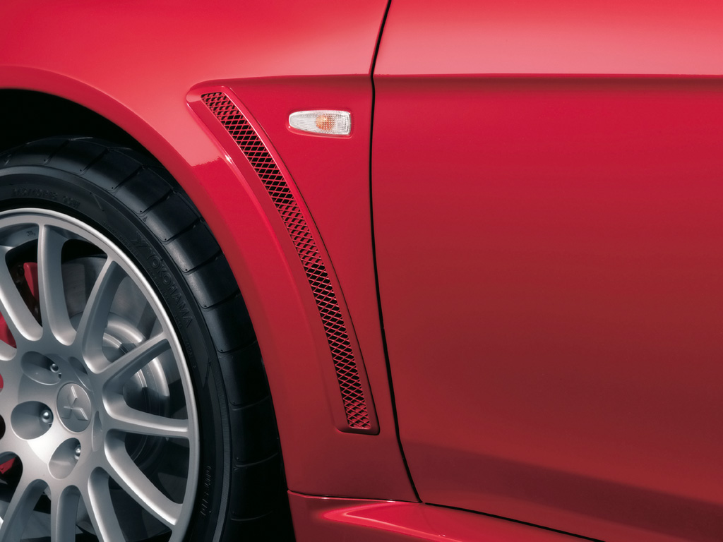

On your front fender behind your wheel... there is what appears to be a vent but is probably just aesthetics. Is that after market? Looks less like a plastic piece as your first picture illustrates and more like a paint job with a clear coat on the second picture..., looks good non the less.
Thanks for the comments. :)
That fender vent actually has some purpose although I'm not sure what it is exactly. The fender has 2 holes in it which the vent sits on. In the first picture, this is what the vent looks like except black in the GSR's cases (it's color matched on the MRs).
http://www.mitsustyle.com/forums/att...1&d=1298269865
The fender vents I have on the car are carbon fiber from Rexpeed and look like this:
http://farm5.static.flickr.com/4048/...8f38ff72_b.jpg

rexspeed CF fender vent is better than the stock non painted piece for sure too.

The vent install needs some more attention imo. Good look on parts and drop btw.
