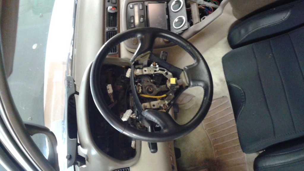

Well while I'm waiting on my new slave to arrive, I decided to do a couple things.
A took out my gauge cluster and sent to Tanin Auto Electornix to get the bulb changed over to LED and to fix all my burnt out needles.
I also took the opportunity to swap in my new steering wheel I picked up. First time ever removing / installing a steering wheel, wasn't too bad, took me maybe 15 minutes. Really digging the new one! It's out of a Lexus GS300, but from JDM land so it would have been a Toyota something or another (Aristo maybe?), sorry I'm not caught up on my JDM models, haha.

More modern, nice! It looks a bit smaller diameter, any issues seeing the edges of the gauges after that? Smaller wheels are nice.
Assuming those are cruise controls on the wheel, hopefully you were able to keep that functionality (plus the airbag maybe)?
Halon 03-21-2016 10:00 PM
Re: Project Lex
It's actually damn near identical in size. I put it on top of the old one and it was pretty much the same size. And the gauges are gone so no idea, lol. But yeah same size so shouldn't be an issue!
The air bag I removed, it's just a hollow cover at this point (puts on flame suit).
The cruise switches don't work since I removed cruise from the car. But I left them on there just in case I need a switch on the steering wheel for something, I could use it. Say to enable rolling anti-lag or something like that.
