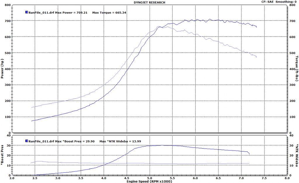

Well might as well update this with my dyno graph. It's actually pretty similar to the graph I posted earlier of a 2JZ with the same turbo.
SC300 2JZGE NA-T
S300SX 84-75 (61mm) / 0.91AR T4TS
30psi tapering off by redline.
709hp / 665tq
http://www.mitsustyle.com/photopost/...m_1024x627.jpg

Nice.
