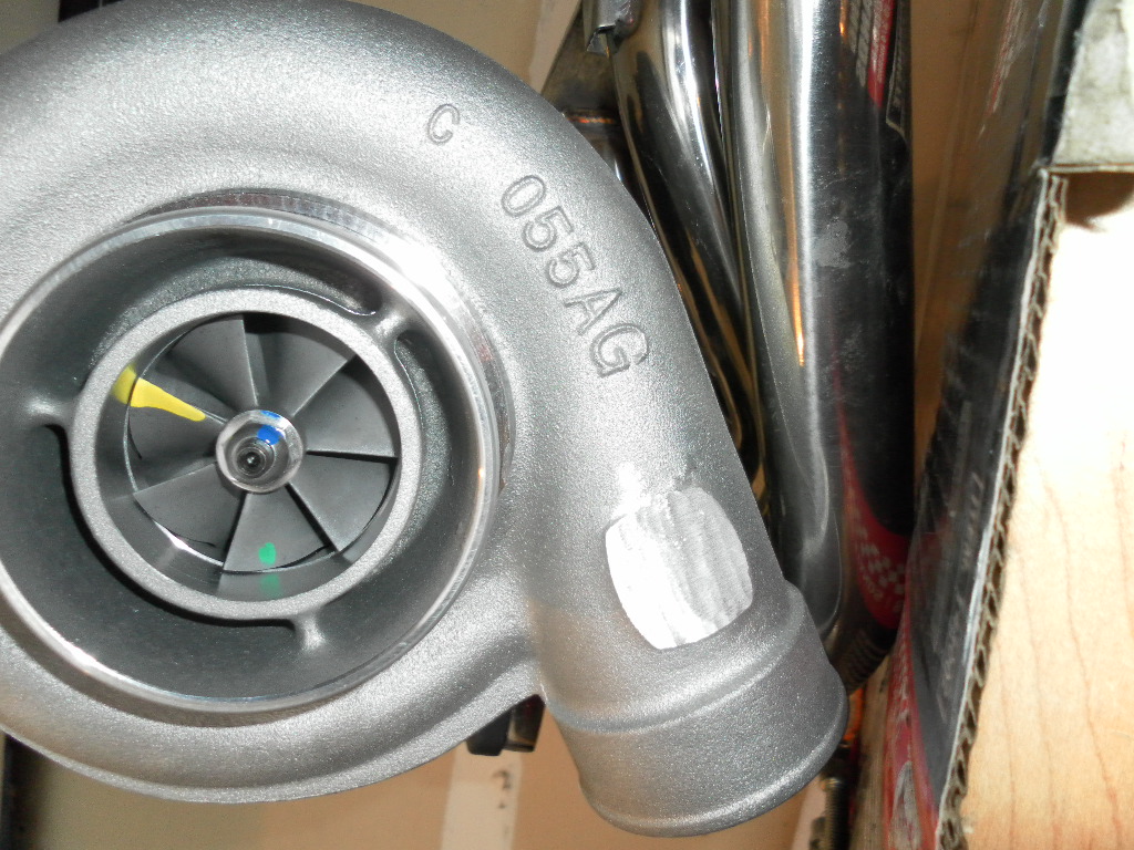

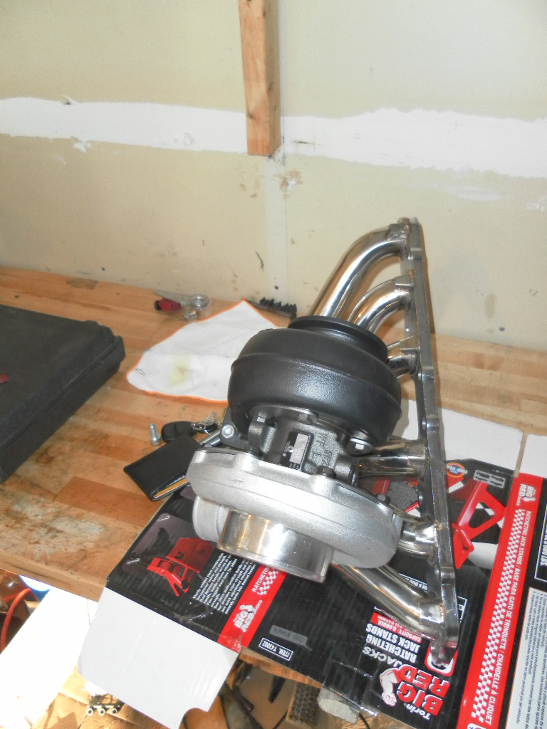

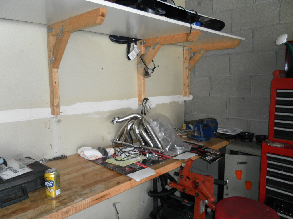

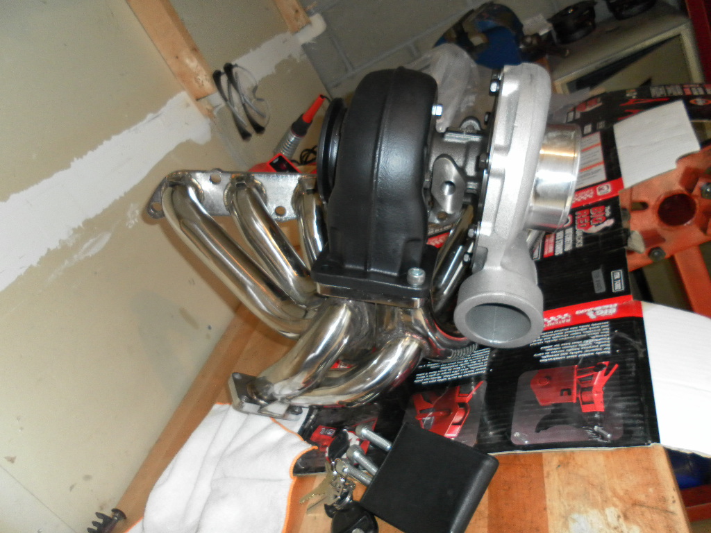

Well one last glitch I've been trying to work out is cranking. Sometimes it starts a little rough. While troubleshooting last night, the car just shut off and wouldn't restart. Narrowed it down to loss of spark.
Shane was nice enough to lend me the coil and ignitor off his SC300. Turns out my ignitor died. New one from a parts store is 300-400 bucks :( So looks like I'll be checking the local junk yards :D
Big thanks to Shane for lending me the stuff!
Also, it looks like DB's dyno schedule is a bit busy, so I may opt to not get it tuned before doing the turbo, since it does seem to be running fairly well overall as-is. Bolted the turbo up to the mani today just to see if there is any clearance issues with the compressor housing hitting the manifold. It clears like this, so this is prolly how it will end up being aimed. I also put one picture showing it clocked to the point that it hits the #1 runner.

95talonracer 03-30-2011 07:42 PM
Re: Project Lex
Looking sweet. Are you going to ceramic coat the mani? Or have the welds reinforced by someone at all? Polish the compressor cover? Turbo blanket? Since you have to take the cams out to put the new head studs in anyways, are you doing cams or just leaving stock ones? NOZZZ?

Halon 03-31-2011 10:32 AM
Re: Project Lex
Yeah I plan on having Primo coat the manifold black eventually. Have been waiting though until I figure out the wastegate situation. It's currently flanged for a ballin HKS wastegate which I more than likely won't be buying. So I was either going to chop it off and have a different flange welded on, or just make an adapter flange. If I end up chopping it, I want to wait until I do that before coating it.
The welds, I was planning on leaving it as-is. Might be a good idea to have a local shop look it over quick though just to see what they think. Compressor cover, I think I'll be leaving it as-is for now. But it'd be nice to get it polished in the future. Turbo blanket is definately something I've been considering. It's already coated from Primo, but having a blanket as well wouldn't hurt I'd think. And knowing me, I'll probably go find the cheapest one that can be over-nighted from Chiiiyynahh.
Cams, I'm staying stock for now. Reason being is I really like a nice idle now a days. So I want to change as little is possible. Once I get it running good turboed on stock cams, then I'll consider dropping in some better cams. I haven't even researched them yet so no clue what I'll get at this point.
And definately no Naaawwwsss :) I'm scared of that sh!t.
Originally Posted by awd-drifter (Post 378700)
snaps brandon! that a t88!! lolol. lookin' and soundin' good man.
Borg Warner baybay :D

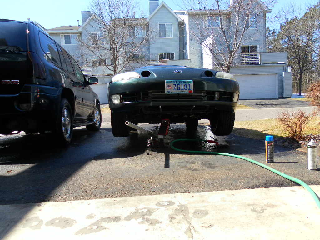

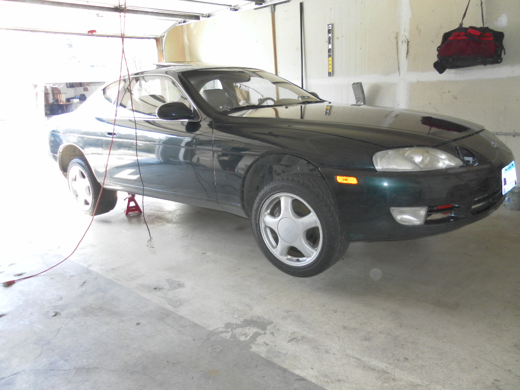

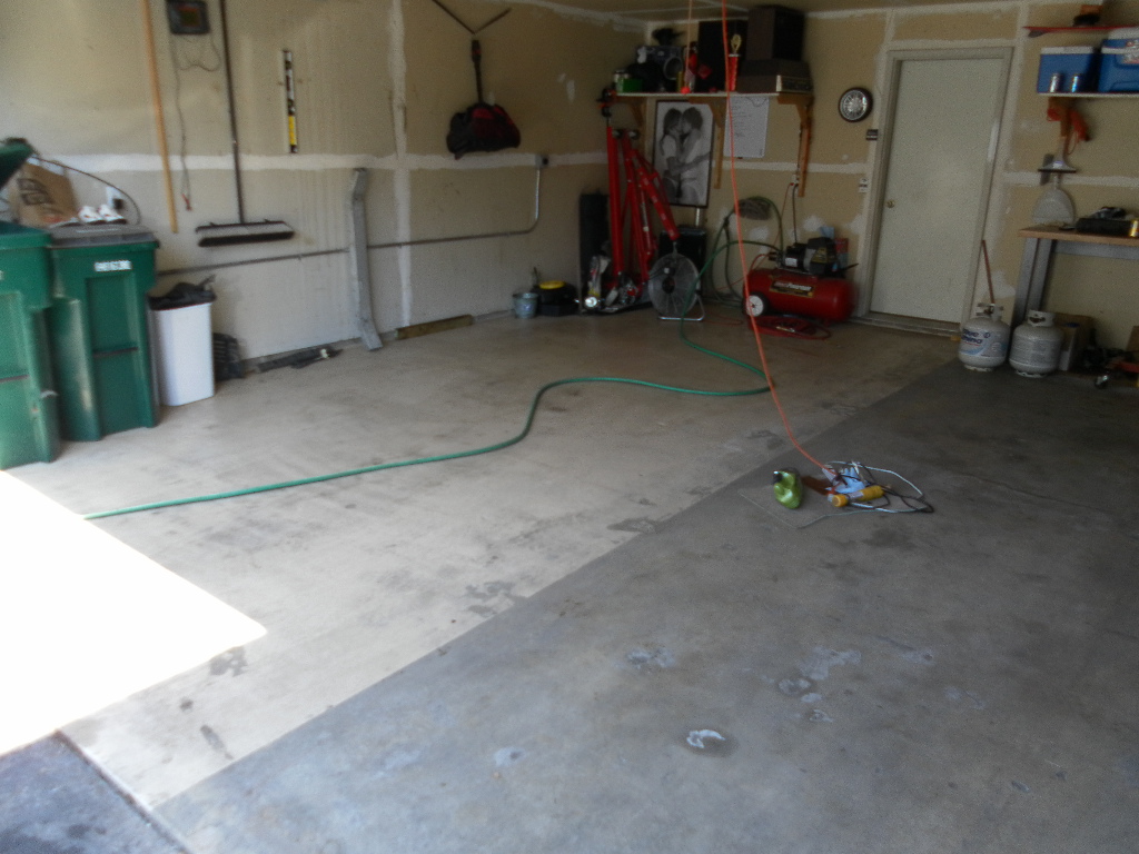

Well, the time has come... Turbo Time !!
I parked her in the driveway. Cleaned out the garage where she'll be parked for the next couple months. Jacked her up and gave her a good underbody cleaning/degreasing before starting work.
http://mitsustyle.com/forums/attachm...1&d=1301777105
Parked and up on jack stands

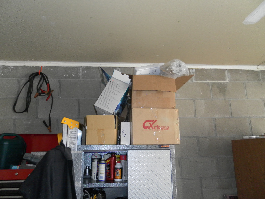

The parts stash that I've been slowly accumulating over the past few months. Finally get to put them to use :)

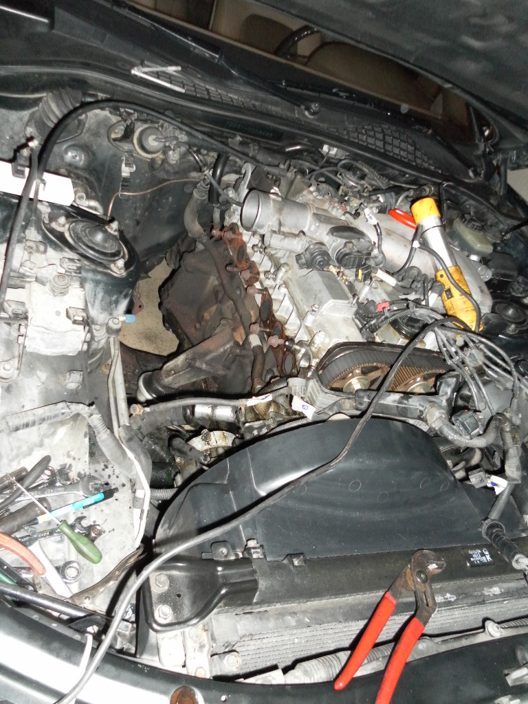

Re: Project Lex
8 Attachment(s)
Exhaust and Intake side are torn down as far as I think I'm going to go. There seem to be so many random sensors all over the place, I'm wondering if they are all needed at this point?
Pics of how it sits right now after tear down:

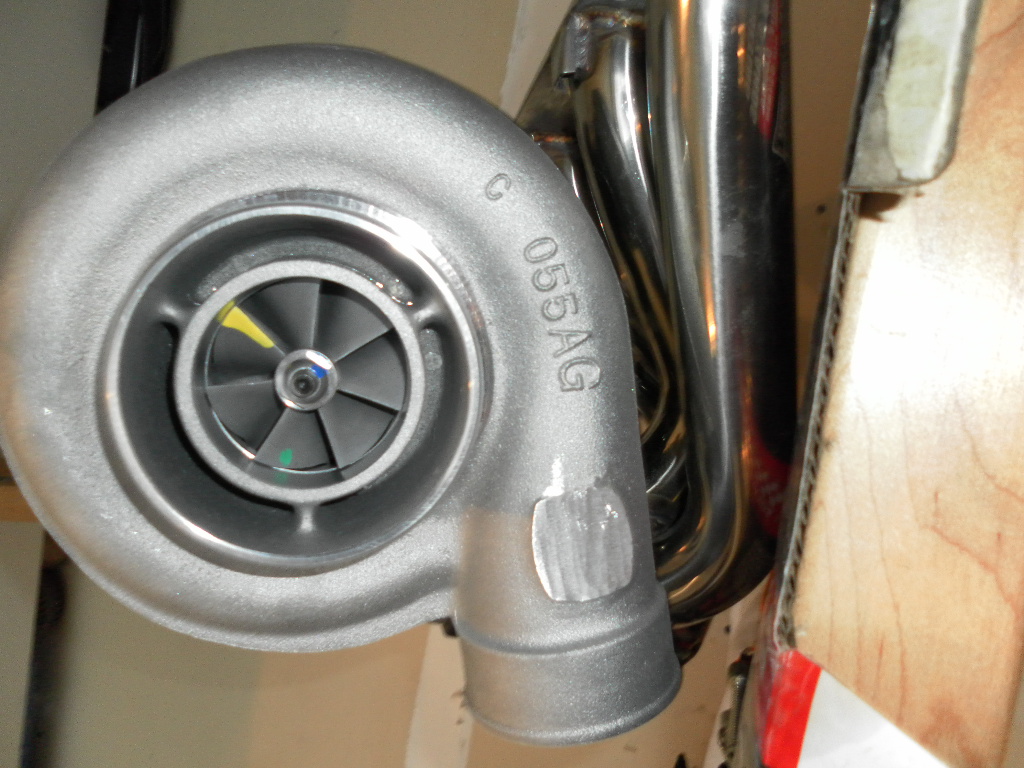

1 Attachment(s)
http://mitsustyle.com/forums/attachm...1&d=1301971251

Halon 04-05-2011 12:40 AM
Re: Project Lex
The Borg assimilates all, resistance is futile.

What are the specs on that turbo? Sorry if I missed it in the thread.

Re: Project Lex
S300SX 84-75
Compressor: 61.4mm inducer, 84mm exducer, has ETT, rated at 72lb/min
Turbine: 75mm inducer, 68mm exducer (new style)
.91 AR Divided T4 exhaust housing.
For those that mostly know the Bullseye numbering, it would be somewhat similar to an S362.
