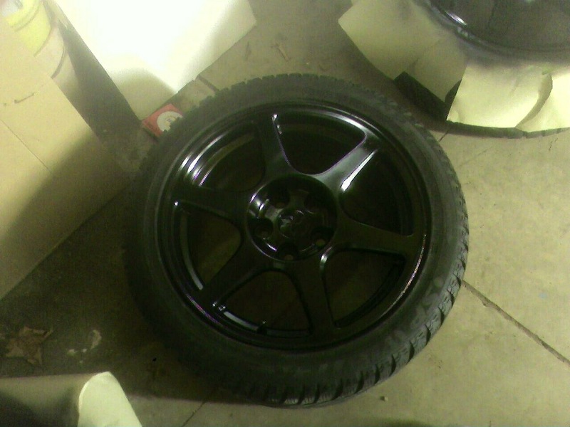

This is what I did this Sunday afternoon. They are still getting good and dry/hard so no on car pictures yet. Nothing to exciting but I have wanted these painted since I got them so I'm glad to get it done! excuse the crappy cell phone pics!
http://www.mitsustyle.com/forums/att...5&d=1226940402
http://www.mitsustyle.com/forums/att...6&d=1226940402

Re: My sunday afternoon activity
I used duplicolor 1634 high-temp/low-gloss engine paint on top of a layer of their self-etching primer. Before all that I wet sanded the wheels with 400 and then 1000 grit sandpaper. I also sanded lightly with 1000 grit after the second coat of primer and second coat of paint. In all there were three light shots of primer, four light shots of paint, and then two 'medium wet' shots of paint. The paint was all applied within an hour. Looks pretty good.
This is the basic pattern I've been using on the car; calipers, front bumper center, rear lower 1/4, etc. Been slowly getting rid of all the chrome on the car replacing it with low-gloss black.
If I can figure out how to open up the headlight capsules next spring, the headlights get this treatment internally. Otherwise I'm grabbing a cheap set of after-market projectors and play with them.

The red lip wheels are my summer wheels... the all black are just for winter!
I also used a High temp engine paint, semi gloss..
Rattlecan doesn't last long on wheels.
Swifty1638 11-18-2008 02:19 AM
Seems to work fine on mine! But i used duplicolo wheel paint. Been fine for over two summers now even with washing. It's all in the prep.
SnoEclipse 11-18-2008 02:33 AM
Lots and lots of prep. Cleaning & degreasing, wet sanding, drying, taping off, proper use of a good primer, proper use of a good paint. Lots of thin coats.
If you don't take most of a day to do 4 wheels, you're doing it too fast.
