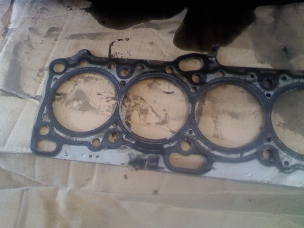

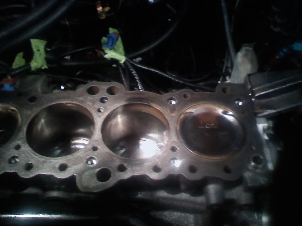

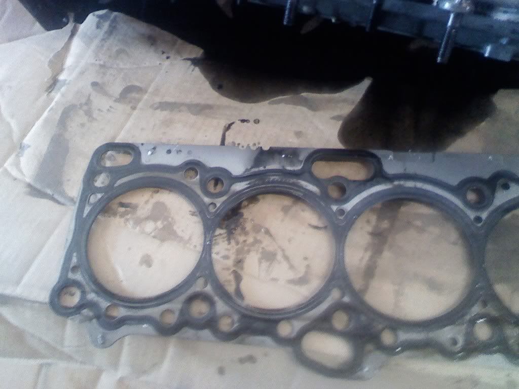

Fixed a loose wastegate, and an exhaust leak. Still there. Pulled head today:
Evidence of Cylinder number 2 leaking combustion gas on the firewall and radiator side.
Black coloring on cylinder head, top and bottom of HG, and block. That area the headgasket when layed in a free state is bulging and has debris inbetween the layers.
http://i1010.photobucket.com/albums/...0926001552.jpg
http://i1010.photobucket.com/albums/...926001553a.jpg
http://i1010.photobucket.com/albums/...0926001553.jpg
http://i1010.photobucket.com/albums/...0926001554.jpg
I have been reusing standard ARPs that I got 3+ years ago, and have been retorqued many times.
Any idea why this happened?
Kracka 09-26-2010 04:44 PM
Re: Found My WOT Exhaust Leak: Why?
This is your problem.

Swifty1638 09-26-2010 04:50 PM
some stretch more then others. There was a video on this, as well as testing arp's moly lube, the shit pro racer's use, and motor oil. How when we "torque" to 100 ft. lbs...it's not actually at 100, and such. You prolly just strained them all, and those for whatever reason have stretched and become weaker then the others.

Matt D. 09-26-2010 09:16 PM
I say OEM Mitsu headgasket, good new head studs and call it good.
Also, I'd take your head it and have it check for flatness, and possibly get a straight edge to check your block's flatness too.

sleepydsm 09-27-2010 08:16 AM
I know about the greatness of MLS gaskets. I have used the Mitsu MLS before. The perma-torque is great, I know.
I already checked the block for flatness, it appears to have a .002" variance which should be within spec.
