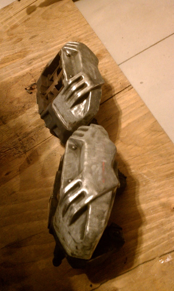

My front calipers were looking pretty rough. So decided to paint them. After reading around, asking around, I decided to just use regular rustoleum spray paint. Here's the before pic:
http://mitsustyle.com/forums/attachm...1&d=1346986129
For prep, I unloaded a can of brake cleaner on them to get them clean. Then took a wire wheel to them. Then sprayed more brake cleaner on them. Here's what they looked like all said and done:
http://mitsustyle.com/forums/attachm...2&d=1346986129

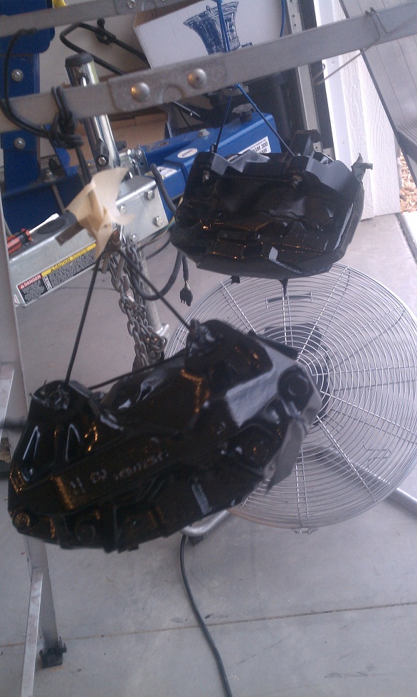

Then using tape, newspaper, whatever I could find, I masked off the areas I didn't want to get paint on. Then hung them so they were ready to paint
http://www.mitsustyle.com/photopost/...m/IMAG1664.jpg
Applied 3 coats of gloss black rustoleum, each coat within about an hour of each other.

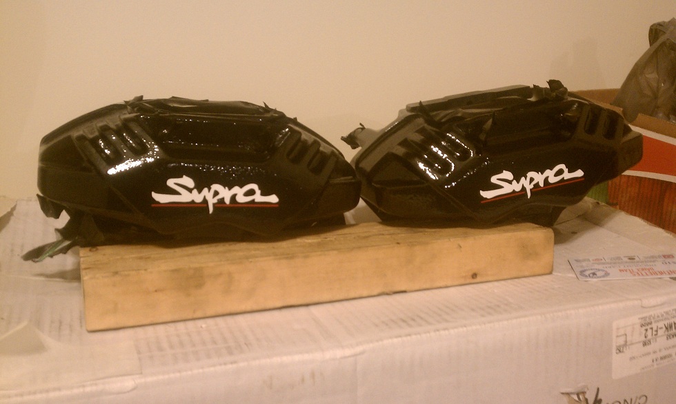

I let the last coat dry outside and with a fan on it for about 5 hours, then applied these decals I bought off ebay.
http://mitsustyle.com/forums/attachm...4&d=1346986143
http://mitsustyle.com/forums/attachm...5&d=1346986150
Last thing was I applied 5 very light coats of rustoleum clear over them. Let dry overnight, reinstalled, and that's it. Looks much better. Time will tell how they hold up I suppose.

Regular rustoleum paint? Not even high heat? With any high speed braking, calipers really heat up. Hopefully the paint doesnt start flaking since its not high heat.
When I did my DSM calipers red, I bead blasted them and then painted them with a caliper paint kit.

I've had good success using the various high heat caliper paints you can get at the parts store.

I used reg paint on the brembos and they are still holding up fine also.
