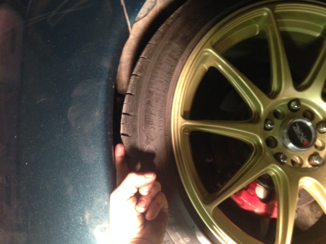

Very first thing i did was throw on my xxr 527 rims that i had in my closet for my esi. Then replace the grinding transmission. I was able to pick one up locally, along with a 2gb talon front bumper, and had enough money left over to install a ACT 2900 clutch along with a light weight 7-bolt fidanza flywheel.

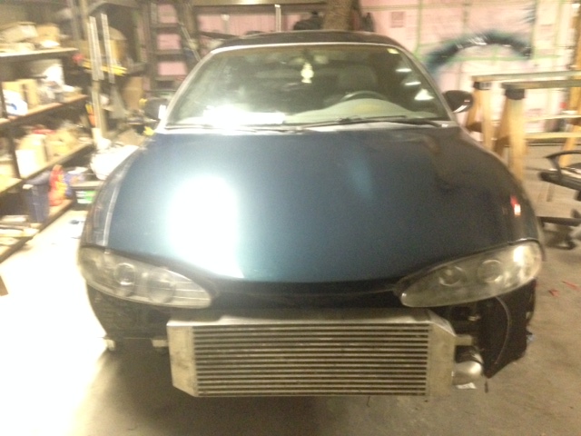

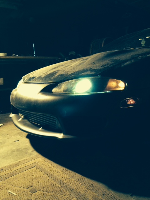

And this is what the car was sitting like when i was working on getting some 2ga's headlights and shaving the front bumper
Attachment 14804
Attachment 14808
Then i finally got some 2ga headlights with a HID kit i put in, looked good for now so i will keep it till i find a nice stock set. I also ended up plasti dipping the 2gb talon front bumper.

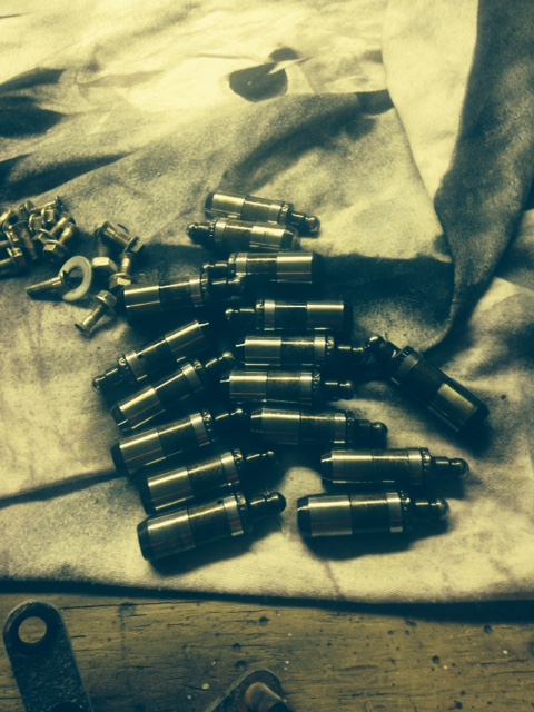

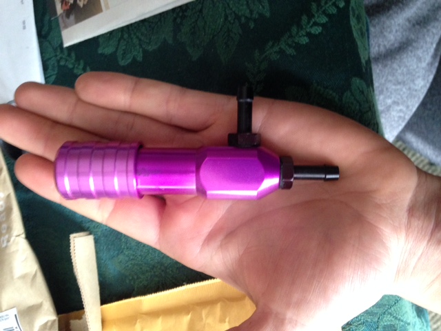

Next thing i did was install my Hallman MBC, Crower 272/272 cams, revised lifters.
Attachment 14810

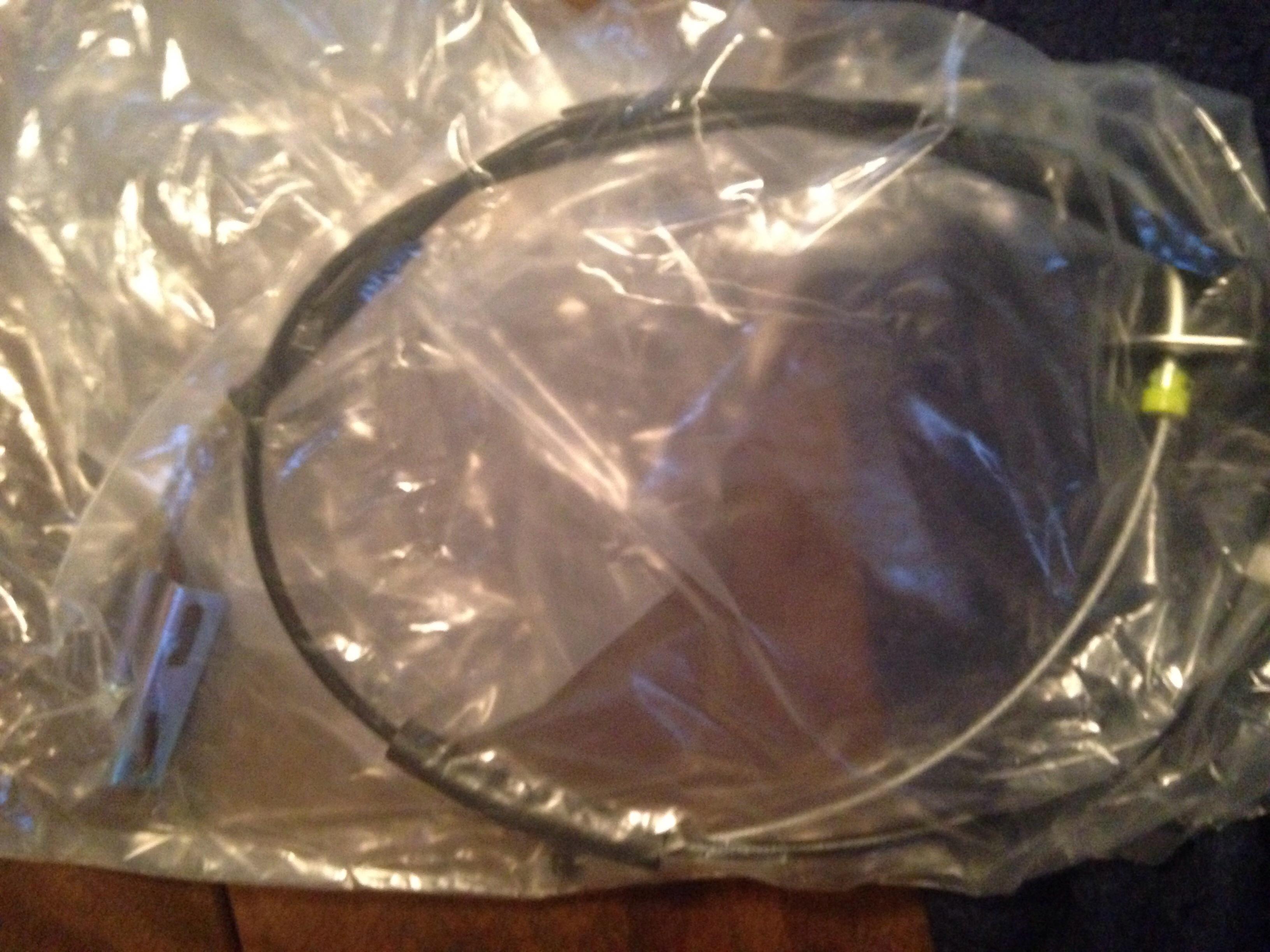

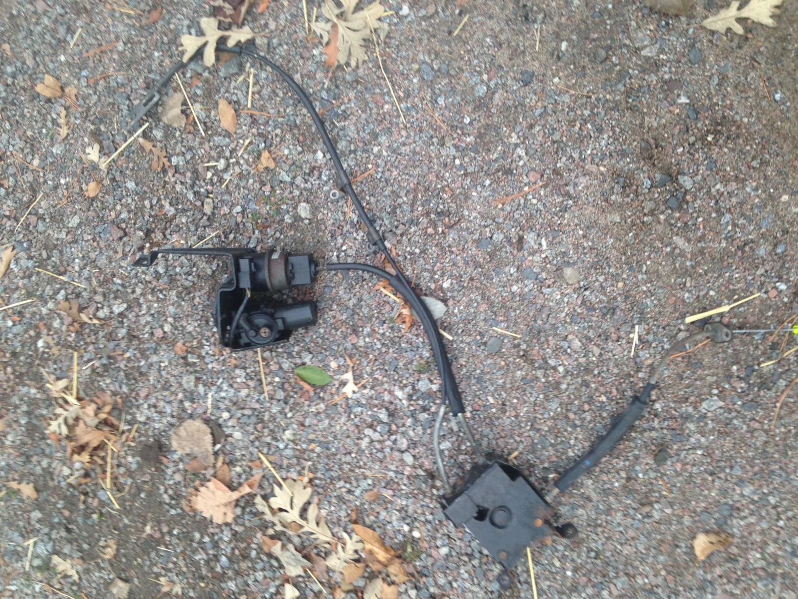

Got my 2g non cruise control cable today in the mail. That will be going on this weekend. Also looking at moving my fuse box down to the passenger wheel well this weekend.
Attachment 14814

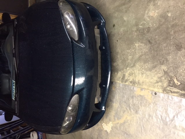

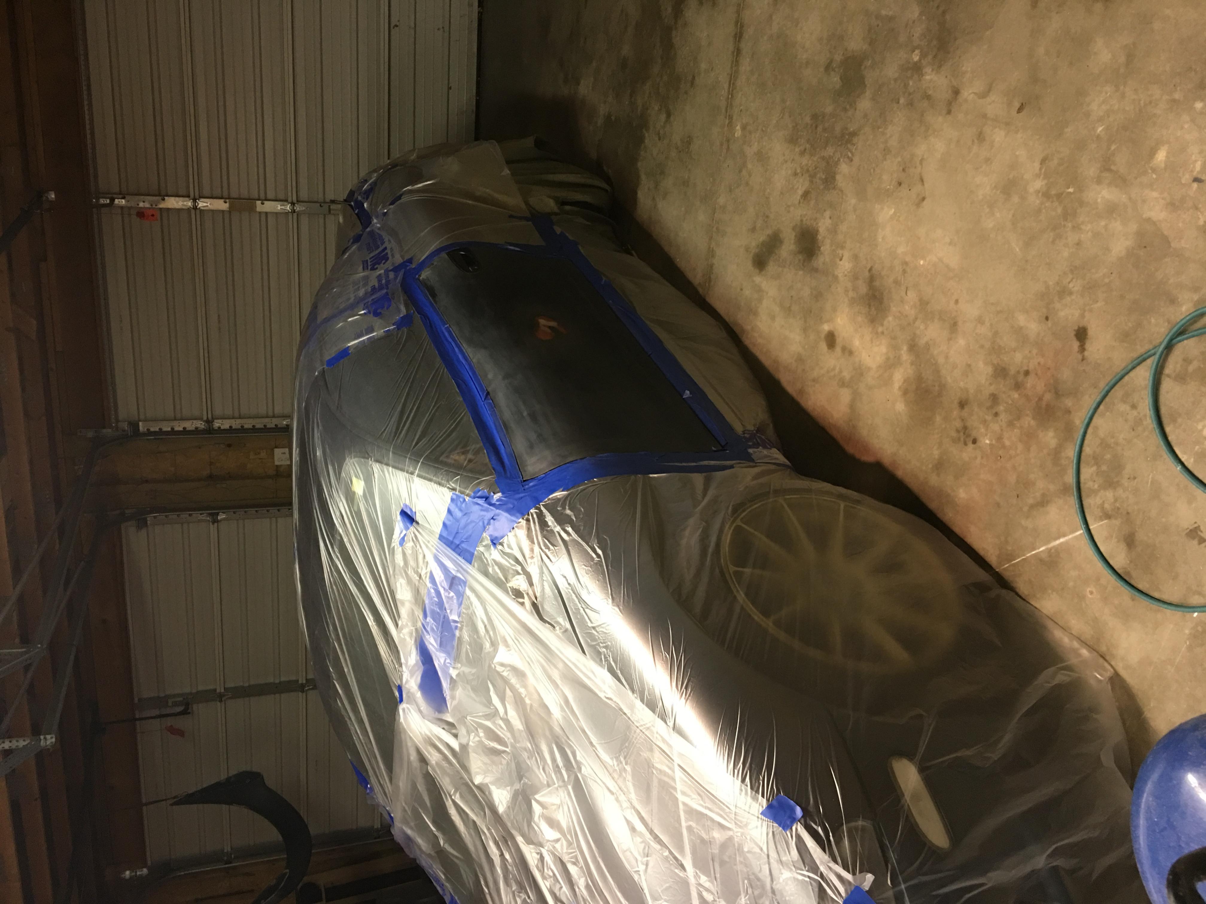

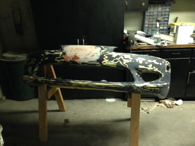

small update, I got the hood, fender and center tail light painted. This was my first time painting something and i think it turned out good for a garage paint job you can even see the flake. I also got my ride height finally set.
talonsway 12-02-2014 12:00 AM
Re: Ricks-TURBO TALON
3 Attachment(s)
heres what it looks like so far. still gotta do my talon 2gb bumper doesnt look too bad for my first time and in my garage.

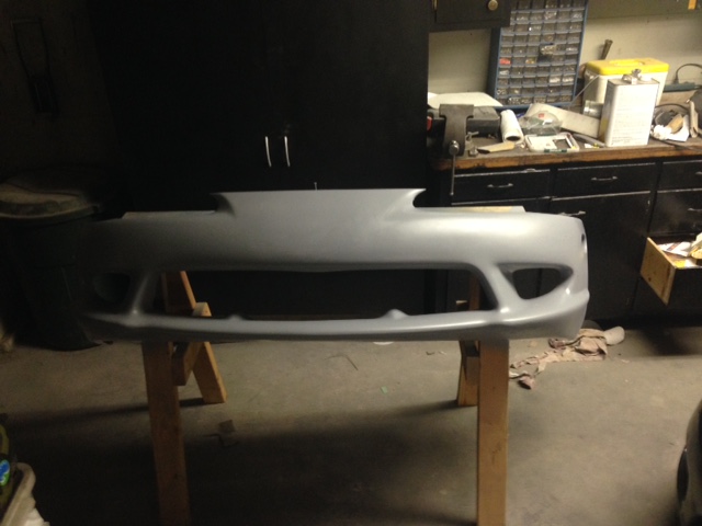

working on this front bumper, got that emblem finally shaved and is sitting with 2 coats of sealer on it.
Attachment 14867
Attachment 14868

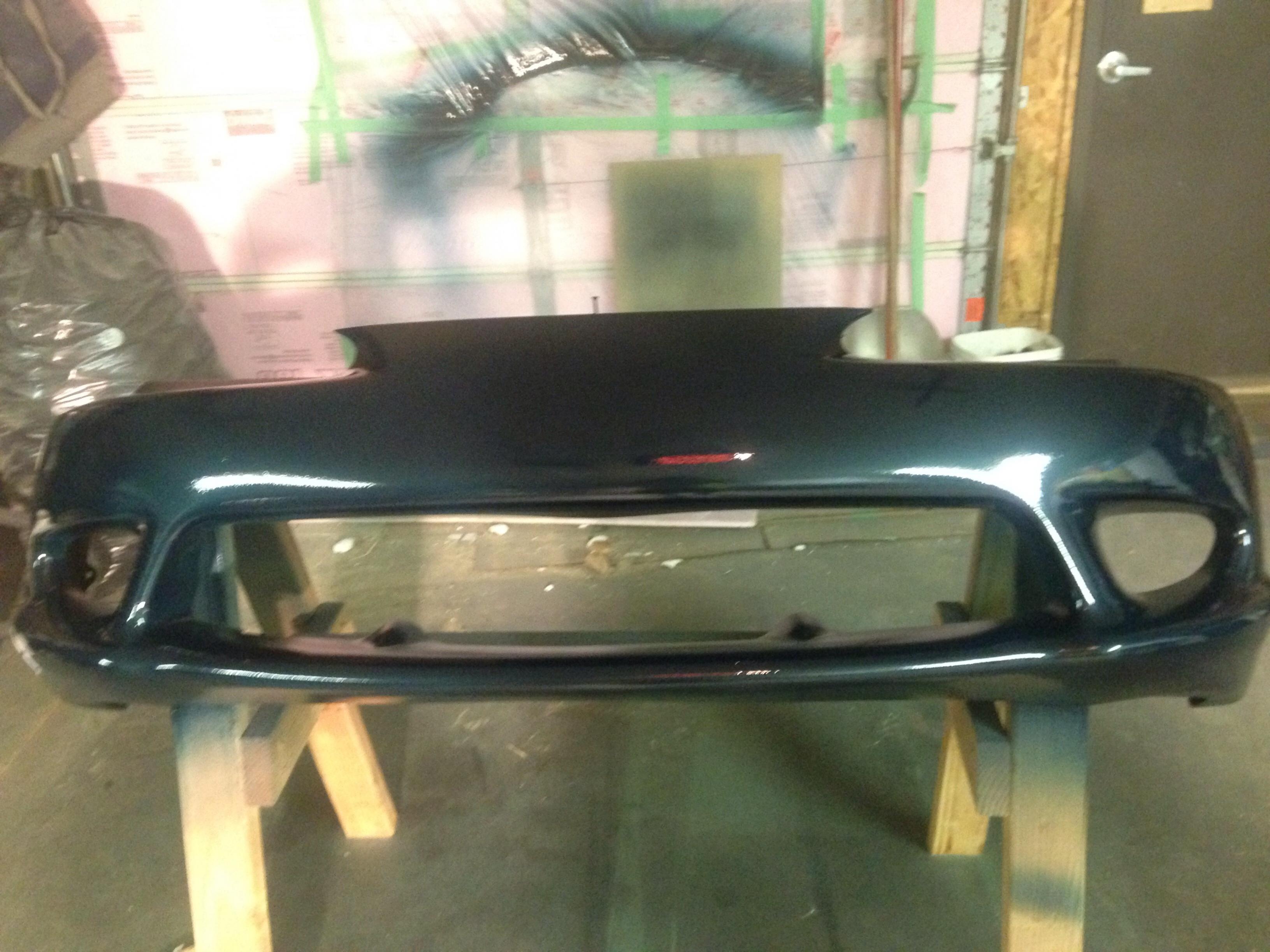

Finally got the front bumper painted, looks alright. Haven't had any motivation to put it on yet because it's been so damn cold. Hopefully the colors are pretty close.
talonsway 01-23-2015 12:11 PM
4 Attachment(s)

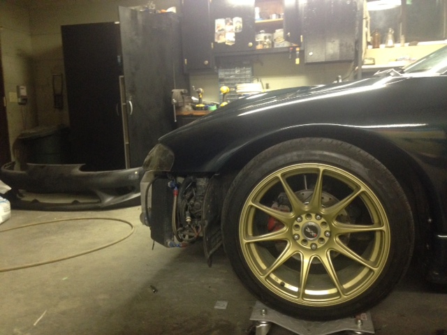

Got some time to work on the car got the front bumper back on turns out it has 3 shades of green now.
Attachment 14985

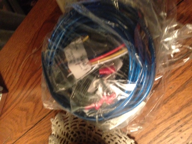

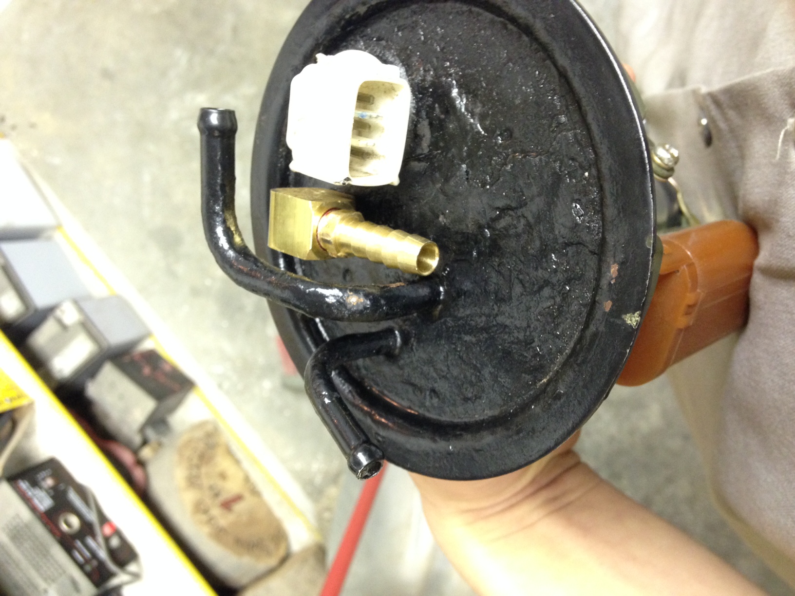

Also go my rewire kit for my fuel pump.
Attachment 14984

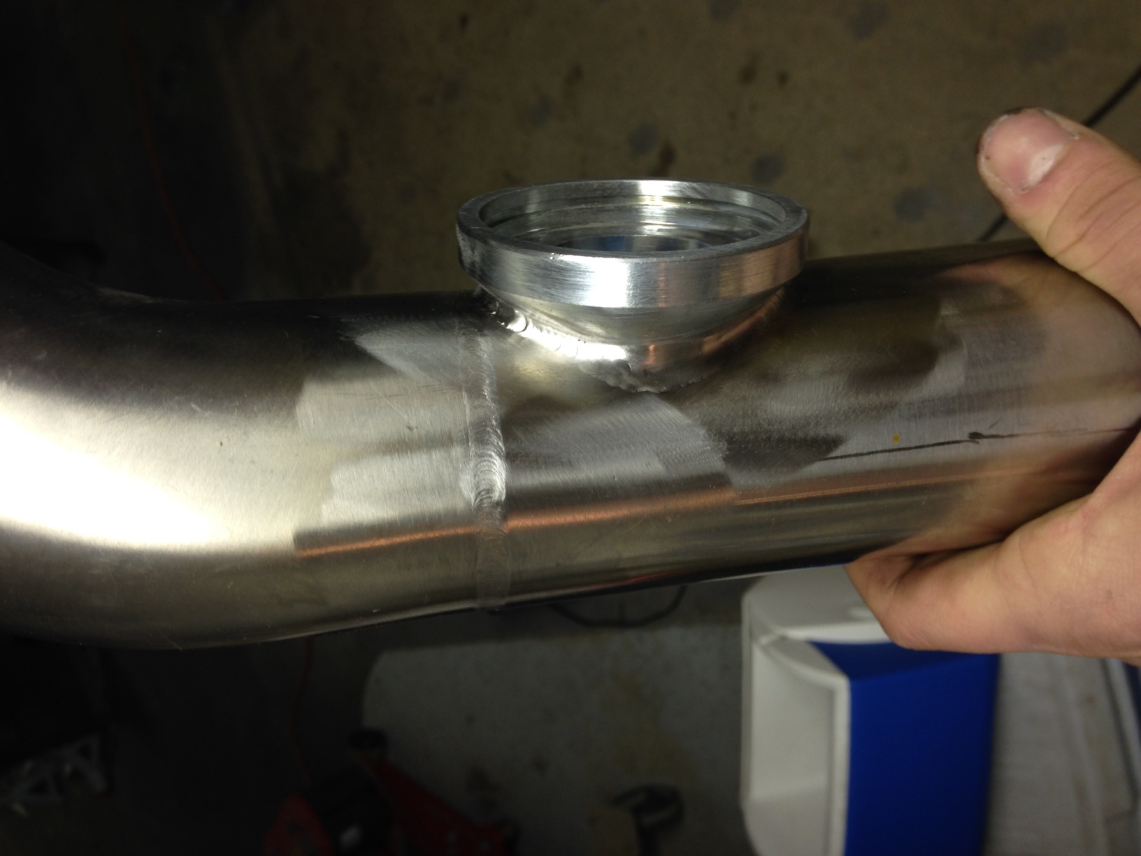

Making a new UICP because my aluminum one kept coming off under boost and when i tighten the T-bolt it would actually bend the pipe. Just waiting on my SSQV flange to weld it on.
Attachment 14983

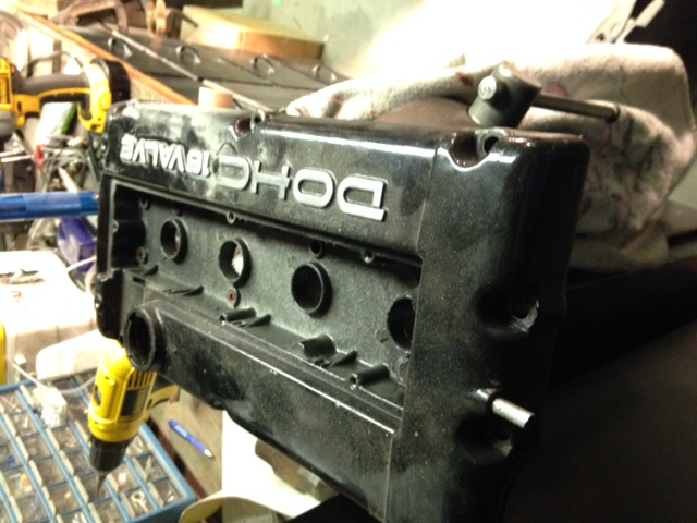

And something imma be working on the side is shaving this valve cover and adding some AN ports to it.
Attachment 14982

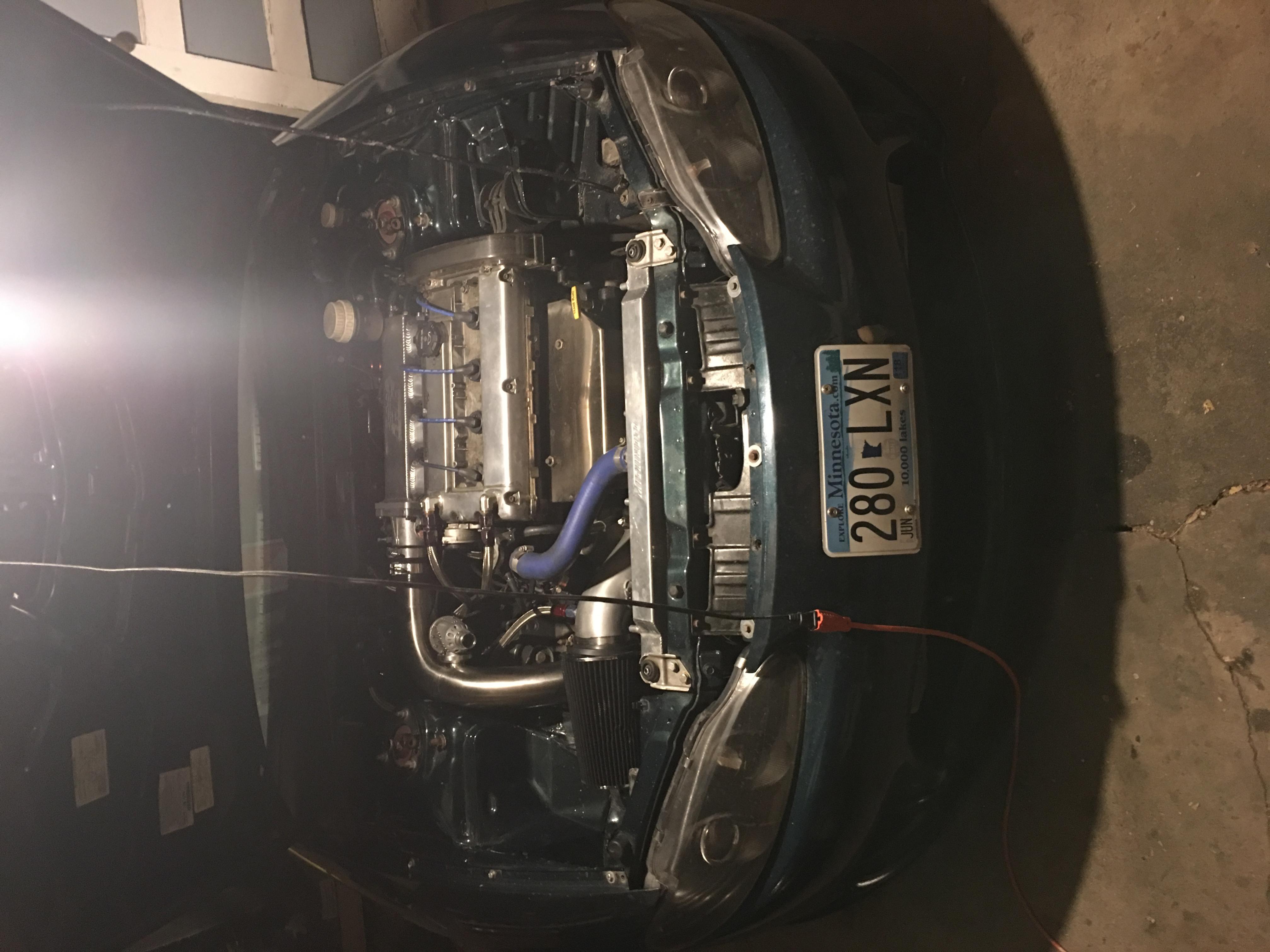

got the car all together along with re-wiring the fuel pump. Took the car out for a short drive to see how it was. Besides for a lil high idle/sticky it was fine also had my battery light on and also my break light. So i pulled the alternator and plan on getting one tomorrow.
Attachment 15027
Attachment 15028
Attachment 15029
Attachment 15032
Attachment 15033

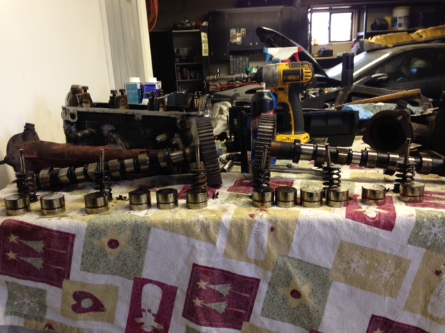

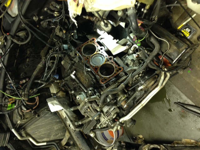

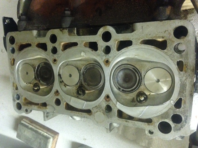

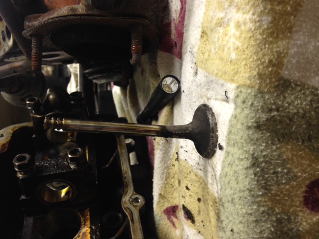

Have had no time to work on my Talon. The idler pulley on the audi went out and smashed some 6 valves so thats what has been taking up my money and time. But got it all put back together and runs way better.
Attachment 15093
Attachment 15094
Attachment 15095
Attachment 15096

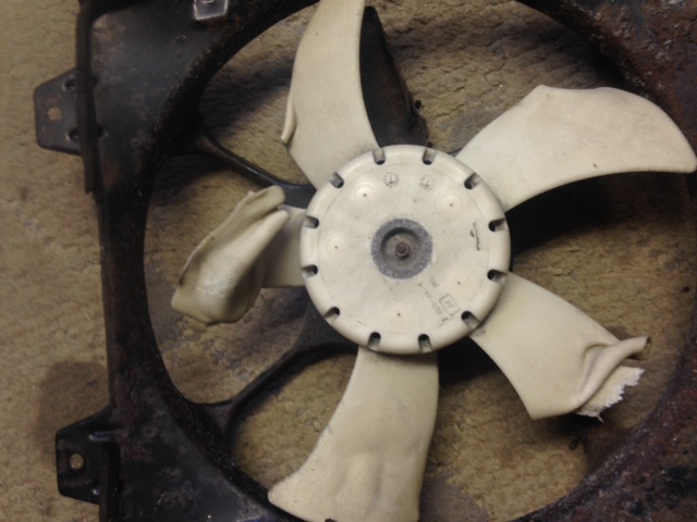

Did get a a new MBC and got that installed and also found out i melted my driver side fan pretty good. The next thing that im working on for the Talon is to make a heat shield out of stainless. Looks pretty straight forward and easy.

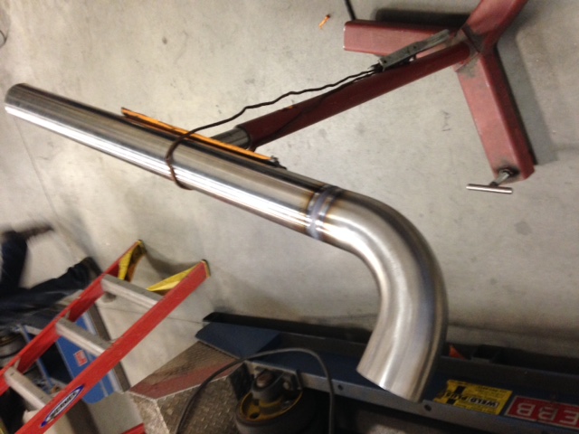

talonsway 04-29-2015 05:21 PM
2 Attachment(s)
Attachment 15196
Attachment 15197

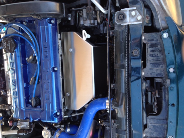

Ive had the heat shield on for a while and it works great, real easy to make and doesn't look too bad. Next thing that i will be working on is some porting and i will be switching over to SD, Just worried about if i will be able to figure out the tune once i switch over, i have been using ecu flash and am kind of familiar with it now but not enough to be able to run speed density yet.
