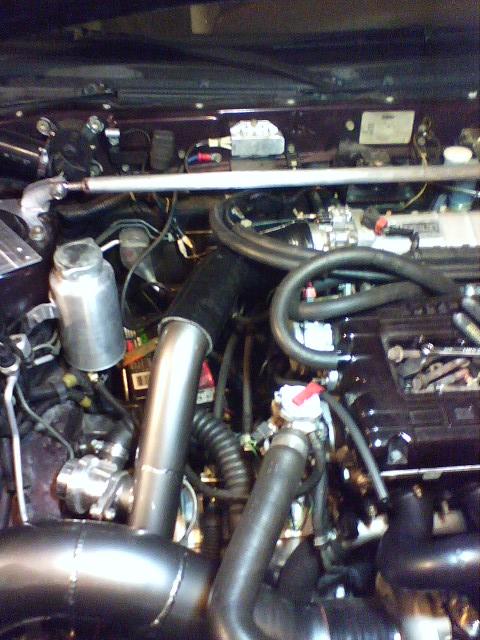

I'm home for one day. My roommates camera is nowhere to be found, so I just snapped a quick cell pic. Got my new coupler in the mail, had to trim it a little but got it mated to the NT TB. Just need to get the right hardware to mount the TB permanently, then clamp the coupler on!
BTW, 2.5" couplers are a lil bit of a PITA to stretch over this TB for those who want to use this TB in the future. You can see it's stretched a bit over that TB. It took a combo of Dawn soap, some preheating of the coupler in the oven, and lots of stretching to get it on finally. And the pics are deceiving, the coupler is on there all the way to the tall tabs. The pics make it look like it's on there only a tiny bit. ANywho, just glad I got something done while I was home for 1 day.
