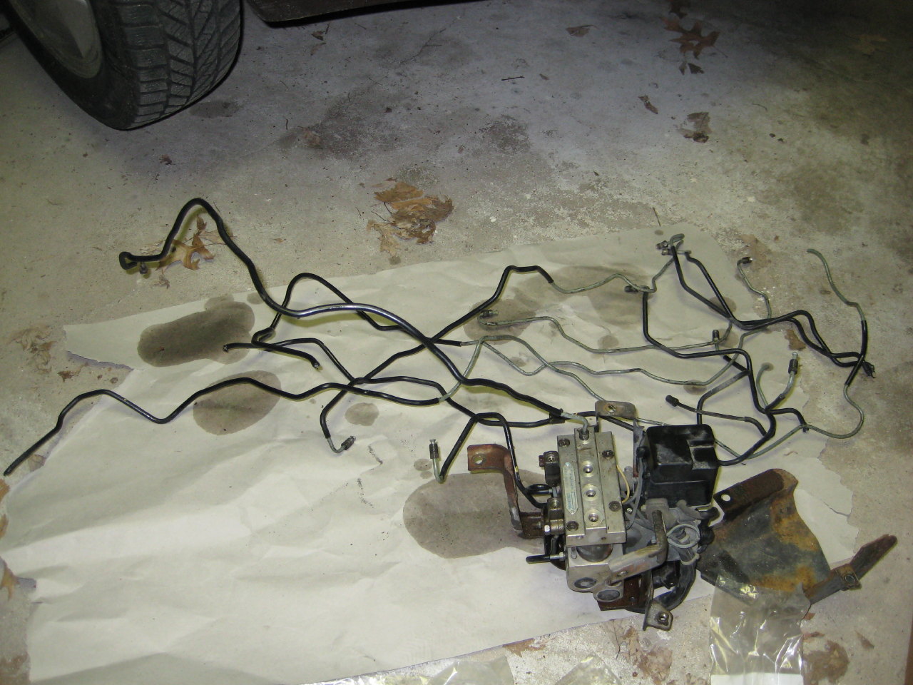

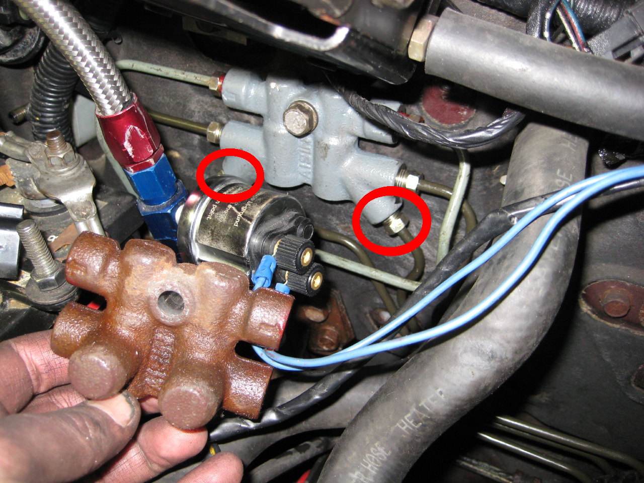

Anyway, got a good amount of progress done tonight. Got the rest of the ABS brake lines out, as well as the control unit in the fender. I also got all the new lines installed and hooked up, that was a pain in the ass. Bendy SS lines would have been a million times easier.
You can see on the bottom corners of the new proportioning valve where the primary/secondary lines from the master cylinder go to, instead of to the ABS control unit. It definitely helped clean up the engine bay a bit, I don't have a bunch of lines running to the front corner and back again. You can also see the new hole I have in the fender.
