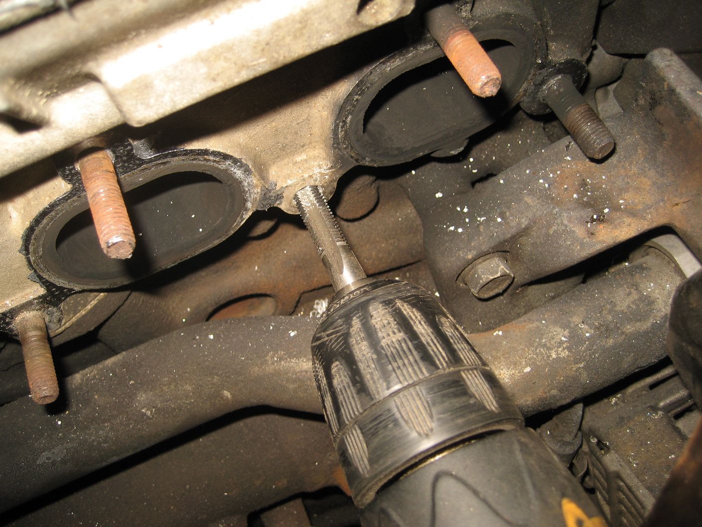

Well, first things first, here is the manifold on the car.
#1 shouldn't be that hard to take care of, however #2 is hidden from view and is completely gone.
Well, in order to remove stud #1 I had to weld a nut onto what is left of the stud, I had tried the multi-nut-on-stud trick, and it just didnt budge.
Now the advantage of superheating the stud is it expands and "breaks free" making it easier to twist out.
Thankfully, the #2 stud that I was trying to remove was just GONE, it had vanished, and it took the threads too
So, I drilled her out to 21/64ths
Get the helicoil kit out
carefully tap the hole
Hand-thread the insert in to make sure it doesn't cross-thread.
rachet the helicoil insert until it is past flush with the head.
Done
