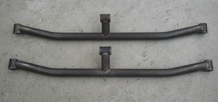

Thanks for all the reply's guys. I got it all sorted out. I ordered a front rollstop from Satan, figured out the difference and made the jig. Tested it on a fellow member's car and it fits. YAY!
For the archives here is what I found after some messing around in the Mitsu ASA parts application:
1990-1994 AWD DSM Manual Transmission
Front motormount bracket - MD133347
Rear motormount bracket - MD136195
Front motormount - MB436490
Rear motormount - MB436495
Crossmember - MB518381
1990-1994 AWD DSM Automatic transmission
Front motormount bracket - MD152506
Rear motormount bracket - MD143793
Front motormount - MB581635
Rear motormount - MB581640
