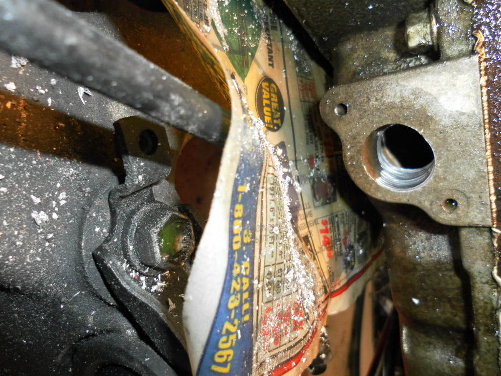

Not too much to update. But I've gotten the oil drain hole drilled out with a 7/8" hole saw. And the two bolt holes are tapped (M6x1.0).
Here's some pics:
Drilling the hole
Hole drilled:
Cleaning with Brake Cleaner:
Holes tapped and cleaned:
