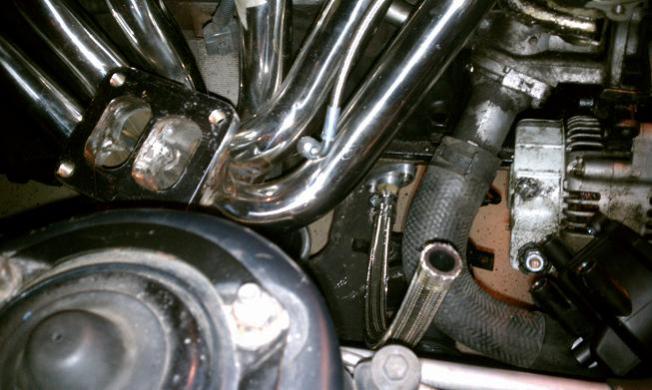

Got a little bit done today. Got the interior back buttoned up from the tranny removal/install.
Also made a little bracket to hold the oil dipstick steady since I removed the massive oem bracket that originally held it. Used some of that spare metal strapping stuff again, I'm starting to like this stuff!
Also I went to TNT and picked up a 6' length of -10AN SS Braided hose for the drain. fits over the 5/8" barbed fittings perfectly.
Thanks to Andrew, he gave me this chunk of 2.5" stainless to use on my exhaust. I still need some more bends if anyone has any laying around hit me up!!
Here is how she sits currently. I found that the turbo flange on the exhaust mani is not flat at all. Not sure exactly how to fix that, but I plan on just taking it to work and pressing it against the belt sander for a few minutes. And hopefully the gasket seals it up the rest of the way.
Other than that, I'm pretty much getting to the point where piping (IC and exhaust) is all that's left. Getting close, woohoo
