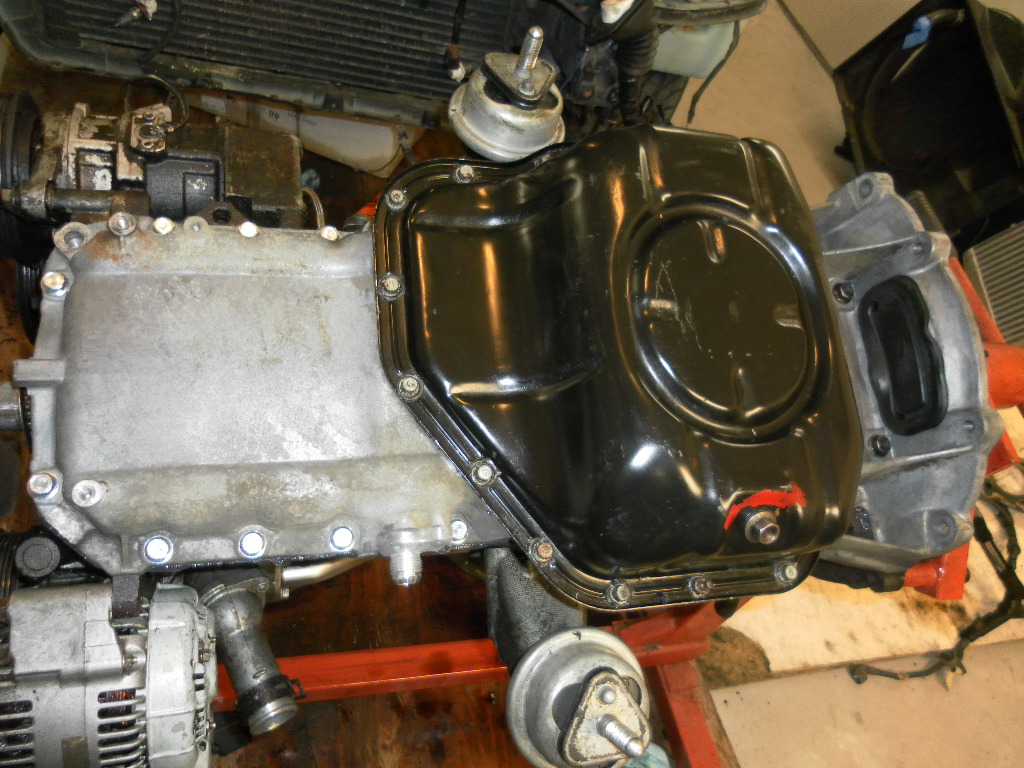

Got the upper pan back from MAP. They cleaned it up in the hot tank, and welded on a -10AN for the turbo oil return. Thanks for the quick turnaround guys!
Installed the upper oil pan with some RTV. Ace had perfect replacement bolts for my mysterious missing ones! Upper pan bolts all torqued to 6.5ft-lbs. Also got the lower pan on as well. Nice to be doing some reassembly rather than disassembly
