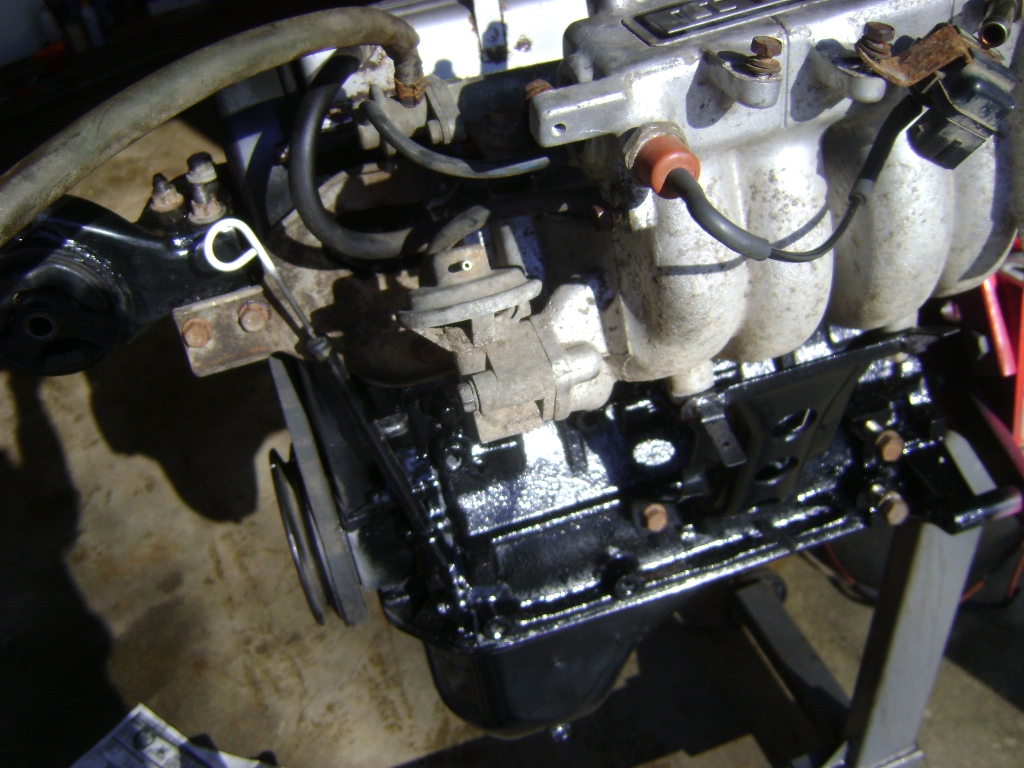

I went to Upullrparts in Rosemount; never been there before and I’ve never met a more unhelpful staff at a junkyard. Seems their service is limited to operating the cash register and saying no to customer inquiries. Anyway, I grabbed a mostly untouched 1.5 liter 4g37 out of a 1994 eagle summit 165,000 miles for 200 dollars. I rolled it over a few times with a breaker bar before pulling it and it seemed to have compression in the right spots, but looking back that was likely just the valve springs pushing the cam around. The Summit was a manual so I left the clutch and flywheel attached to the motor. I also disconnected as many lines and hoses and kept them as intact as I could, which was very helpful later as I ended up using almost all of them.
Back home I did a leak down check and was really disappointed to have a total failure on the 2 and 3 cylinders, and dismal results on the 1 and 4. I pulled the head to find it warped and in dire need of a valve job. Normally I do my own valve work but my grinder isn’t set up to handle stuff this small so I took it over to Kelley Auto who did the whole works for me. The shortblock looked like new so I just cleaned it and painted it. Although I spend about double what I expected to on the motor, the thing is like new now and should be good to go another 150,000 without issue.

The driver side mount looks real close, but is an inch or so too low, half an inch too short and a quarter inch too far forward. I ran it through the bandsaw and welded a hunk of 3/8” plate to it in what I think is my least proud moment in fabrication. As a token of my own humbleness I’m posting a picture.
The throttle body from the 4g37 replaced the 4g15 unit, to use the 4g37 electronics. There are various vacuum taps on the top for EGR and emissions things, depending on the engine. The only vacuum line on mine was the “P” line from the vapor recovery from the fuel tank. I just reconnected that line. My old 4g37 had no EGR provisions while the 4g15 had it. As yet, I have just left the valve on the intake and left it unhooked, namely because there is nothing to attach it to, and no electronics to control it. I would like to make it work again for gas mileage and out of concern for the air we breathe.

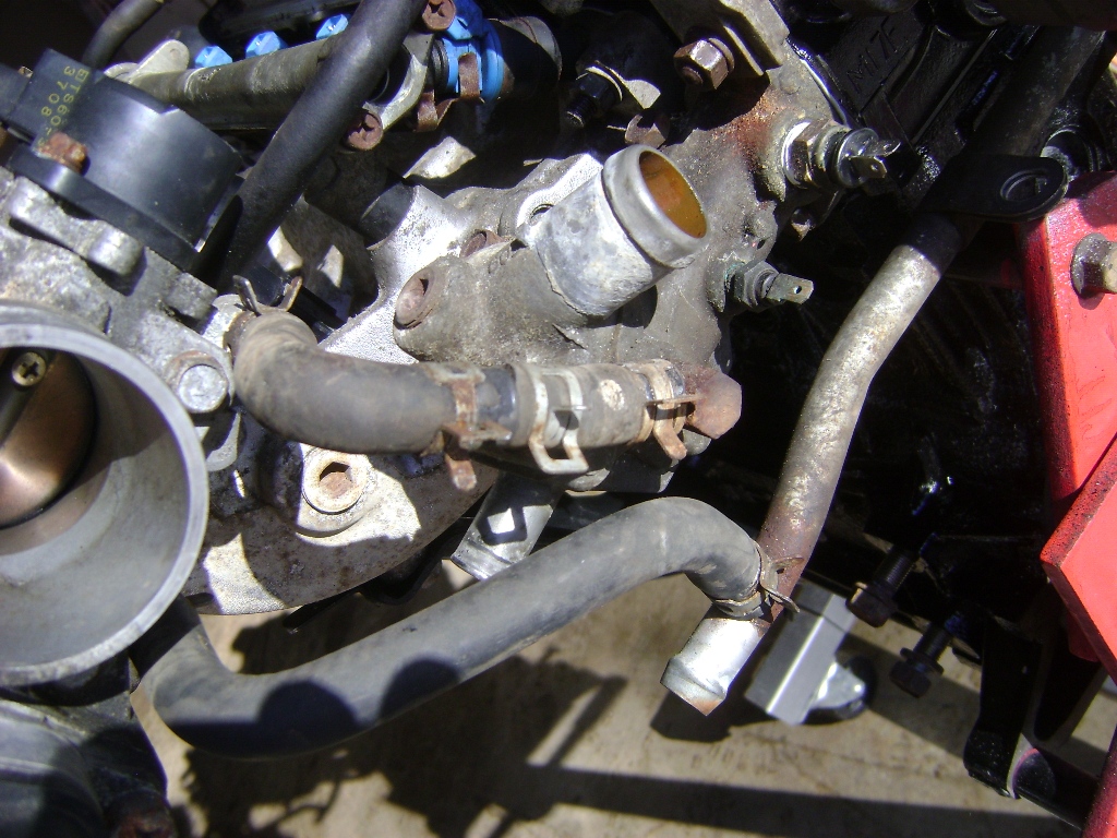

The throttle body is warmed with engine coolant, and the lines are different from the 4g15 to the 4g37. The lower hose from the 4g37 works but the upper hose is about an inch too short. I cut a piece off a scrap hose and joined them with a tubing nipple. The throttle linkage mount is in a different place on the 4g15 and the cable ends up being mounted about an inch too short. I mounted it with just one bolt for now but will see about going back and welding on some bosses to get a proper mount. Nothing is more embarrassing than having your car fail because of broken linkage. Throttle cable clips are off the 4g37, screwed onto the new valve cover.

The coolant hoses and thermostat housing were a bit of a hassle. The 4g15 had the radiator cap in the radiator whereas the 4g37 had it on the motor. As such, using a 4g37 radiator with a 4g15 motor leaves it with no radiator cap. I was thinking of just swapping the thermostat housings but the distributor precludes any swapping of parts in this area. Instead I cut the backside off the 4g37 housing and welded on a nipple to make an inline cap. I assumed that all the hoses are the same size, which was wrong. The 4g15 uses a smaller hose coming out of the thermostat housing which expands to the larger size when it meets the radiator. I was able to piece together enough to make it work, with the thermostat housing connected to my inline cap with the original upper 4g15 hose and the inline cap joined to the radiator with a hunk of the 4g37 upper hose. The goofy routing makes it rub on the distributor and could rub a hole in it over time, so I might need to fix it someday. The inline cap also interferes with the hood prop storage location which isn’t great. The lower hose is a 4g37 hose with about an inch cut off the engine side.
