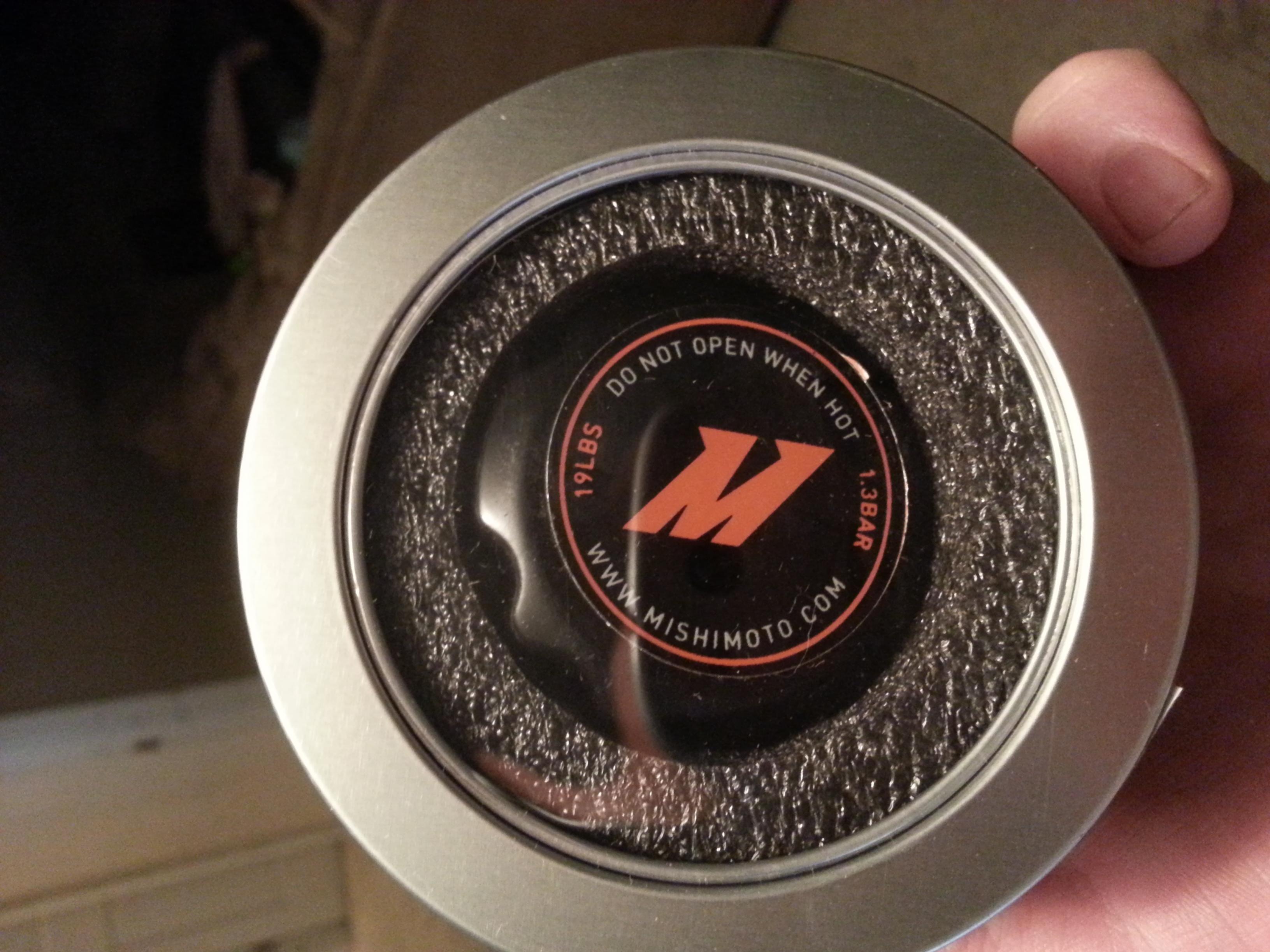

So something had to be done. Back to the boards I went with the question....do I get fans or do I get a radiator.... Once again took the advice of members here and ordered up a mishimoto xline radiator and radiator cap. The hope is that the 25% larger radiator coupled with the 1 stock fan will solve the issue.
I had a week to wait till the parts arrived from "map". In the mean time its been raining a lot and temps have been in the 70-80's... and all logs show 193-206 temps when outside temp is below 90. But I know this is south carolina and temps won't stay this low so feeling confident in my first major purchase for the car.
So walking threw the door yesterday found this waiting for me.... woot my first upgrades.
