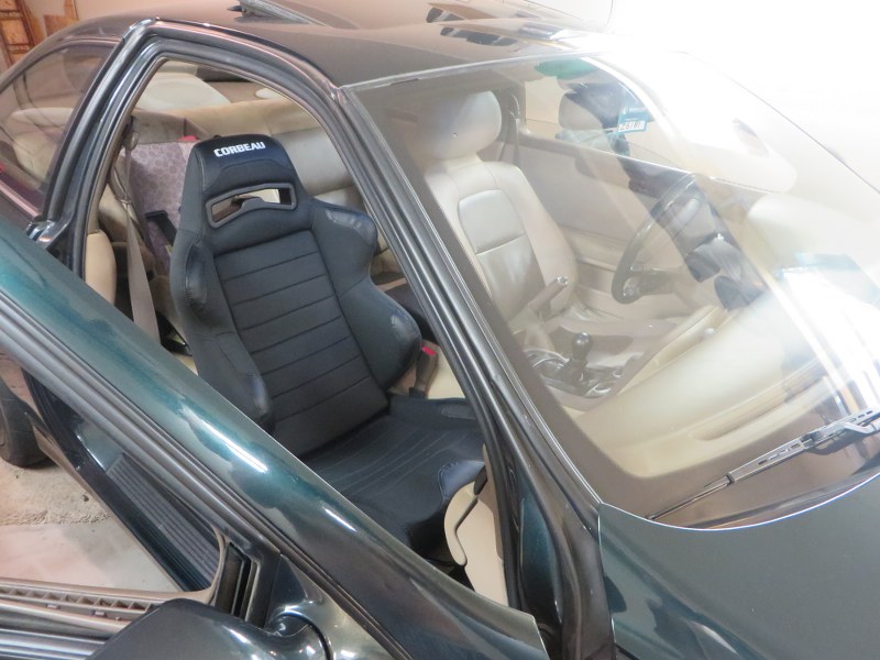

Passenger side is in!
So I had read about how bad a lot of these seat brackets were, so I was expecting install to be a little bit of a PITA. Well I was wrong, the Corbeau brackets fit perfect. 4 bolt holes to attach to the seat lined up perfect. The 5 holes that go to the stock location lined up perfect as well. Install was an absolute breeze!
I also busted out our highly inaccurate bathroom scale. I weighed the stock passenger seat at 56.5lbs. I weighed the replacement seat at 29lbs and the bracket at 11.5lbs. Not quite the weight difference I expected, but again this is my chinese bathroom scale. I also predict the stock drivers side seat will be heavier and be a more significant weight savings.
The seats fit in the car great, feel comfy, a hair more difficult to get in/out because of the torso bolsters but really not that bad. Overall very good first impressions, couldn't be more satisfied.
Only negative things are that the seat belt clip sits a little high, but whatever I'm sure they have it like that to clear the worst case scenario seat with super high bottom bolsters. And also it takes a little bit away from the sleeper-ness of the car, but that's kinda to be expected.
