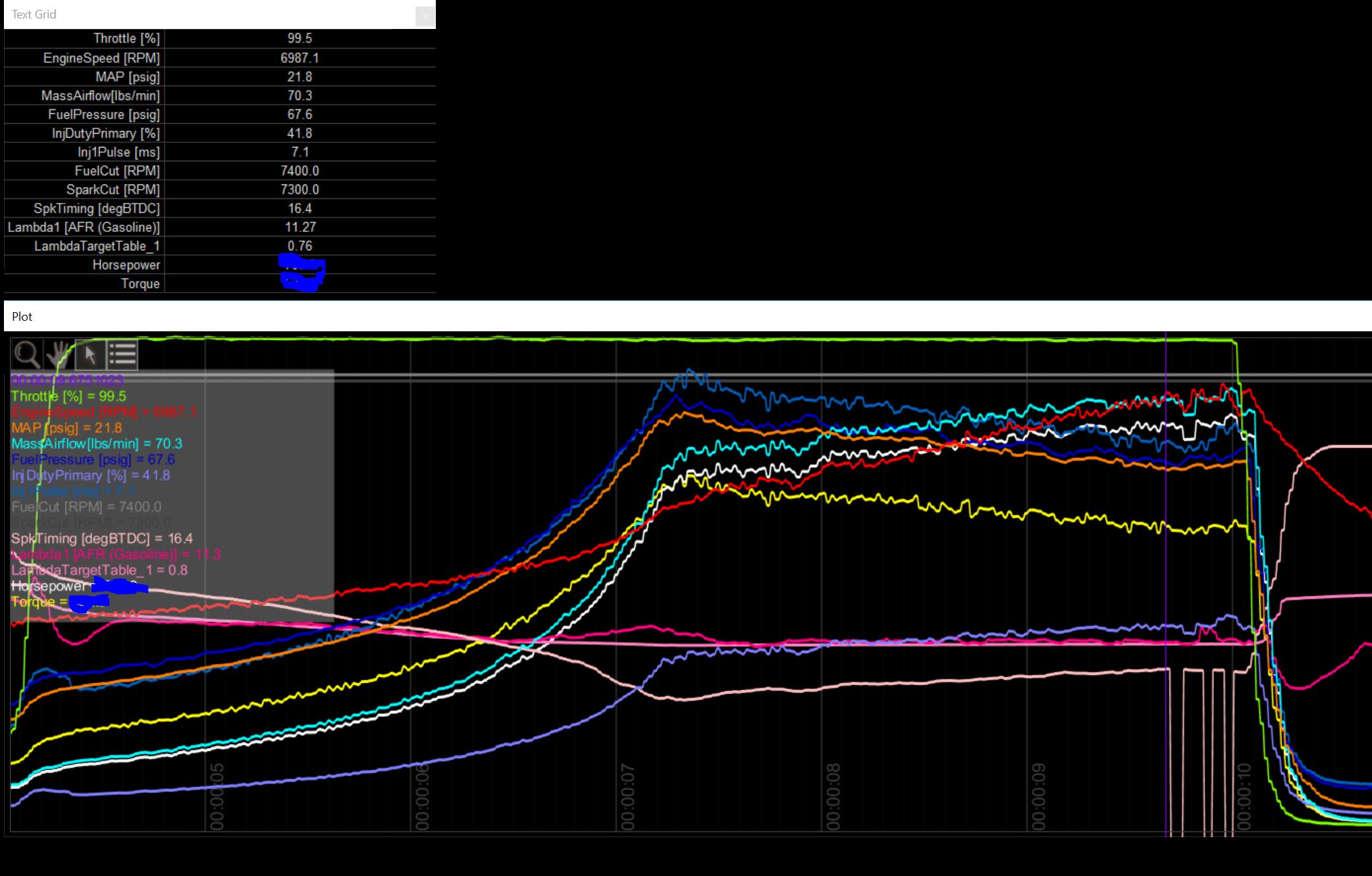

Today Kerry and I took it to the Auto Show and did a couple pulls. The new tune has us getting all the way up to 27psi by around 5200rpm, but gradually tapering to 22psi by redline. Holds better than it used to but still interesting how it tapers. I was sitting here staring at the log. I realized that AEM is showing that I'm flowing 70lb/min by 6500rpm and basically holding that until redline. This comp wheel is rated at 72lb/min. So being that I'm seeing 70lb/min, I'm wondering if I might just actually be about maxed out on this setup. My brain is so used to DSM stuff where I was pushing 35psi on a similar turbo to hit these kinda flow values, with 2 more cylinders now maybe I'm hitting those same amounts at less boost and this turbo will never hold 30psi to redline?
Anyway, car is feeling excellent! 3rd gear holds from a roll if the tires have had a chance to warm up. Here's a screen shot of my 3rd gear pull log.
