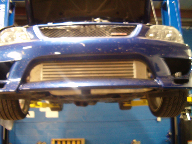

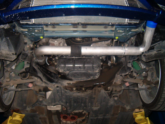

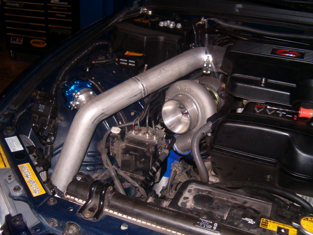

Finished up the IC piping for my own personal car. 6061 2.5" alum. Gonna be temporary until i get a sheet metal intake made for it to shorten up the cold side IC pipe and upgrade to 3".
