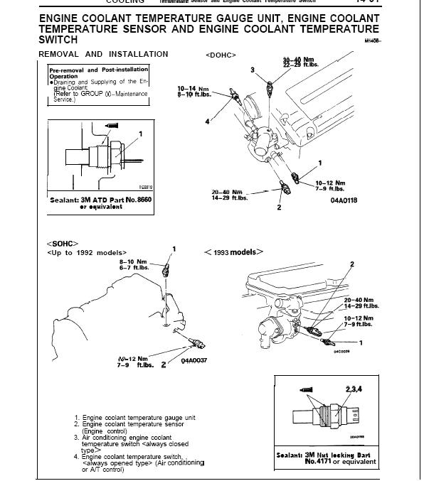

Forgot to mention I replaced the CTS on Craig's advice last time around with this issue. Nothing changed. Does anyone happen to know what the sensor/switch is that goes straight down into the thermostat housing? It isn't there on DSM's as the radiator cap is on top of the tstat.

I don't think there is easy way to check the FIAV.Its not bypassed or hacked is it? If not, I would just clean the hell out of the TB/FIAV/ISC and see what happens.

And by that diagram, it looks like the sensor I am seeing is number 3, so it shouldn't really matter if the wires are semi broken on that one as it is just for the AC. The AC doesn't work in this car anyways.
