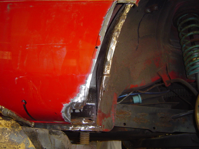

cut out right side rust and made panel and weled it in
started on left side rust

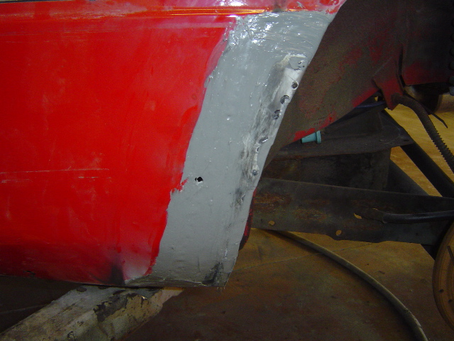

got the left cut out and patch welded in. seam sealed both sides. glazed the hatch and ther roof (had hail dents) fixed the high spot new the new left fender. surfaced the rear bumper

finnished the right side of the car
working on the front bumper
