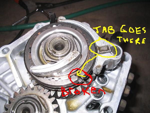

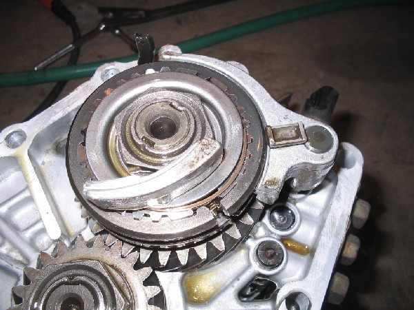

Just got the tranny out of the car. Popped the top off it real quick to have a quick look see. Here's what we found. Which fork is this?

looks like the 5th gear fork. you should be able to knock the pin out of the fork and just pull it off with the gear. looks like you might have lucked out and not have to open it up. it looks like you broke part of the selector ring too.

I hate to say it man, but that actually looks good! Good, as in in-expensive and easy enough to fix.

5th gear? Crap, I ordered a new 1-2 and 3-4 fork. Looks like I need a 5th as well then?

The little tabs popped out too. That is what is on top of the fork. There are 3 of them held in by a clip.

Where do those tabs belong?
Old 07-30-2006   #8
Re: Found MY Problem
They go in from the top on the slider. The other 2 may be in there, look for them.

Jet I figured out where that tab goes that you were talking about. But this little ring thing is broken. Is that called the selector ring? I guess I'll have to put one of those on order too.

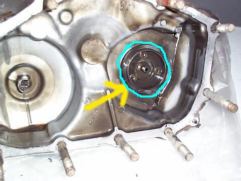

Also, VFAQ mentions this spring. My tranny does not have this spring. The whole little dealy that is surrounded by the turqoise circle, i do not have. What's up with that? Anyone know what it's called so I can order it?

That broken piece is the slider or selector ring.

The spring you're missing is a wave spring. You only need one pin, and someone that knows how to drive.

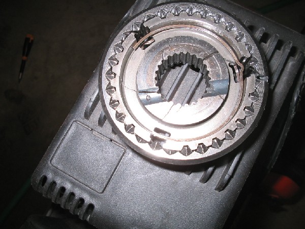

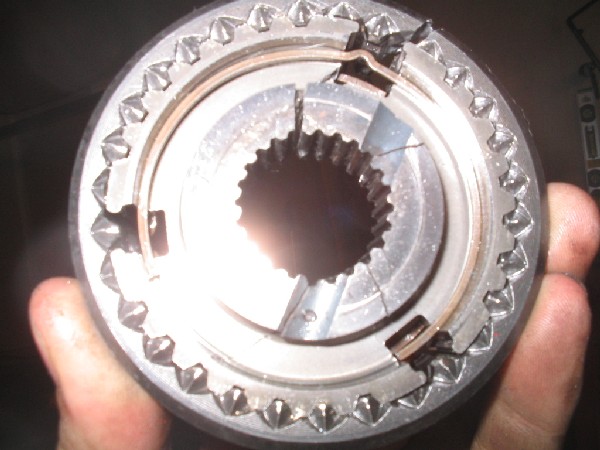

More pics to show the carnage.
My trannies outcome...
-broken 5/R fork
-broken 3/4 fork
-broken 5th gear slider AND gear

Dang thats some damage! Get it back together yet?
