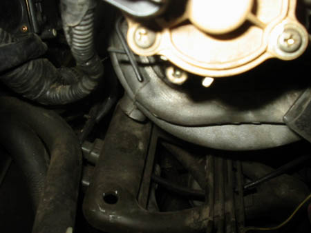

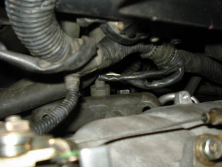

umm.... i will have to go look when i get off work, but i swear to holy jesus i am right about that bracket. Yes its on the back of the intake manifold by the firewall. There are 2 bolts holding it onto the intake manifold, and one holding it to the block. And between the 2 bolts on the intake manifold are 2 electrical plug harnesses that go to i dunno where. I will look once i get off work and take pictures. Plus it'll look goofy on my car because i didn't bolt it back onto the intake manifold, so its kinda crooked

I am not sure who is right but a pic would be awsome.

I am right. As you can clearly see in the picture, there is a bracket which is not attached to my intake mani anymore because I think it just makes life easier when removing the head. You can see that all your emissions lines are attached to this bracket, and there are also two electrical connectors on it. So make sure to unbolt that from the intake mani or else you'll be sitting there wondering why it seems like the head is stuck on there!

pic
Old 03-03-2004   #12
pic

The 2 connectors are actually on their own seperate bracket. They are for the ignition system. The one with the emission lines in it was the one I was talking about.

Originally posted by JET@Mar 3 2004, 09:30 PM
The 2 connectors are actually on their own seperate bracket.&nbsp; They are for the ignition system.&nbsp; The one with the emission lines in it was the one I was talking about.
The two connectors are on a tiny lil hunk of metal attached with a singe nut to the intake manifold bracket. They aren't even attached to the actual intake manifold, and i has said to take off the bracket that connects the intake mani to the block, and has 2 plugs on it as well. You're saying you thought I was talking about that little tiny hunk of metal the connectors clip onto? :stick: haha, im just playing man, :toast: i guess i shoulda been more specific, but i figured when i said the 2 bolts on that bracket that attach to the intake manifold, i figured he'd understand. But i guess it may have been slightly confusing. But good luck on it man, you'll be fine
