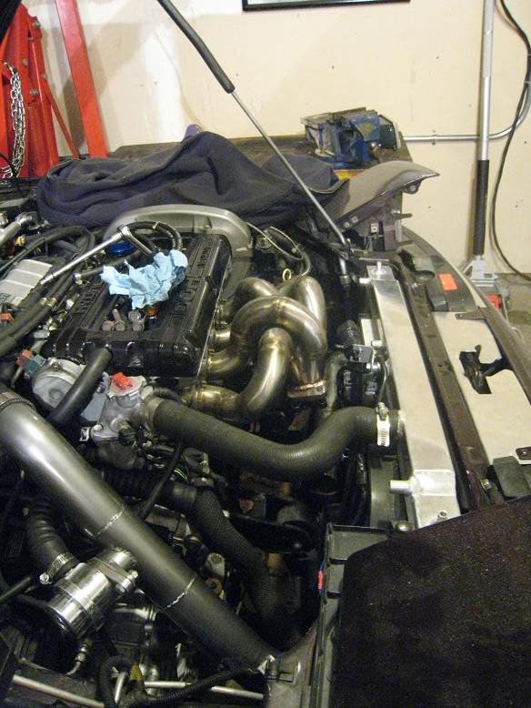

Just thought I'd start this up to keep track of my progress I make over winter, and see if I make my goal. Here are the plans
- Borg Warner S362
- T3 manifold
- Tial 44 Wastegate
- Swapping out Forge MBC for new Hallman MBC
- New complete SS turbo back utilizing only V-Band's
- New Fidanza Clutch
- New TRE built tranny
- JMF Intake Manifold
- 1G N/T Throttle Body
(cheap new 3930 seals)
http://www.ebatmus.com/cart.epl?Buy=...580&Query=3930
- Still sticking with E85
- CF Hood
- Radiator ducting
- New headlights
That about sums it up. The swap has begun. The old 50trim setup is out. Stuff is starting to make it's way into the engine bay now

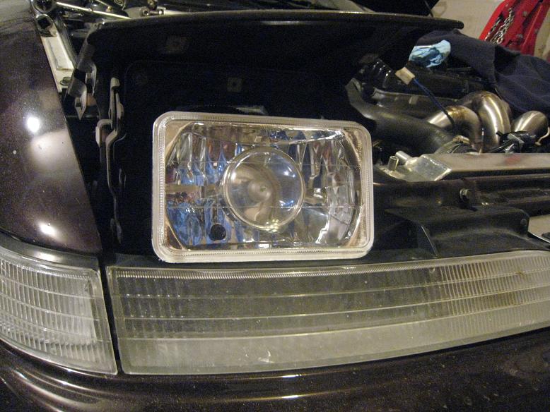

Just threw some new headlights I got off ebay for cheap. No more sealed lenses. These just use common H4 bulbs. Ricer Polish Pete at Maple Grove Goodyear hooked me up with some H4 pigtails for dirt cheap, that I soldered in just now. Worked like a charm, thanks Pete! I have to do a little grinding before I can mount them in place though as the backs are a little larger then the normal ones.
