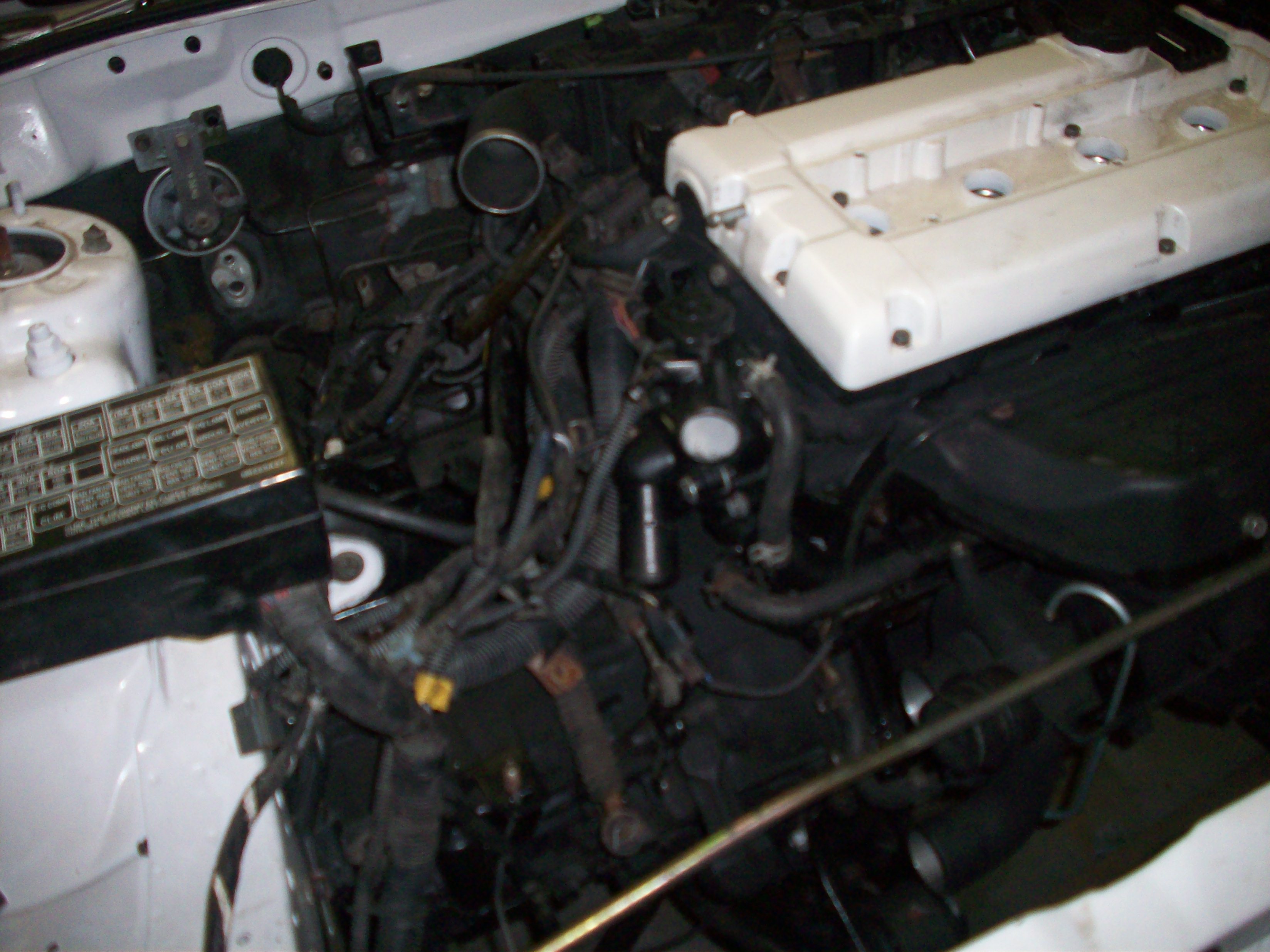

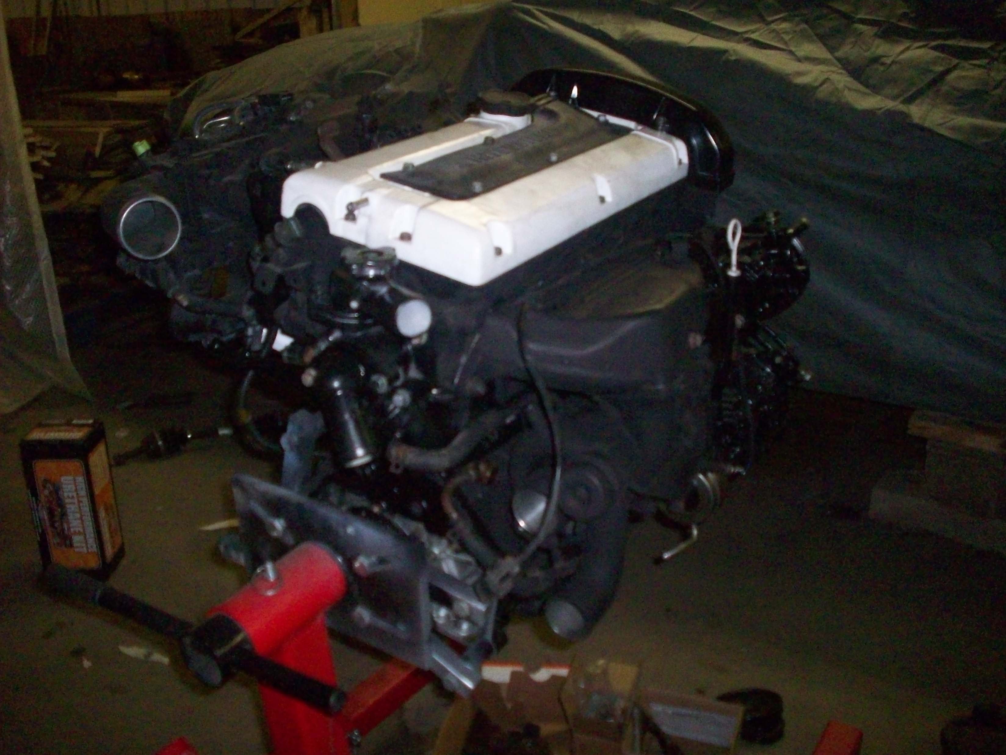

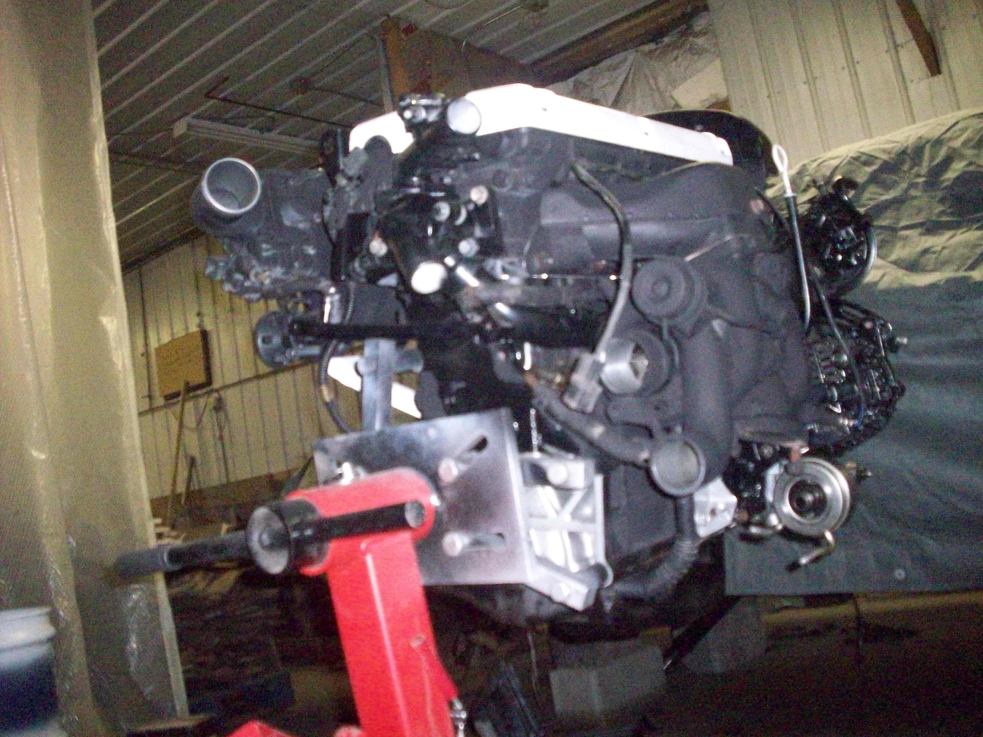

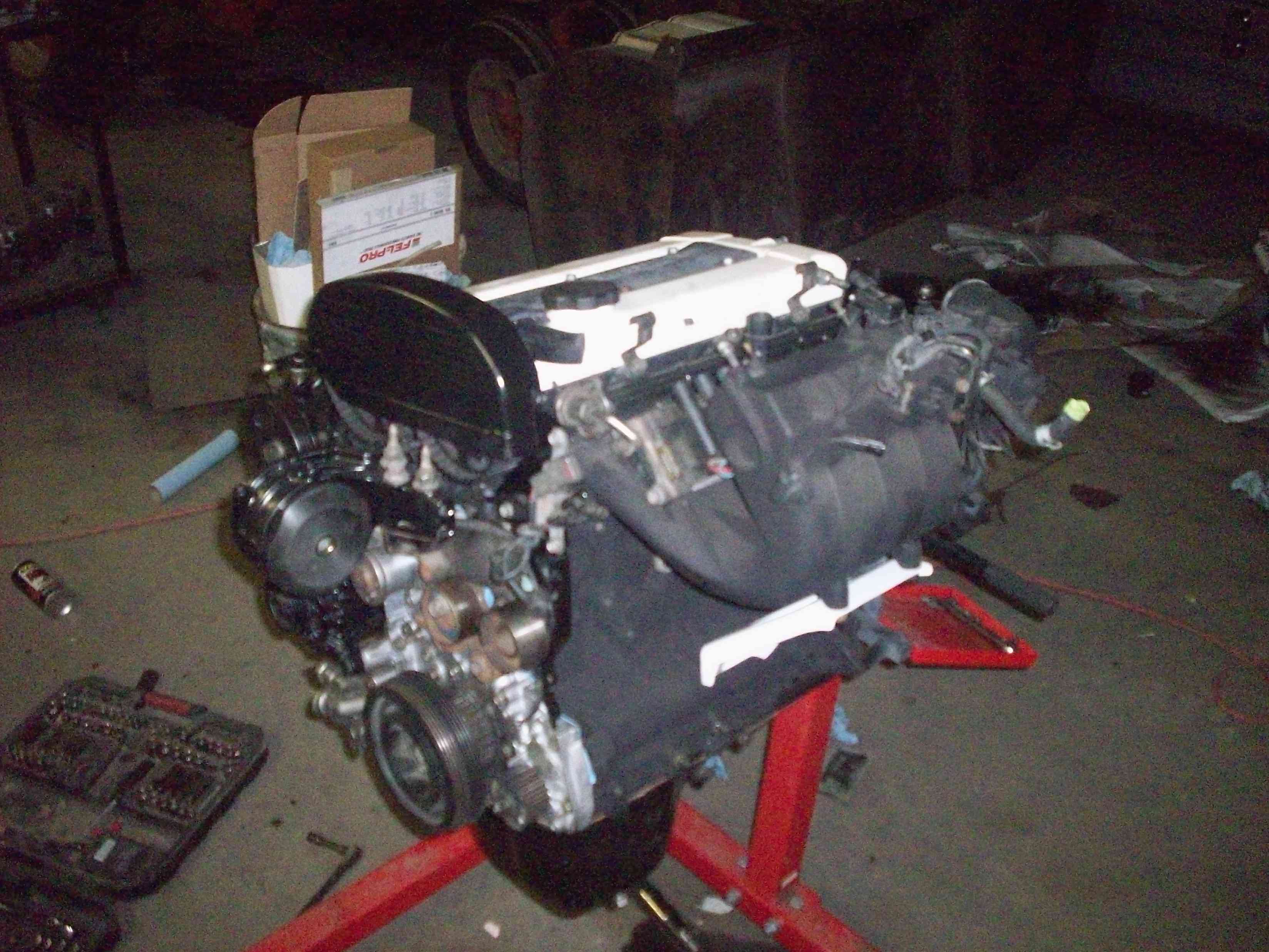

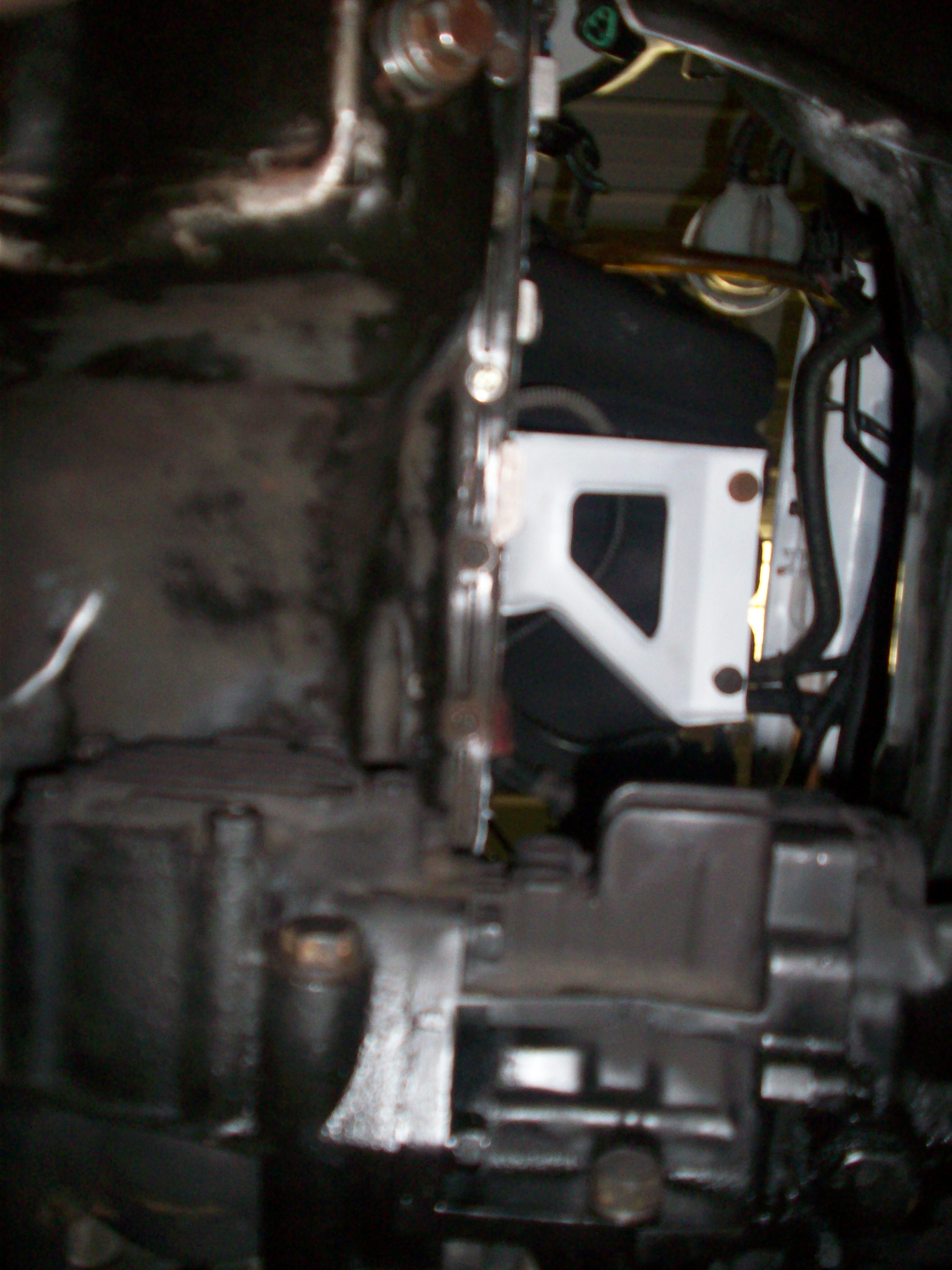

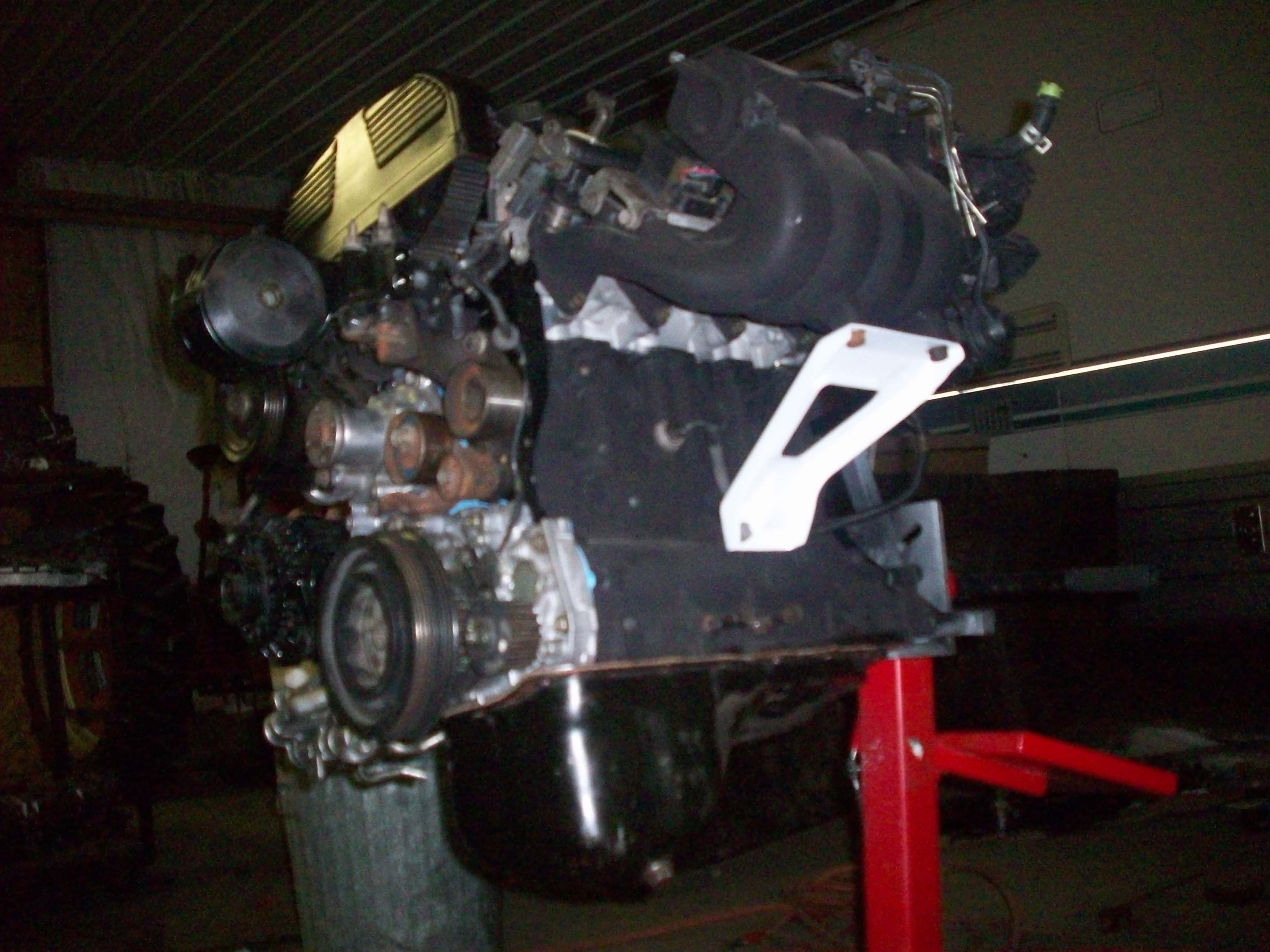

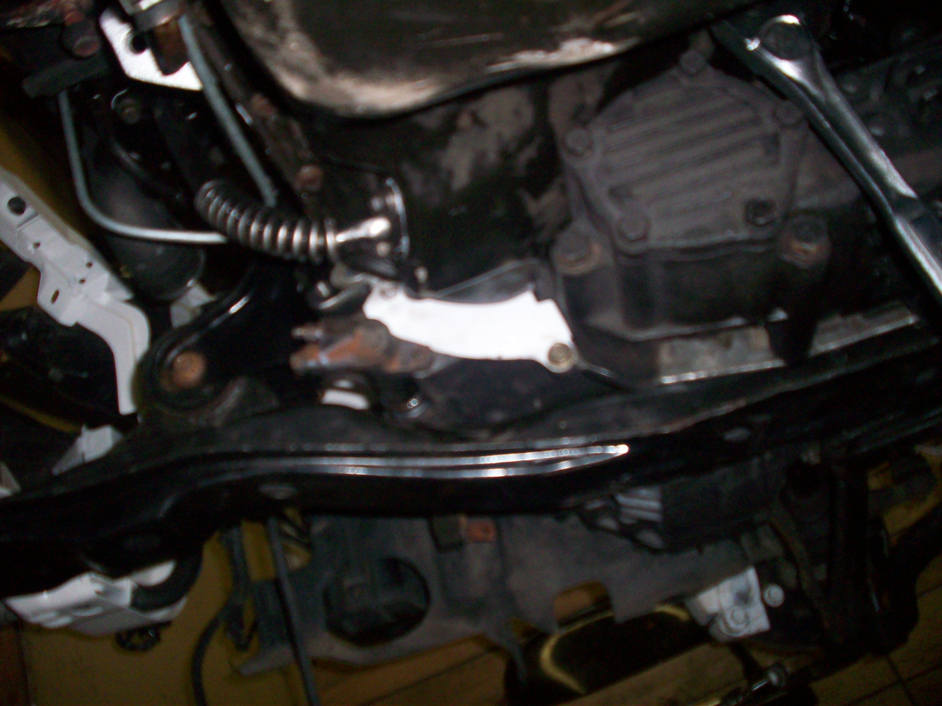

This is the 4g64/4g63 hybrid motor.. keeping the turbo stock for now until i get it all working right. its a big enough project the way it is.... This is the motor almost all put together.. still need to put on the galant cam gears and timing belt. then time it..

Please please PLEASE tell me thats powdercoat and not spray paint on all of the hot parts

powdercoat. yes t25 i'll upgrade later big enough project. lets get everthing in working order

Ok ok I high tempt it. What do you want from me! Haha but I did powder coat the parts that I could

Do you realize how hot your turbo and exhaust manifold gets?

Wooo, sounds like fun? I would strip all that paint off the head, that sounds like a bad idea.

ok we'll see what happens... what if the paint is 1200 capable?

Doesn't matter, the head doesn't get very hot. The V8 guys paint aluminum heads for stock appearing classes, so it looks a little funny, but shouldn't cause any problems.

DSMs get very hot, A good way to tell is go to a meet and ask people to pop their hoods, then take a non contact temp reader on some of the parts that you have used high temp paint on. You will be surprized at just how hot it gets. You can get the non contact temp readers for cheap from places like harbor freight.
It wont likely cause a fire, but it will smoke like hell with a nasty smell, then while it burns off it will look like crap.

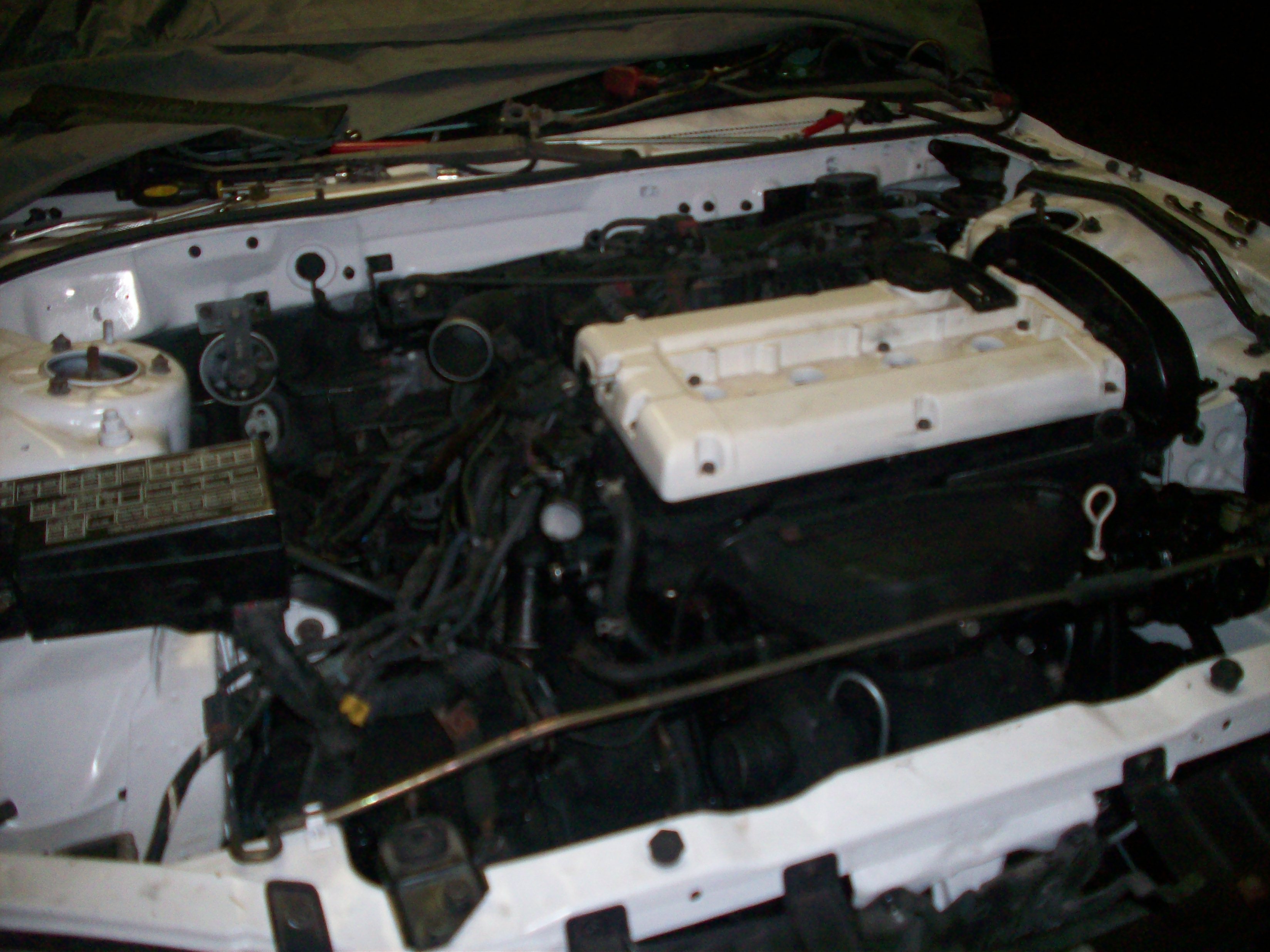

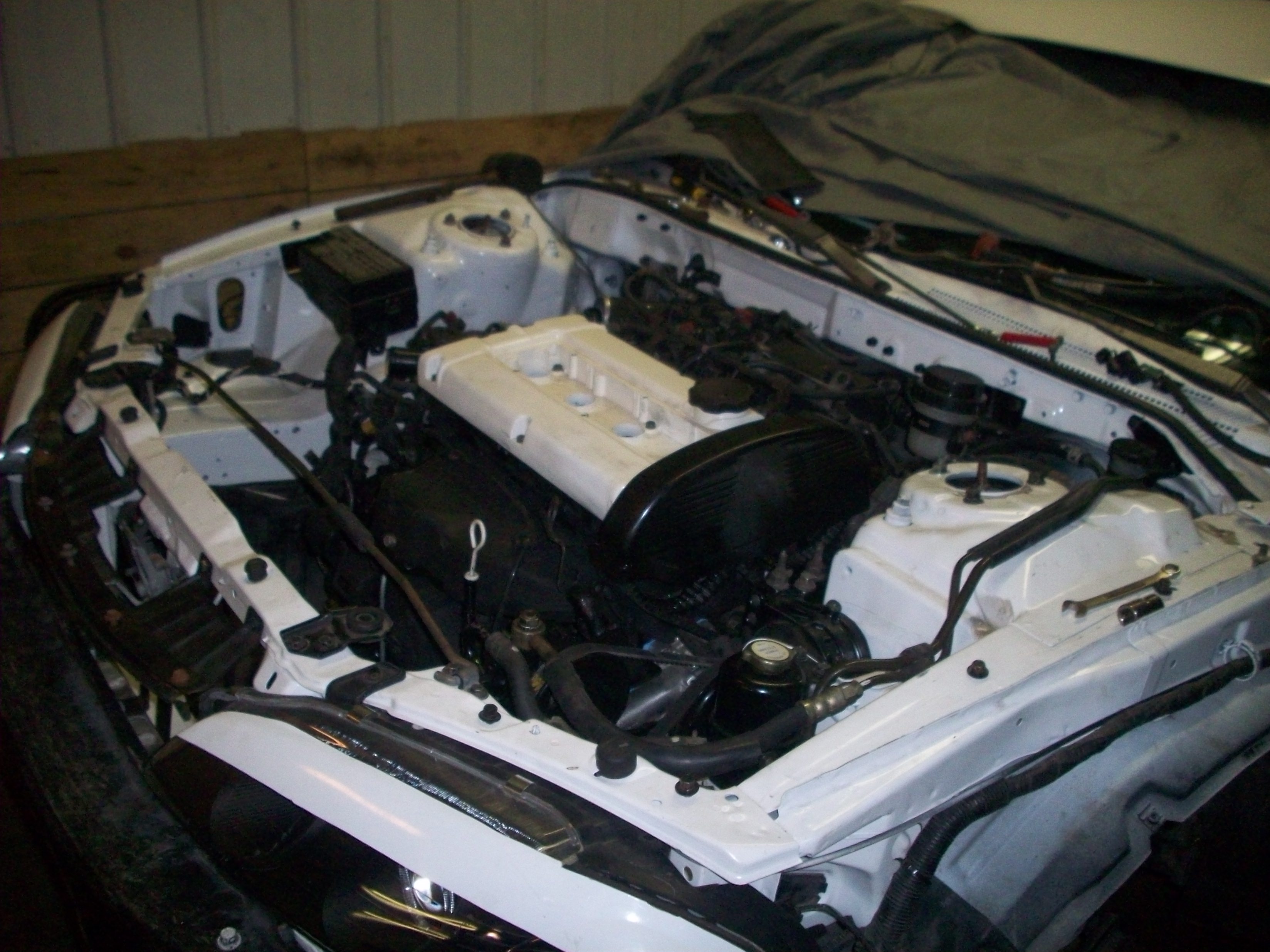

got the motor in.. gettin things slowly together as i figure out whats beat up and whats good
