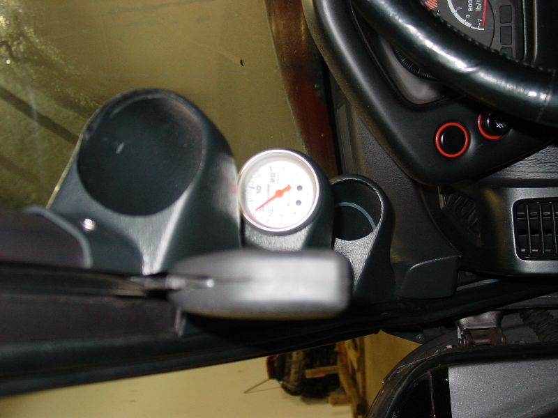

Old 01-23-2008   #3
Re: Project Salt Collector
A-pillar 3 gauge pod setup.

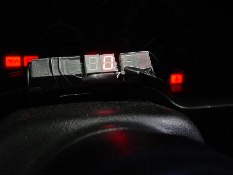

Old 01-23-2008   #4
Knock monitor covered in black tape and jammed into the steering column. The brighter middle number displays knock, the right number displays timing advance.

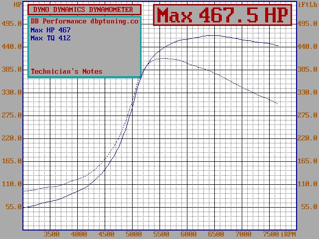

Old 01-23-2008   #7
LOL at everything Shane typed! Must have been a slow day at DB

holy shit, what is the tuning software?
Old 01-23-2008   #10
I usually use Tuner Pro RT.
Revlimiter is set at 8200, but I didn't bring it out that far on the dyno run above. The power just continues to drop at the same trend. A different intake manifold should bring up the power a lot from 7000+ RPMs. I think it would make a good 550whp on an AWD Dynojet and a little more on a FWD Dynojet. On an older setup, pump gas, and 19psi it put down around 339whp on Elite's Dynojet in FWD mode and then put down around 265awhp on our Dyno Dynamics in AWD without any changes, but some time inbetween.

I bought a different wastegate for it in the middle of last summer, but I haven't switched it out yet. The car has been in this state of mod for a while now, the dyno chart above was from the MitsuStyle dyno day.
