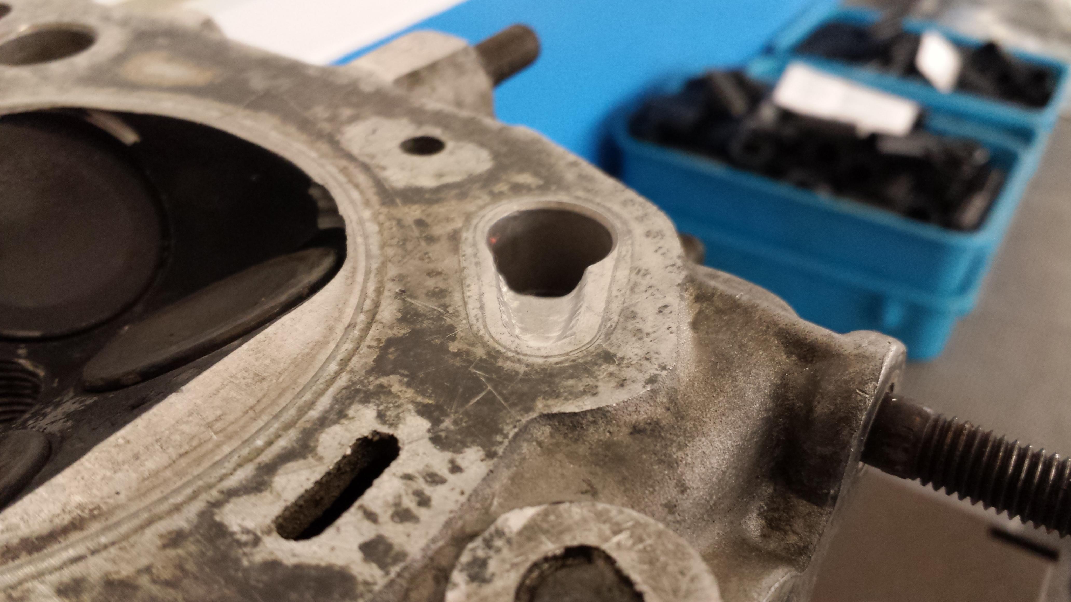

Ok i ahead of time apologize for bringing back the dead but I have a Q about this mod:
When doing the port on this how deap do you go, or do you not really go any deaper but just widen
the port like said and not ad any depth?
I would like to do this befor my head goes out to gosh for resurfacing.
Just couldn't stay away.

I just made mine a nice smooth transition instead of a hard 90-degree curve. You don't need to go that deep.
Speaking of that, I didn't notice any difference doing this, I still have a slight lifter tick and my oil pressure was still really high until I ported the beejeebus out of the oil relief valve. I just did this because it seems like a good idea and I port everything for smooth flow. Me and my cabinet of flapper wheels and bits are close buddies.

Lol. Thanks for the info, I'll just do a smooth transition of the port.

Should I go a little more ?? Not sure

Looks like you could probably go a little wider if you wanted. Towards the right in the pic. Then smooth it out some.
