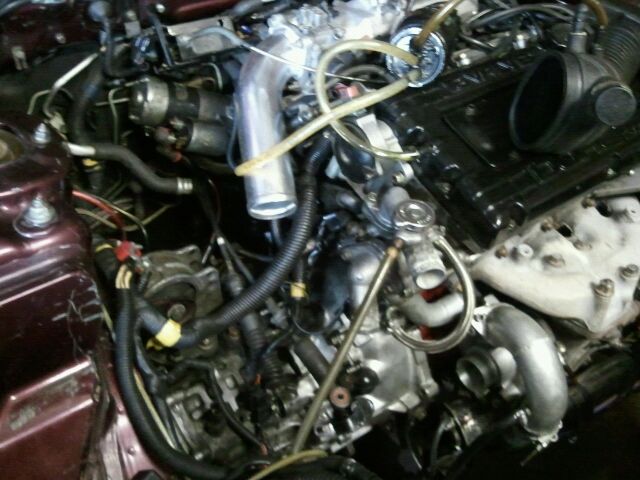

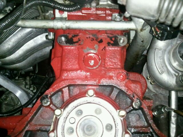

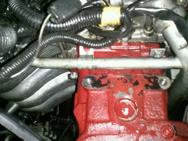

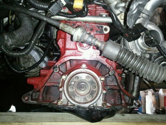

Hey guys, so I've been battling a slipping clutch because of what I suspect to be caused by contamination. I've dropped my transmission 4 times now and have replaced my rear main seal and its housing, oil pan gasket, and axle seals. Had the flywheel resurfaced to .610 and got a new 2600 pressure plate, because I thought mine was a 2100, and a new sbc-tz disc. Somehow I believe motor oil is getting through my bell housing and onto my clutch. From the pics below it looks almost as though it is coming from the headgasket, oil galley plug or its gear oil and coming from my input shaft (fwd).
Any thoughts?
Thanks, Mark

lol just realized how bad these pics are..Going to hopefully pull the tranny tonight if I can get one of my buddies to help. Will update pics once that happens.

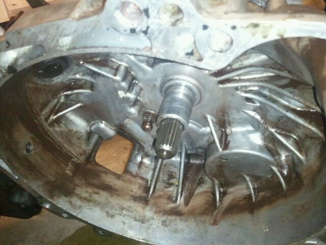

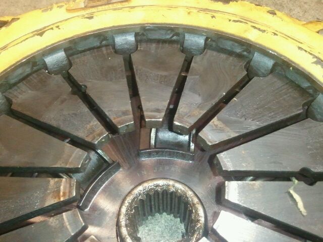

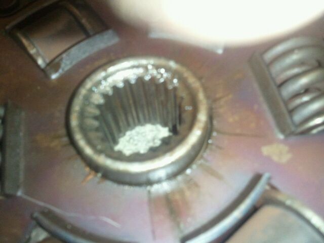

Pulled the trans, found what seems to be gear oil. Judging by the splat pattern in the pics of the disc and PP it looks like it was leaking towards the block. let me know what you think I should do/ look for now.

Re: Slipping Clutch/ Contamination Issue
Hard to tell what's going on in those pics.
Old 06-09-2013   #7
mark4g63t
mark4g63t's Avatar
Join Date: Jun 2012
Location: Twin Cities
Drives: 95 Talon TSI
Posts: 941
Mostly showing the splash pattern starting in the center working its way outward
Wiped the input shaft off to see if anything will show up in the morning. Block seemed to be surprisingly dry.

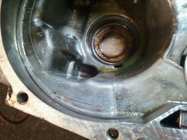

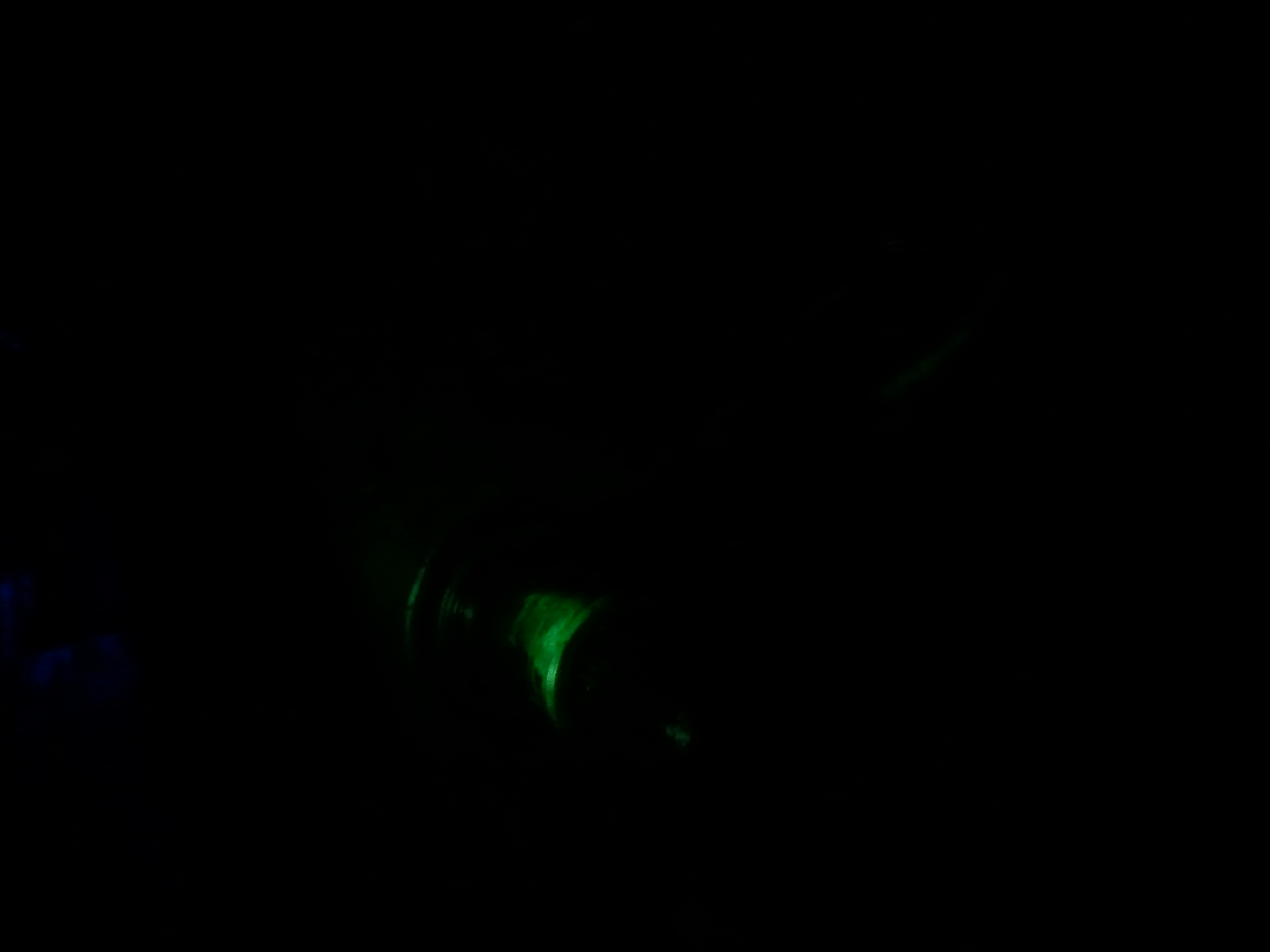

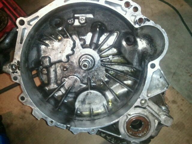

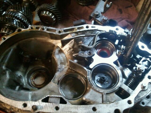

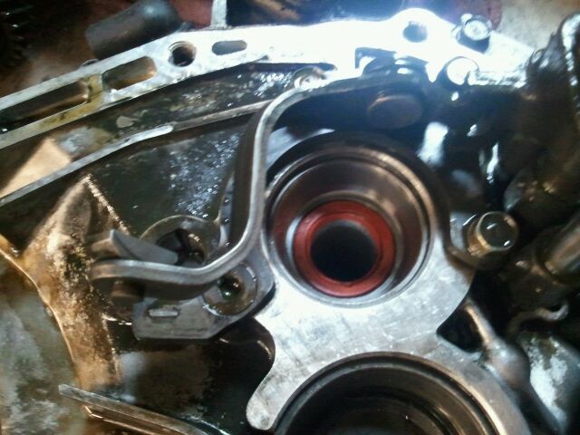

Got the input shaft seal replaced by Mark. Put the flywheel and clutch back on last night now I just have to lift the tranny in tonight when I get off work. Also wasn't going to take a chance of oil leaking out the galley plug so I jb welded it closed. Here are some more pics. As Mark was taking the gears out a crush washer fell out and reveled a nice size gash in the case. Glad it didn't cause more damage.
First pic is the leak shown by the UV dye on the input shaft
Second and third are the seal and location of seal
Fourth is the gash left by the random crush washer

Clutch master was adjusted properly, yes, if thats what you meant (2g). It was a leaking input shaft seal that was putting gear oil onto my disc and making it slip once boost started to hit. Should be fixed now. Only time will tell tho

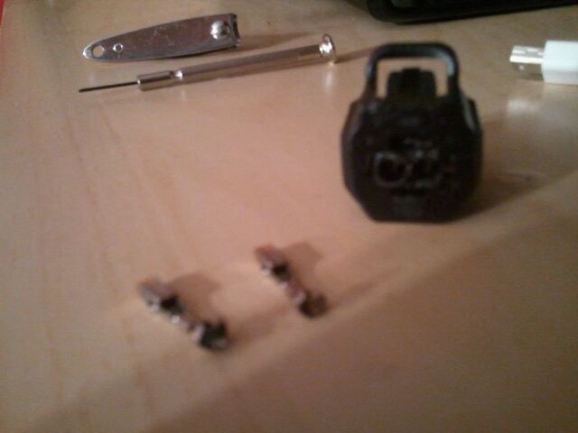

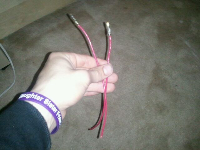

Got it all back together beside the fact that the coolant sensors got ripped out of the connectors right at the base. Depinned them this morning but was unable to finish due to the power going out. Decided to lengthen the wires a little bit to make sure they don't get ripped out again and to hide them a bit more than previously. Hopefully tonight it will stop raining so I can take her for a much needed cruise.
