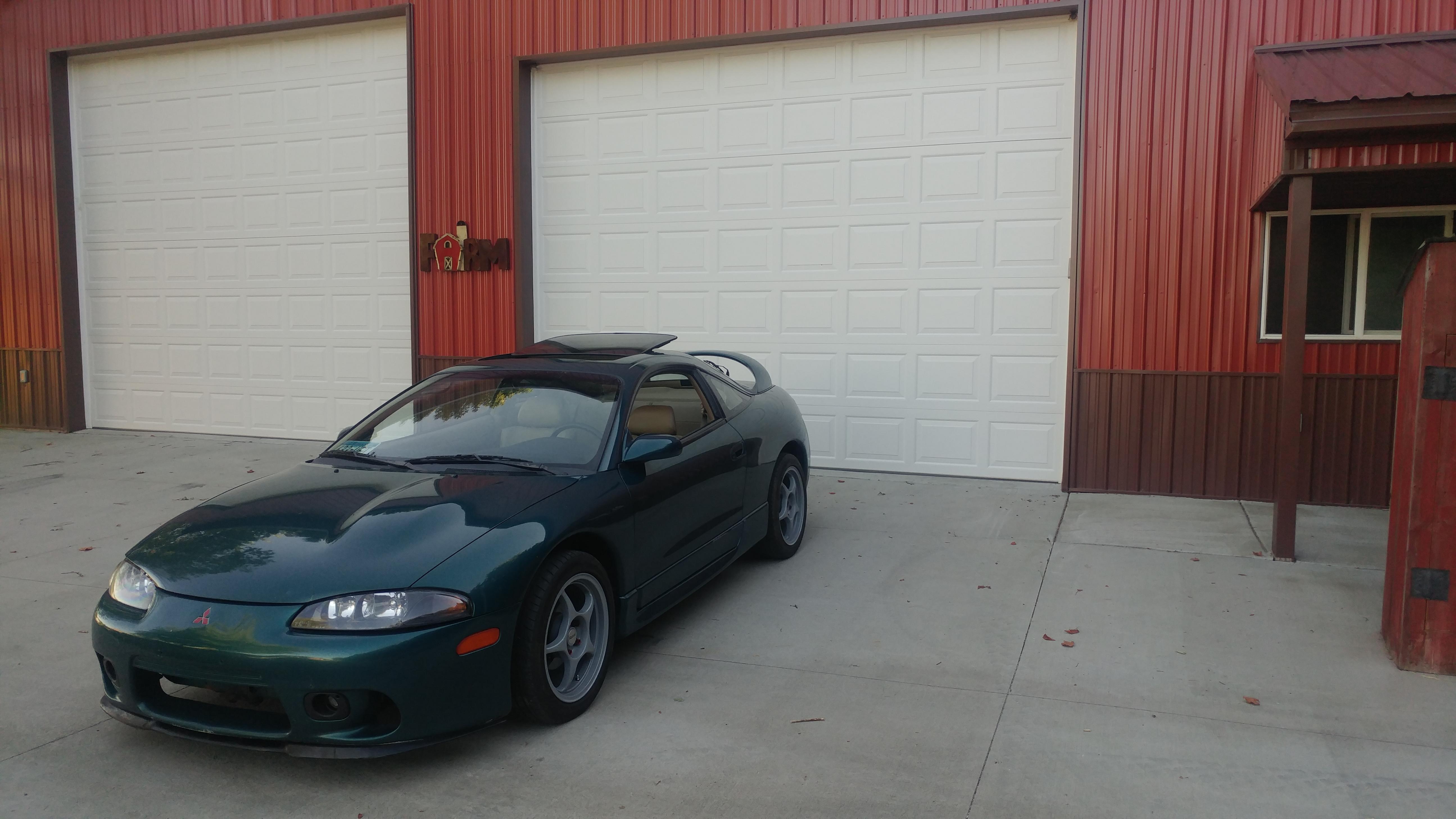

So today the girlfriend and i decided to go check out a immaculate 97 Gst 100% stock and not one spot of rust. She ended up buying it and now she has joined the dsm club. She wants to do a basic 16g setup on e85 for now and also awd swap it this winter. So itll be a fun project to get her learning more about cars and what they are about.

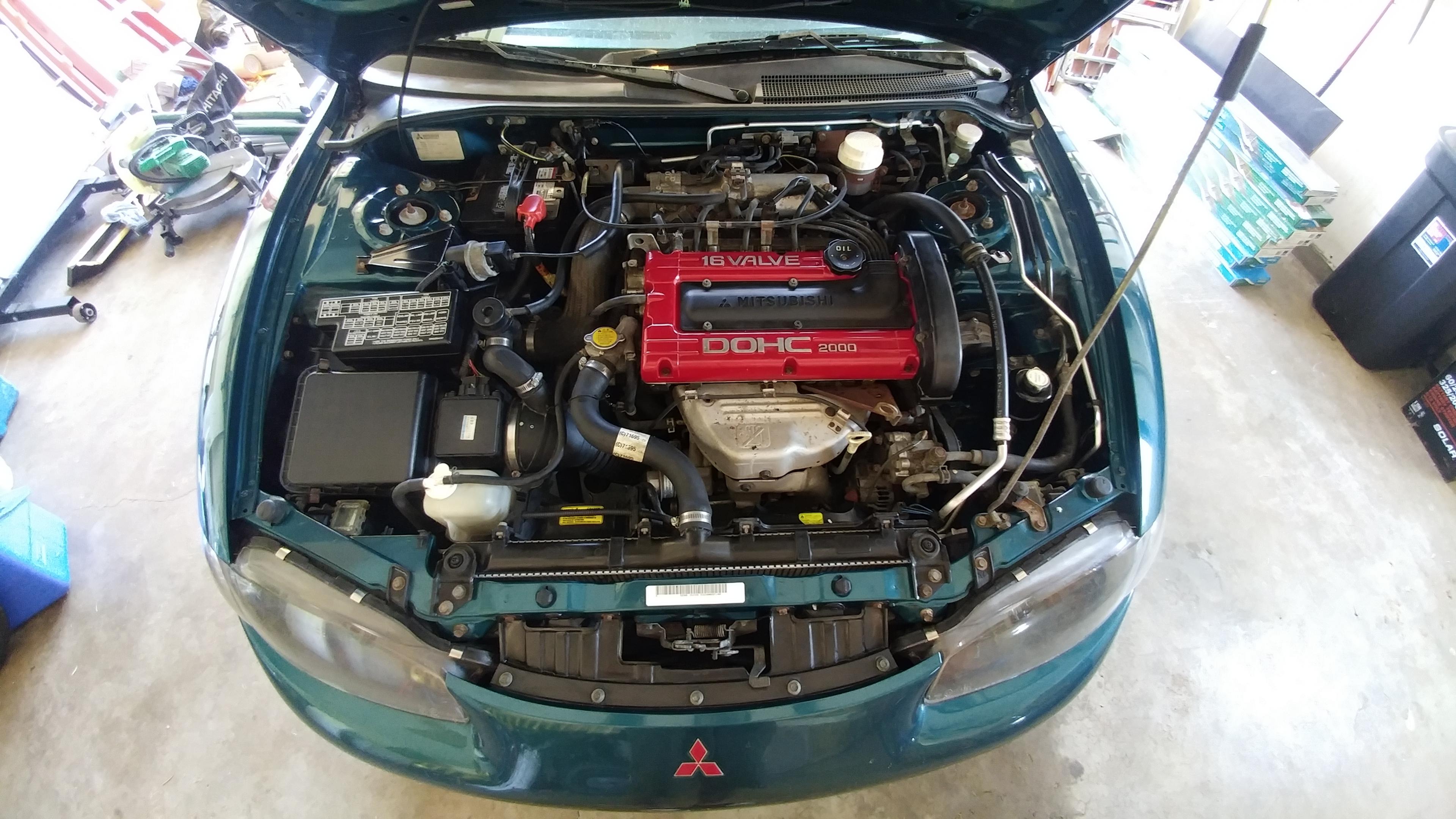

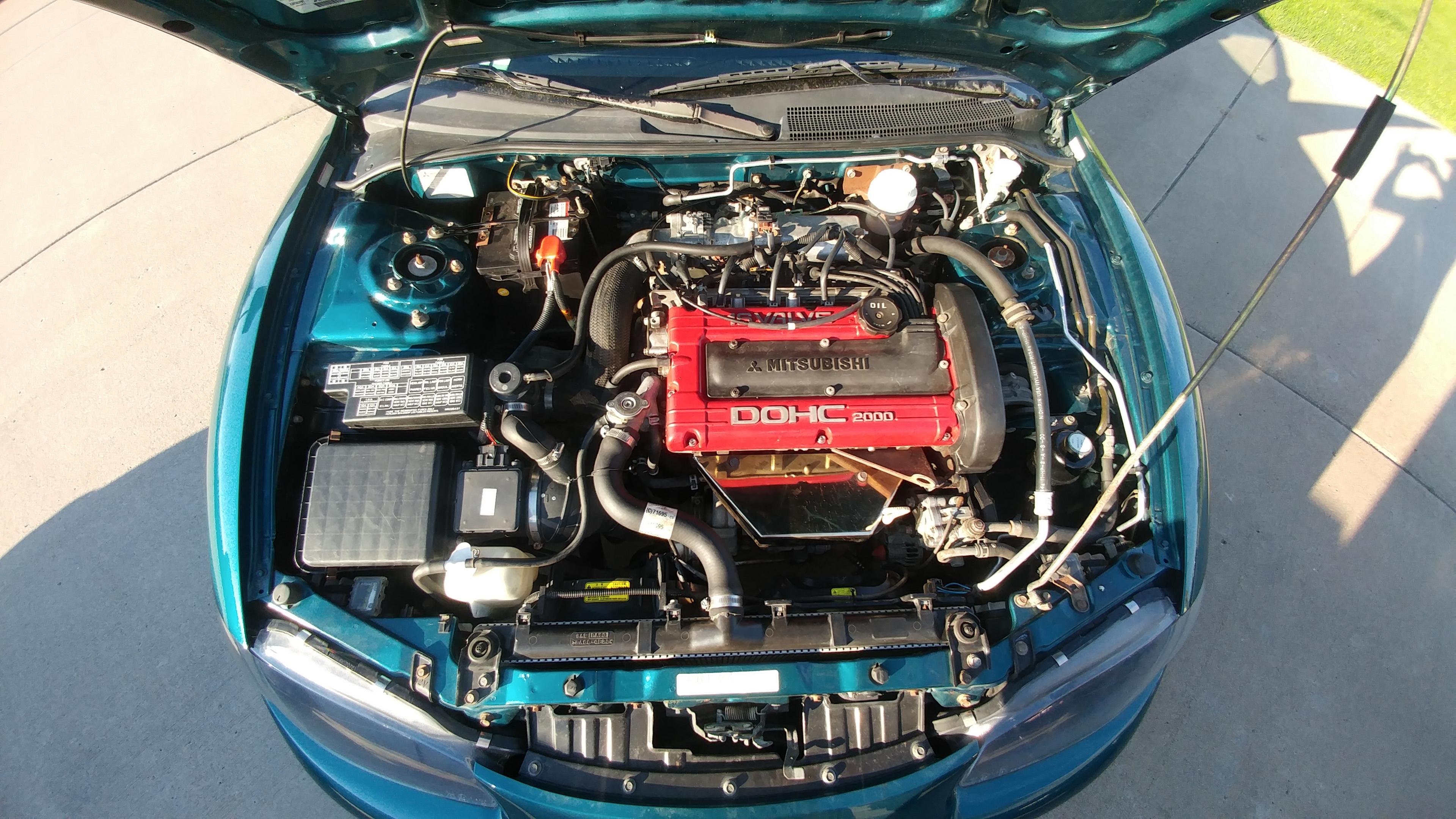

This past weekend we got some time to check over everything. Put a new valve cover gasket on since the one that was on it was leaking like crazy. Also gave the engine bay a good cleaning and it turned out like it just came off the showroom floor. Also threw my front lip that i had on my old 2g on it. More to come

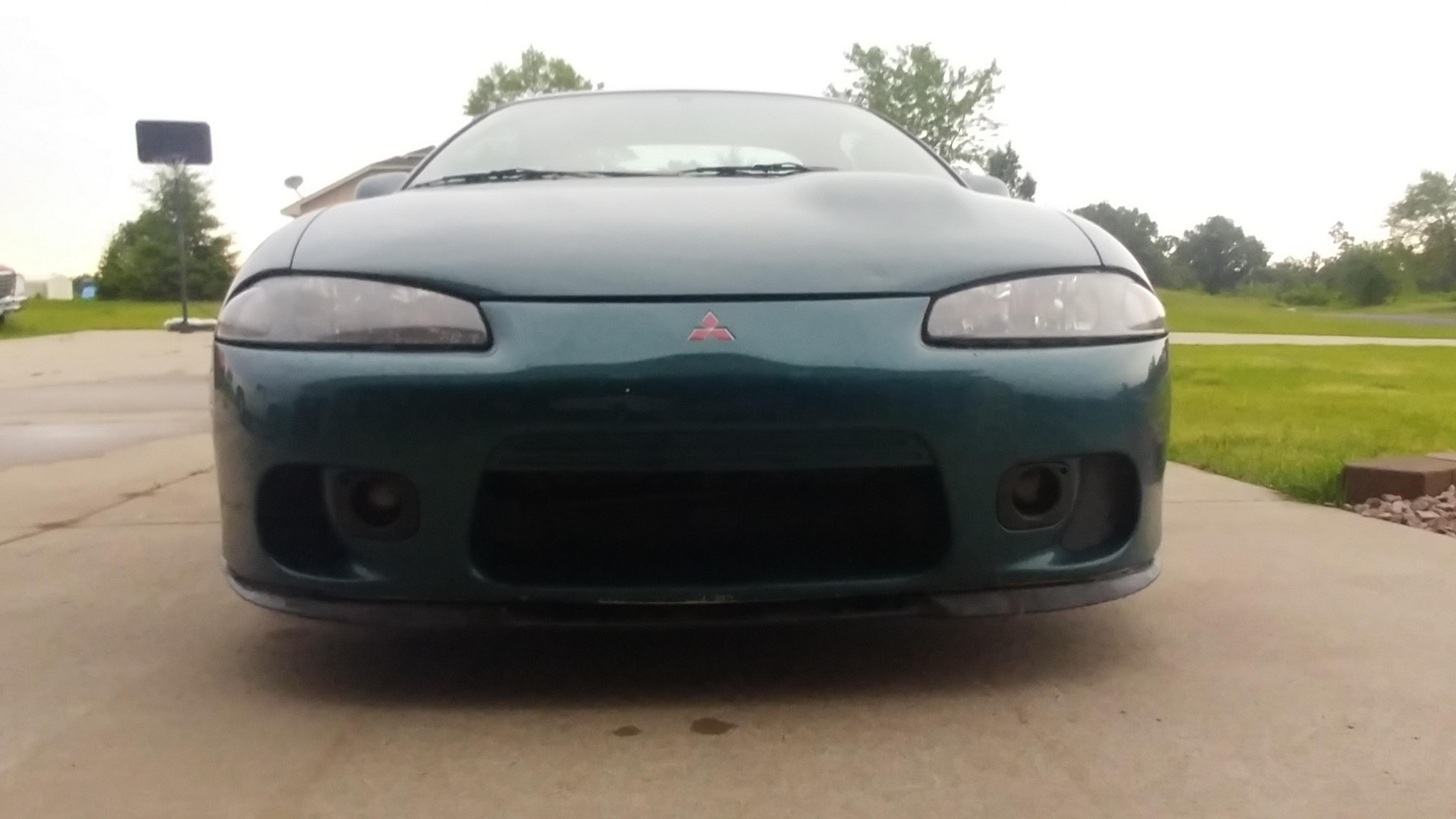

Update : Got my Enkei Rp01 wheels sandblasted and powdercoated and put on the car with some new dunlop sport rt tires. Also polished heatshield installed, non cruise cable, and emissions deleted. Exhaust and coilover are next.

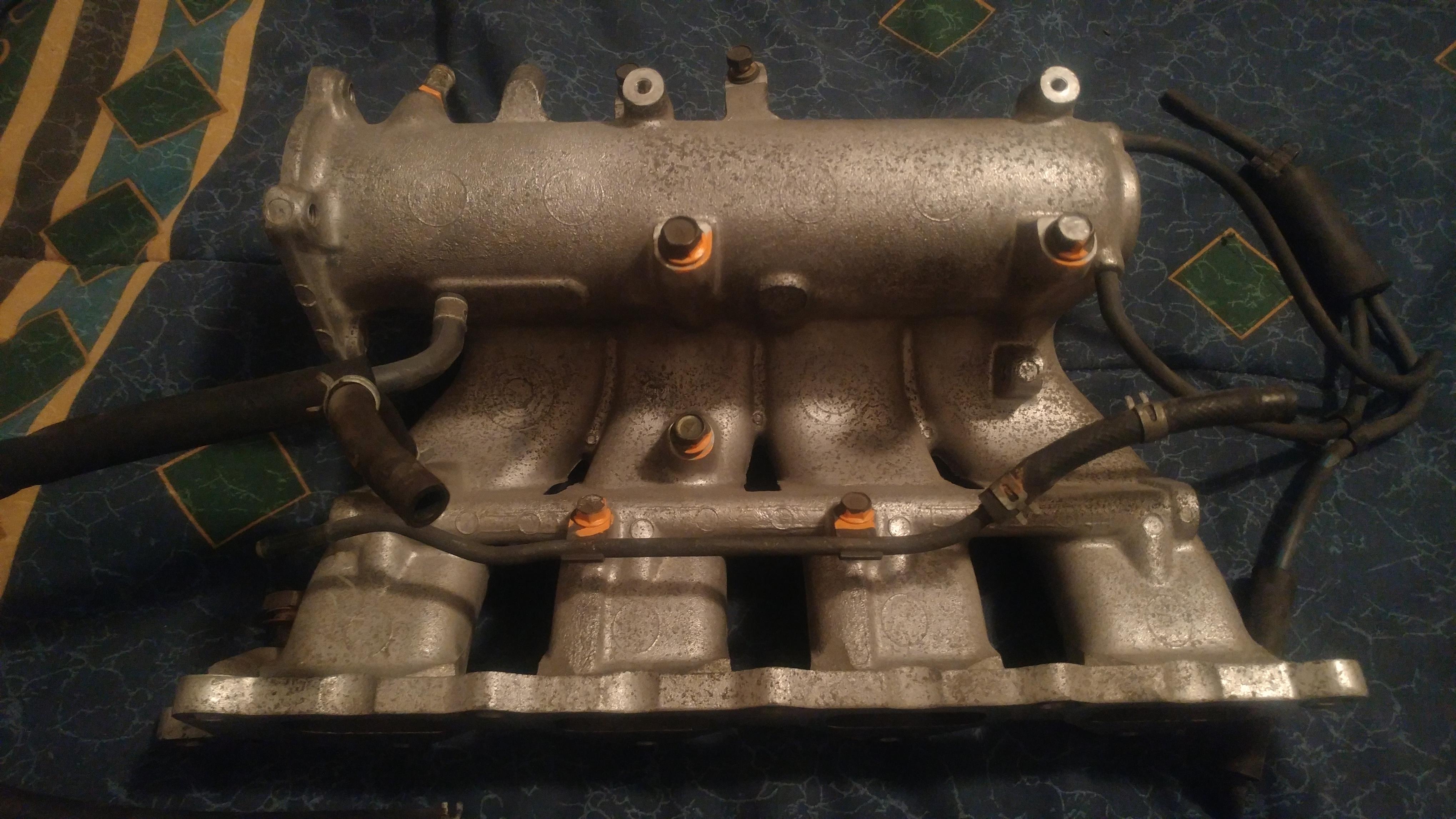

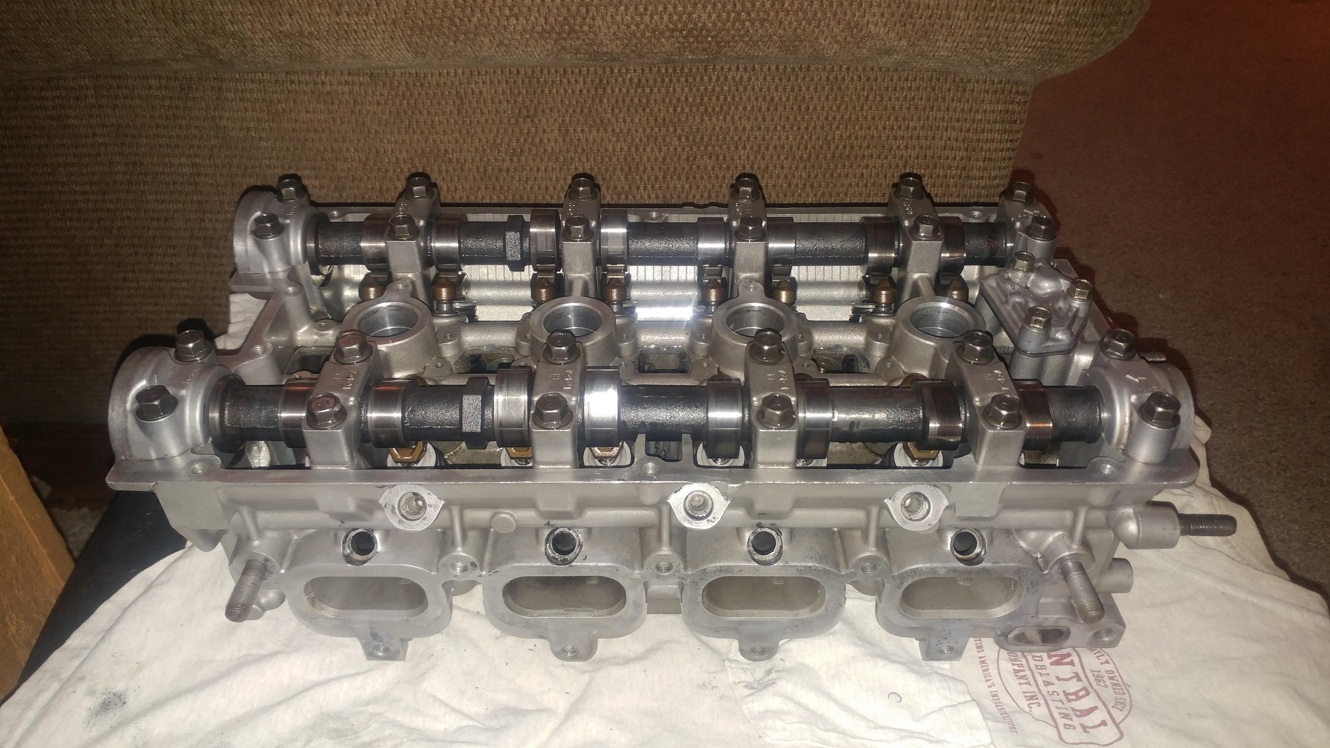

Update on the girls 2g. We recently picked up a partially built head from Mark with fp2 cams, evo spring/retainers, and a 5 angle vj. Ontop of that we got an evo3 intake, and picked up a fuel filter to rail kit with a fuel lab filter -6an, fuel lab fpr kit -6an from extreme psi. More pics to come.

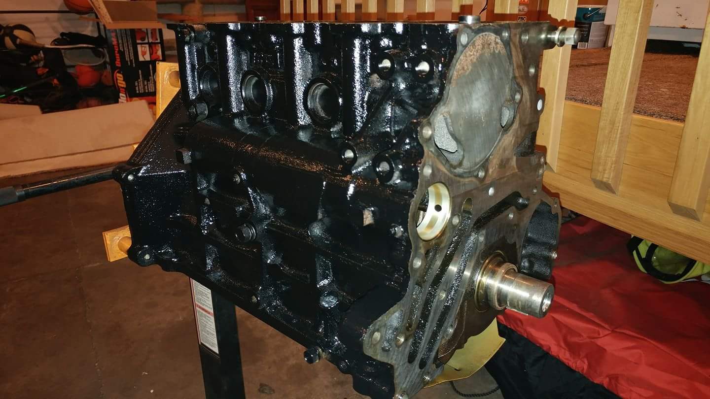

Little update. Fuel stuff is arriving today. Also last night we got her shortblock and trans painted. Next we will be getting her new front case on with a bse and then we will be able to get the head bolted on and timing done.

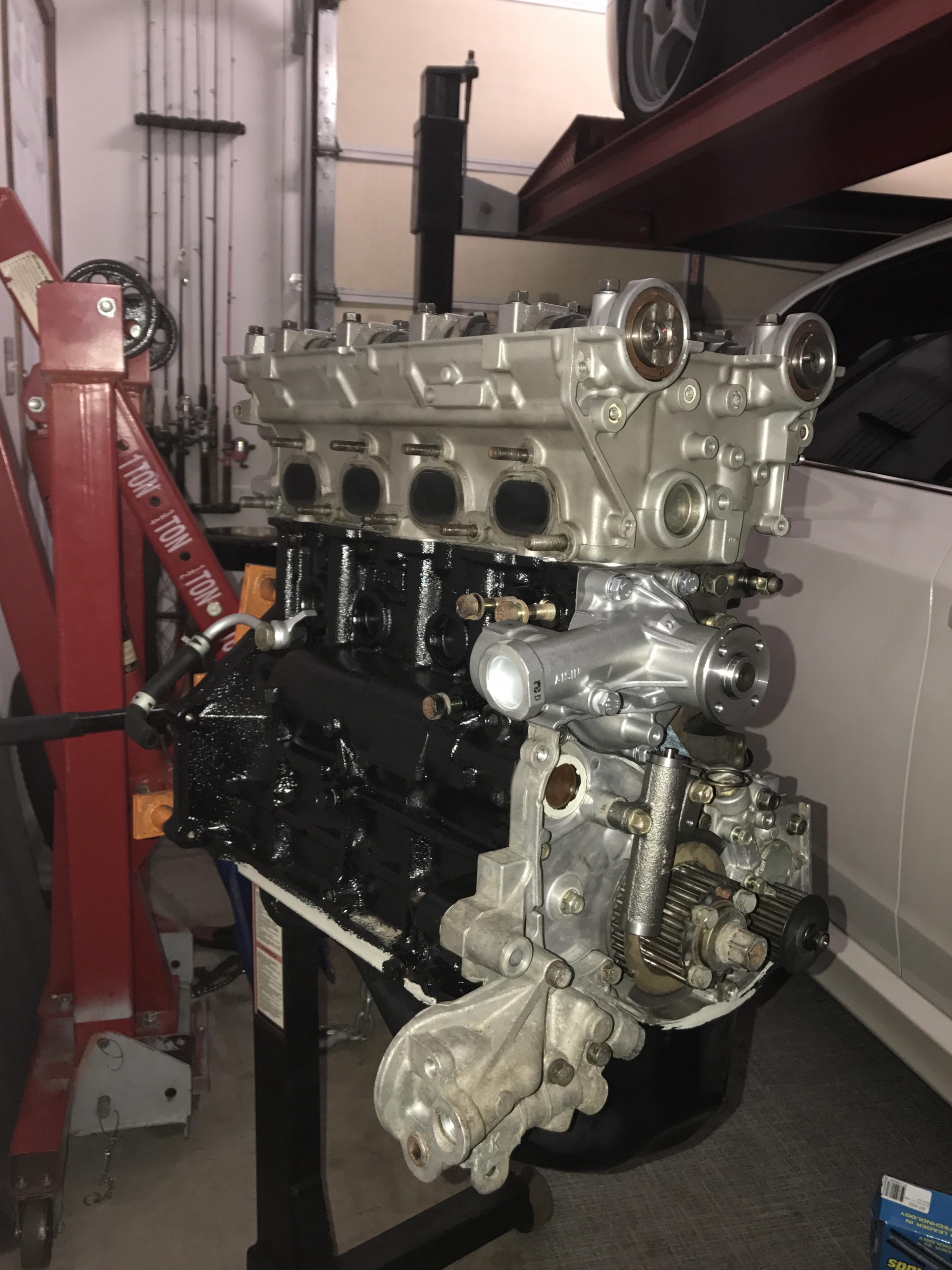

Tonight we got alot done on the girlfriends engine. Front case / ofh torqued down, new oem oil pickup, oil pan bolted on, new oem water pump, built head torqued down with a oem mls headgasket and arp headstuds. Next will be timing then getting the turbo all bolted up along with the intake. More to come
