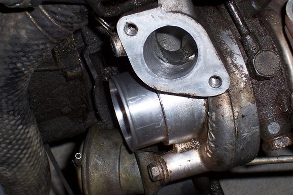

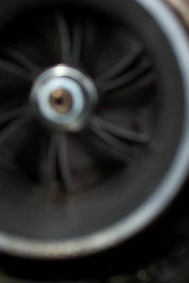

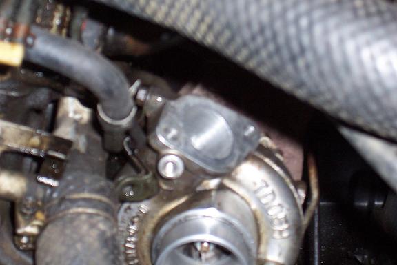

I want to buy an EvoIII 16G but this guy doesnt know what one it is cuz it just came on his car. Can you tell by these pics?

14B would be my only guess since I fell off the chair looking at the pictures.

HAHA I didnt even know they were that big. WOW. They are resized now. Also It has a 2 fin piston doesnt that make it a 16G?

Two fins is usually at least a 16G.
If you can get to the turbine outlet the EVO is 2.5 inches where the big 16G is 2 inches. That will make it sure as to which one you have.

That looks like a 16G to me but I dont know if its the small or big or evo...

There is a 3-digit number stamped on compressor housing, on the opposite side of the TDO5H stamp that designates what it is. After the 49178-0 code is stamp.
420 - Big 16G
520 - Small 16G
1470 - Evo III 16G
google this & you'll find some more info
