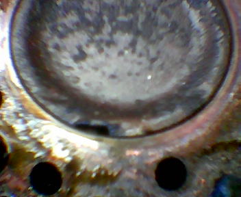

It was the bottom end. Take a look at this picture taken when we pulled the head. The side of the piston looked melted and all 3 rings were gone in that spot.

ooh damn! ouch! Tough luck man. Time for something more tough!
