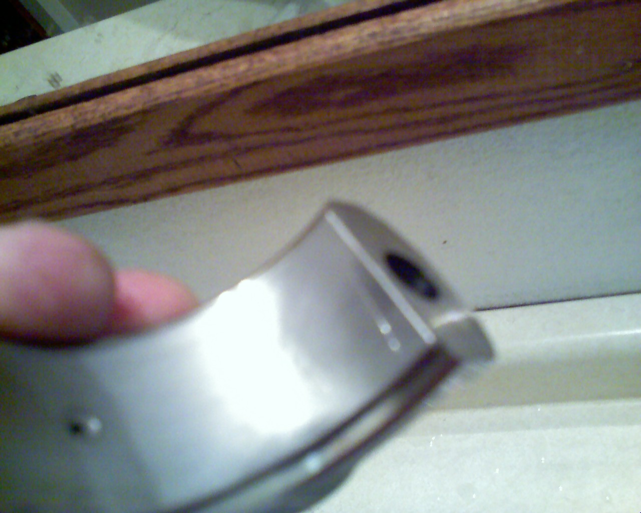

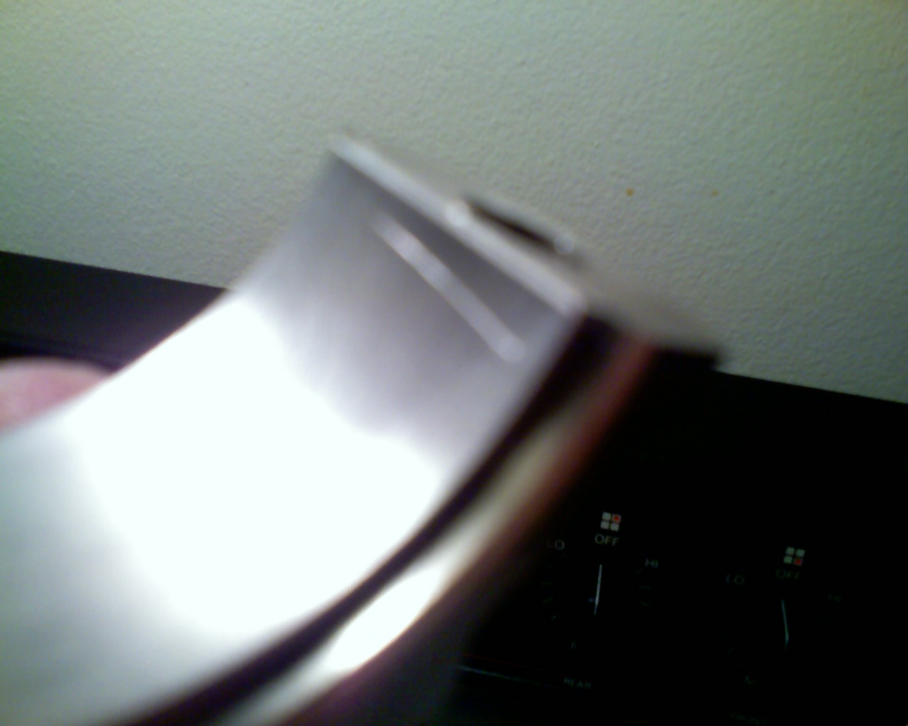

Well I put the bearings on the rods tonight. One of the bearings in the package was pressed into another one. Almost as if a bearing was pressed into a rod cap. Had a heck of a time pulling them apart. When I pulled them apart, I noticed a small scratch. It's not very deep at all. You can just barely feel it with your finger nail. I went directly over it a few swipes with some 800 grit and then cleaned with brake cleaner.
I'll attach some pictures. Does anyone think this is ok to run?
Thanks.

Well I'm getting new bearings from extremepsi. I volunteerd to pay for 2nd day shipping. I'm sending these back under warranty so they can get credited from ACL. It was ACL's fault. When they bagged it and heat shrink wrapped it, it pressed one bearing into another tightly. Since the scratch had no sharp edges on it, I'm sure it would have never hurt the crank. In thinking though, I thought the scratch might be a deposit area for contaminets to build up. For the sake of $16 shipping, I didn't feel it was worth risking the time and $$$ i put into the project.

If they are not perfect i would have sent them back without a second thought, you have to remember your clearance is going to be about a thousandth of an inch so even the slightest scratch could cause damage to the crank, you want everything as clean as possible and as smooth as possible.

It's hard to tell by the pics, but you probably could've sanded that out. Cleaning the edges with a little sandpaper and cleaning is a good idea. I always had to do that to my clevites, I didn't now that I switched to ACL's.
