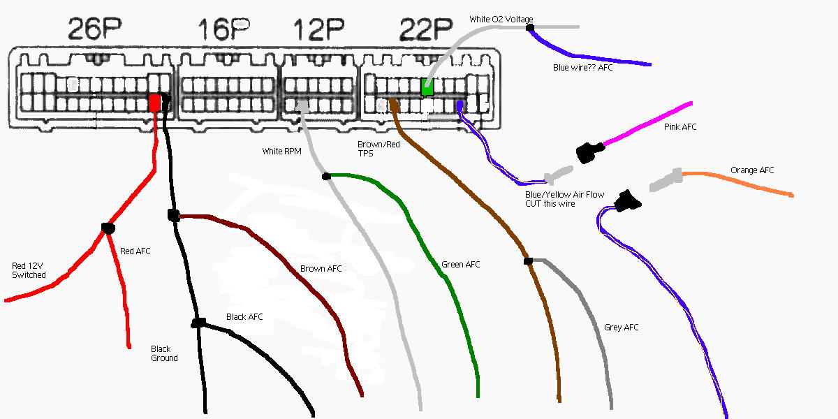

Old 07-28-2007   #6
Re: SAFC Installation Issues
Is the blue screen version or a dials version.
Here are some instructions I made a long time ago for the old boxey blue screen version into a 2G.

Old 07-29-2007   #7
clean2g
Boost Junkie
clean2g's Avatar
Join Date: Apr 2005
Drives: I teleport
Posts: 586
It's the old boxey blue screen version. Ah, ok yea, that's the diagram I followed initially which I got from you way back when I installed my a/f gauge, but I guess I didn't get the full picture so I didn't see the orange wire. Thanks Shane.
