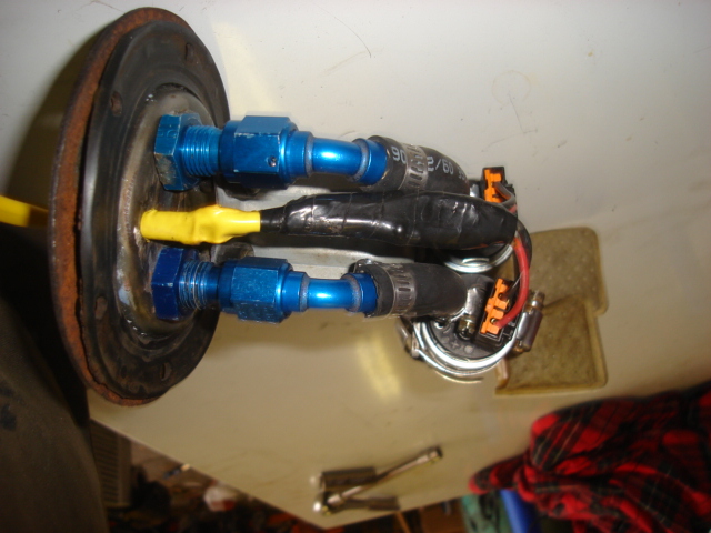

series is one inline pushed by an intank. paralle is 2 intanks Y-ed together.
Series will give you more flow at higher pressure parallel will give you more flow.
If I were you id try to find a fuel pump housing and mock it all up so you can keep your car together while you figure out the duals.

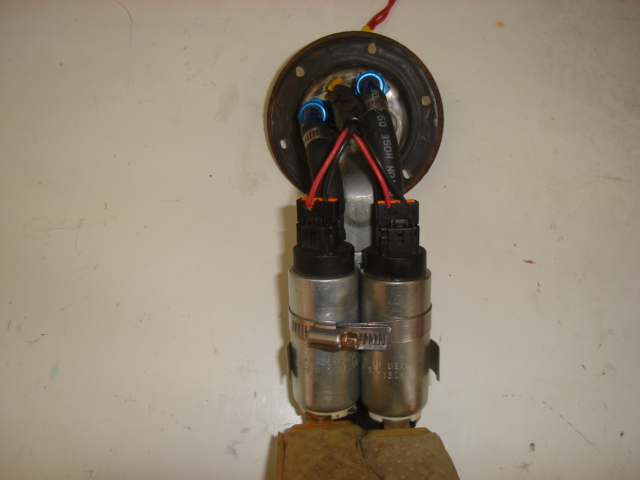

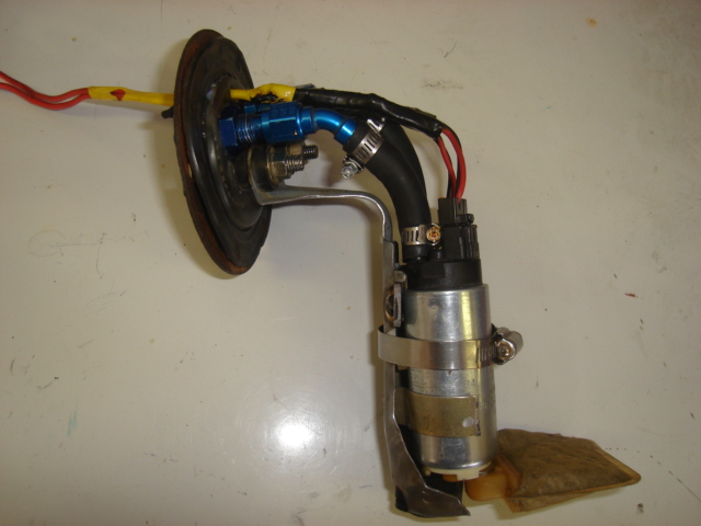

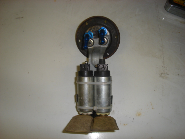

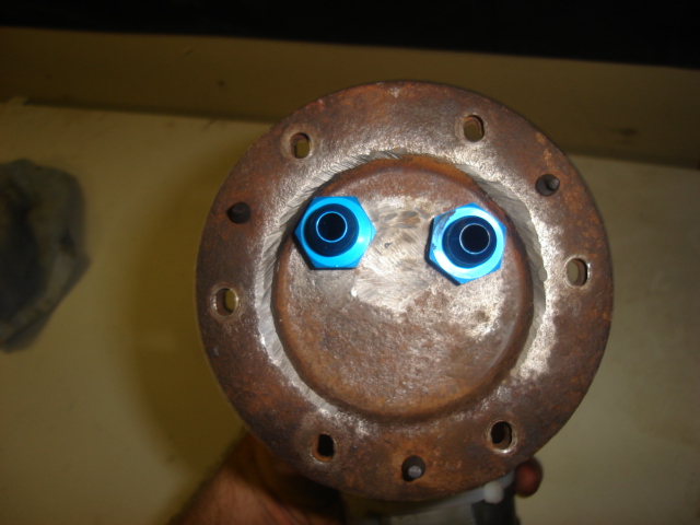

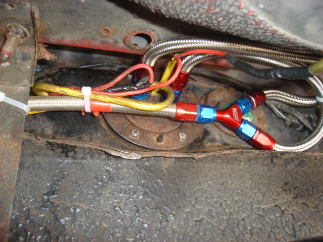

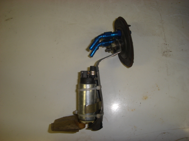

Heres some pics of how my dual intank parallel pumps went together mines FWD so Its a little different but it will give you an Idea.

Damn 1Gs are soo much easier. I looked into this as well but on a 2G there is not alot of room. But if I had $450 a could go buy this http://www.fullblownmotorsports.net/...products_id=39
http://www.dsmtalk.com/forums/showth...43#post1732643
I just purchased another fuel sending unit and have like 3 walbro 255s so I think I might try and see If I cant make it work.
