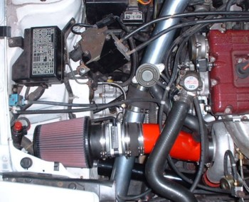

no, the blowthru is one of the options you could do. this is clearly on the intake and it is dumping back into the intake with the GM MAF.

A Ramchargers MAF-Translator can be used as either a pull-through or a blow-through setup. Which you choose to use should be based off a few different things. If you must blow-off to get the 15 year-old hunnies, then you will want to go blow-through. If you want a car that is easier to tune and idles better, go pull-through. Most cars should go pull-through; the ones making a large amount of power can better utilize blow-through. I personally am going blow-through this spring so that I am able to run a cold-air-intake with the air filter down inside the front bumper. I think everyone has their fair-share of research to do before stating any more "facts".
