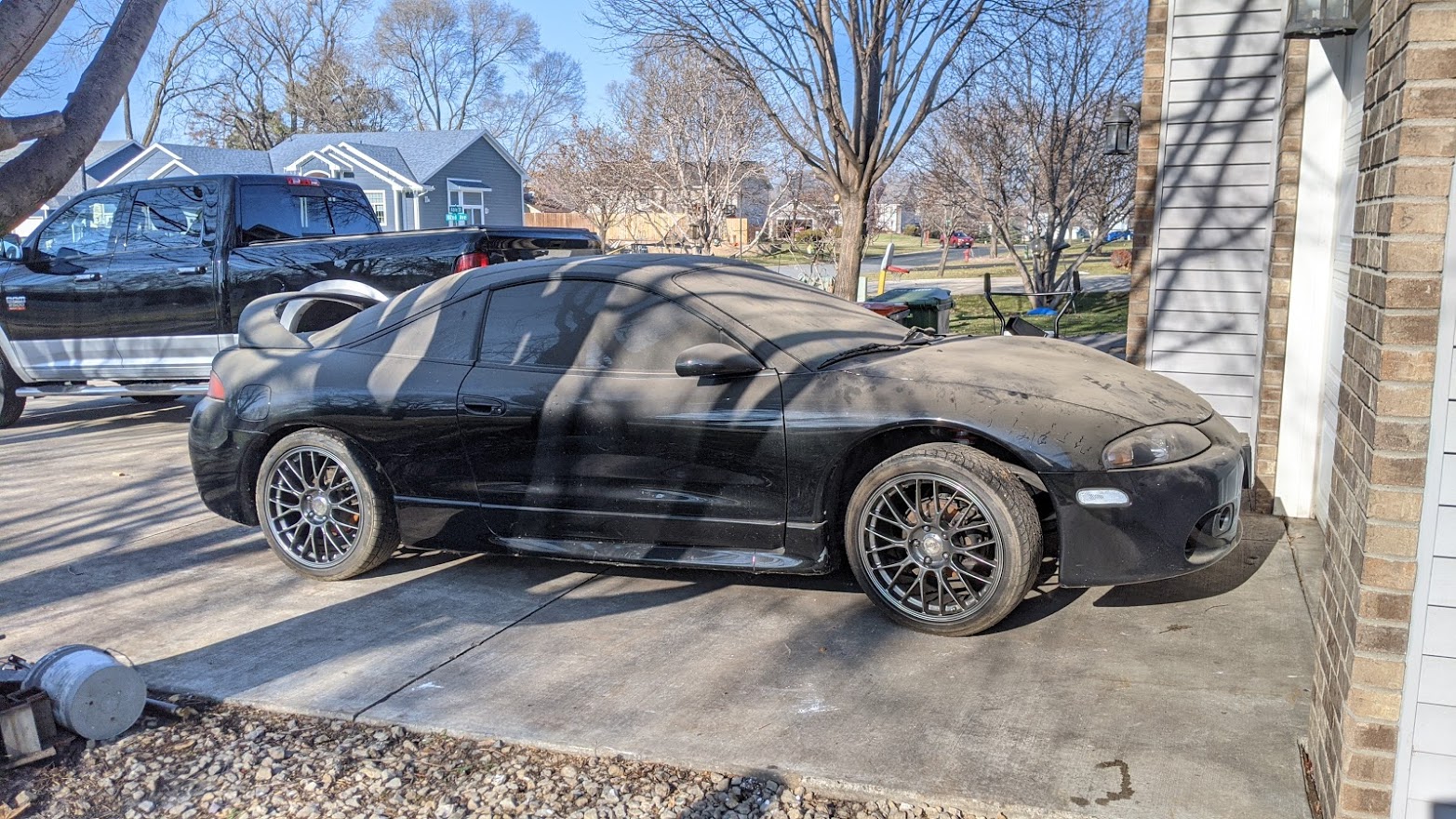

Man i have not been on here in a decade, or around the eclipse..... been sitting and waiting for time....
So need to get some work done on the engine.. Its probably easy work for all you experienced mechanics. but not for me What shop is the place to go now?
Need following..
Valve seals,
bearings+thrustwasher, it hasn't walked, its within spec, but since i have engine out i'd like to get that replaced.
new clutch and possibly new flywheel, (whats a good setup these days..
Its for a FWD) i had 2600 act before.
setup speed density with dsmlink.
and the shop to assemble the engine/trany and reinstall into the car.
That is 12 years worth of dust on it... not a spec of rust anywhere..

Still a gorgeous car!

Looks good Enes, my favorite 2G is still the 97+ with the high wing in black.

wow, that's impressive!
