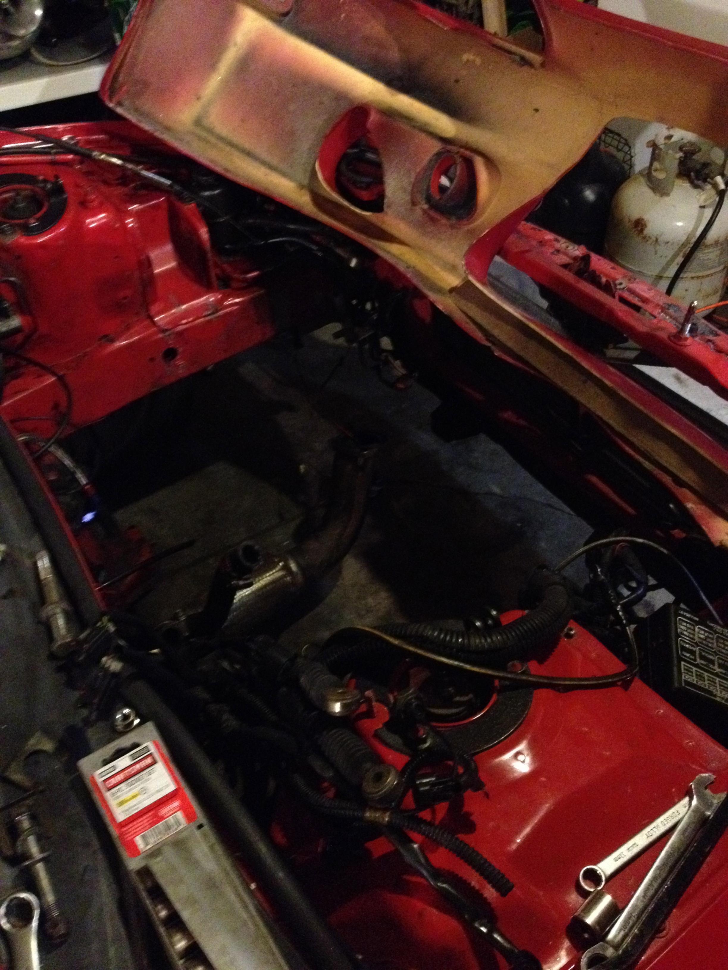

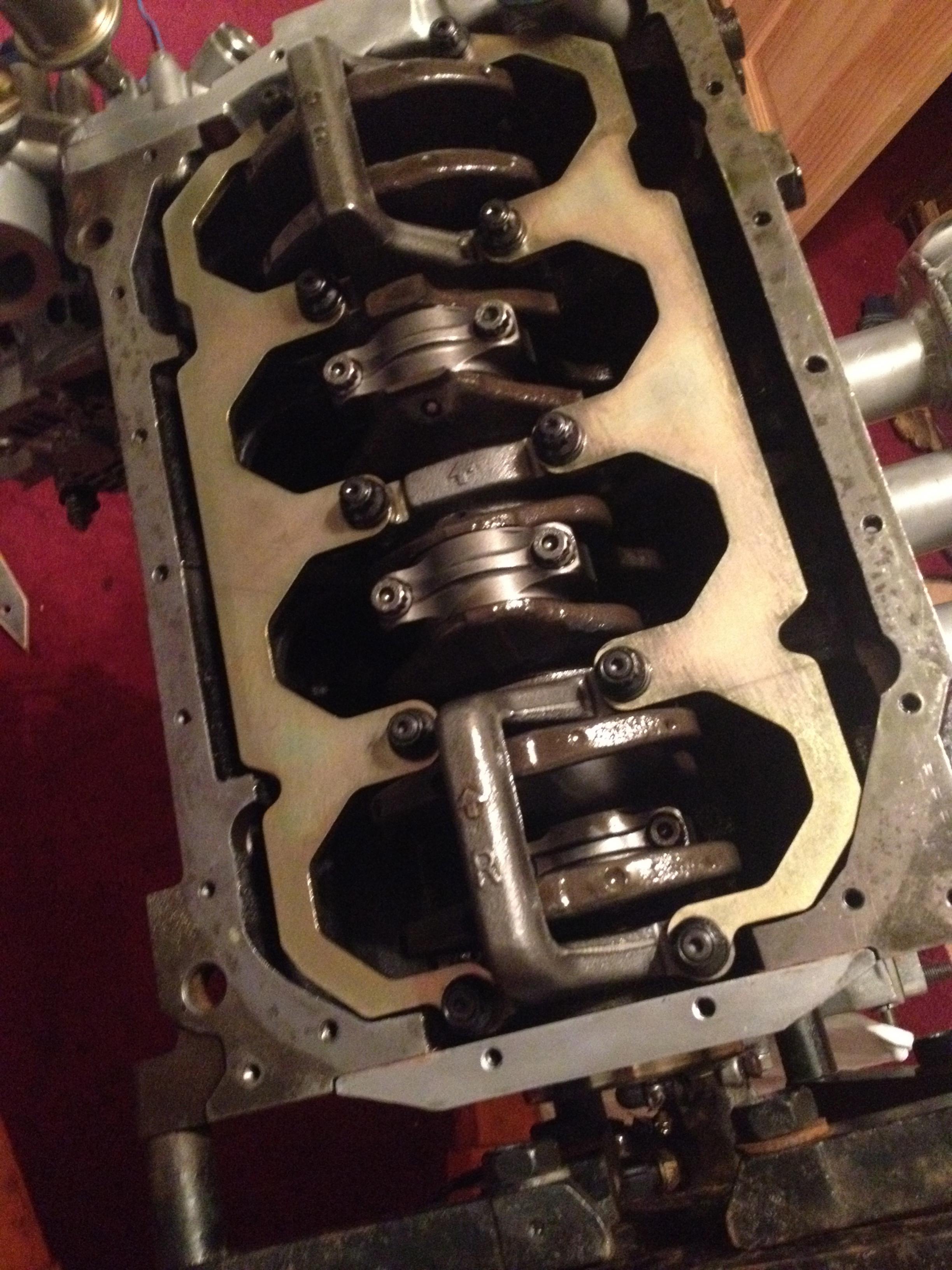

this should be a fun thread for those who want to join in. As many of you know last year I started off strong with a nice dyne session hitting 527hp 425tq db numbers. I later broke the driveshaft and rear diff out at pg1. during an oil change I realized the engine had been eating itself up. The block and crank had some pretty good wear on it so I picked up a 2.4 block and crank. and self built the engine. The engine was fantastic but I tech failed because of no battery shut off on outside of the car. so after 525 miles on the engine we start this.. engine pulled and sold

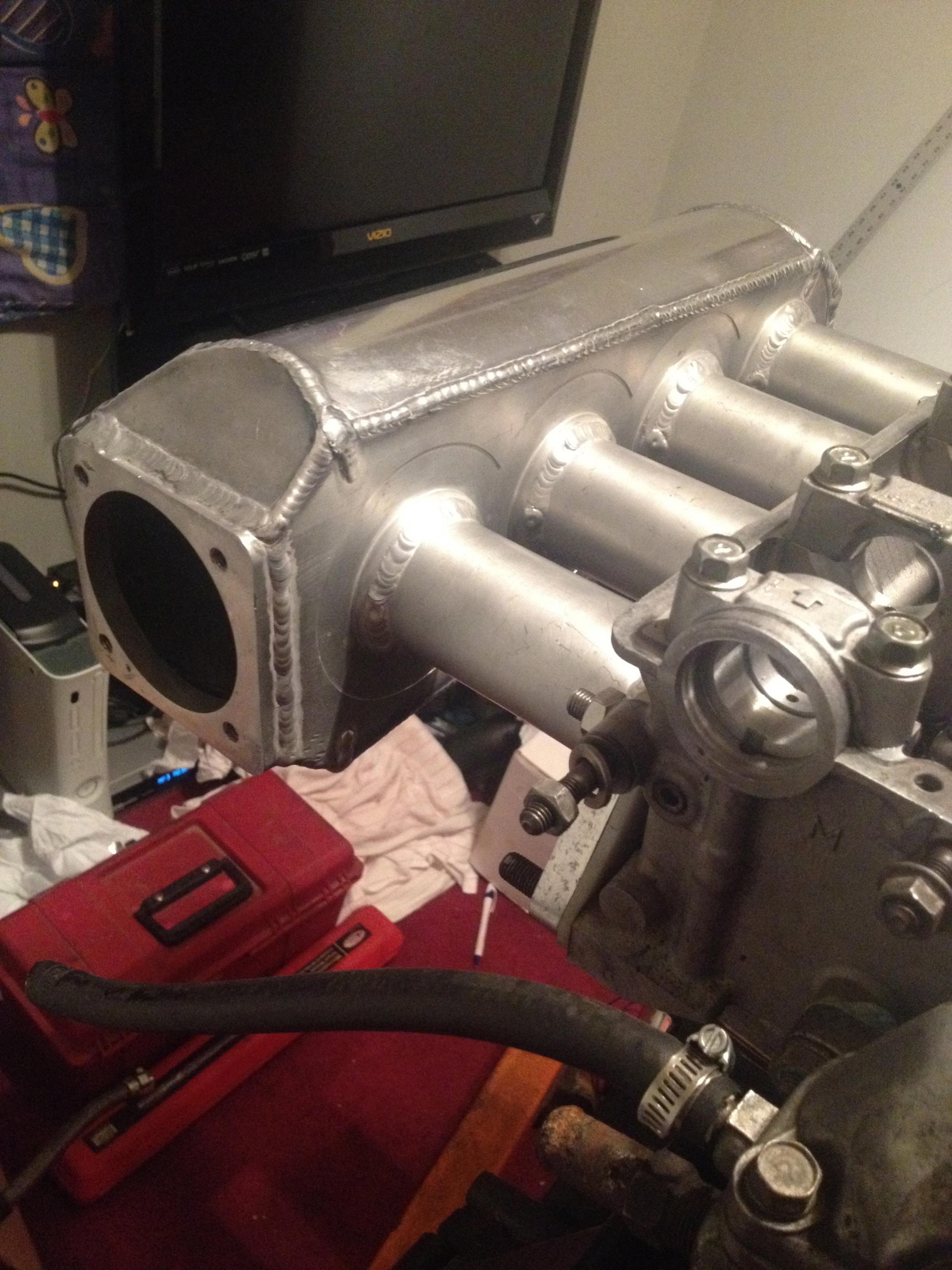

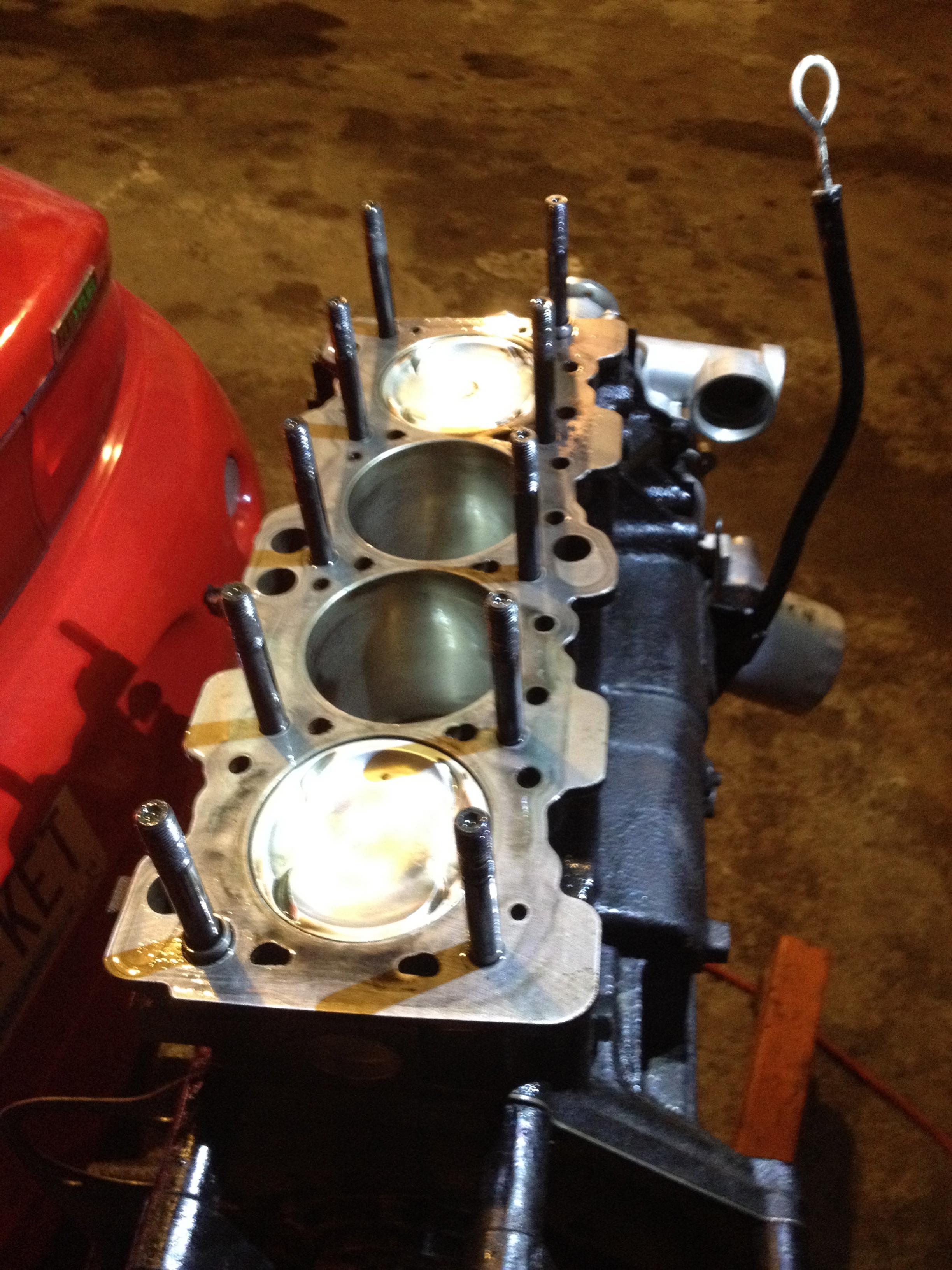

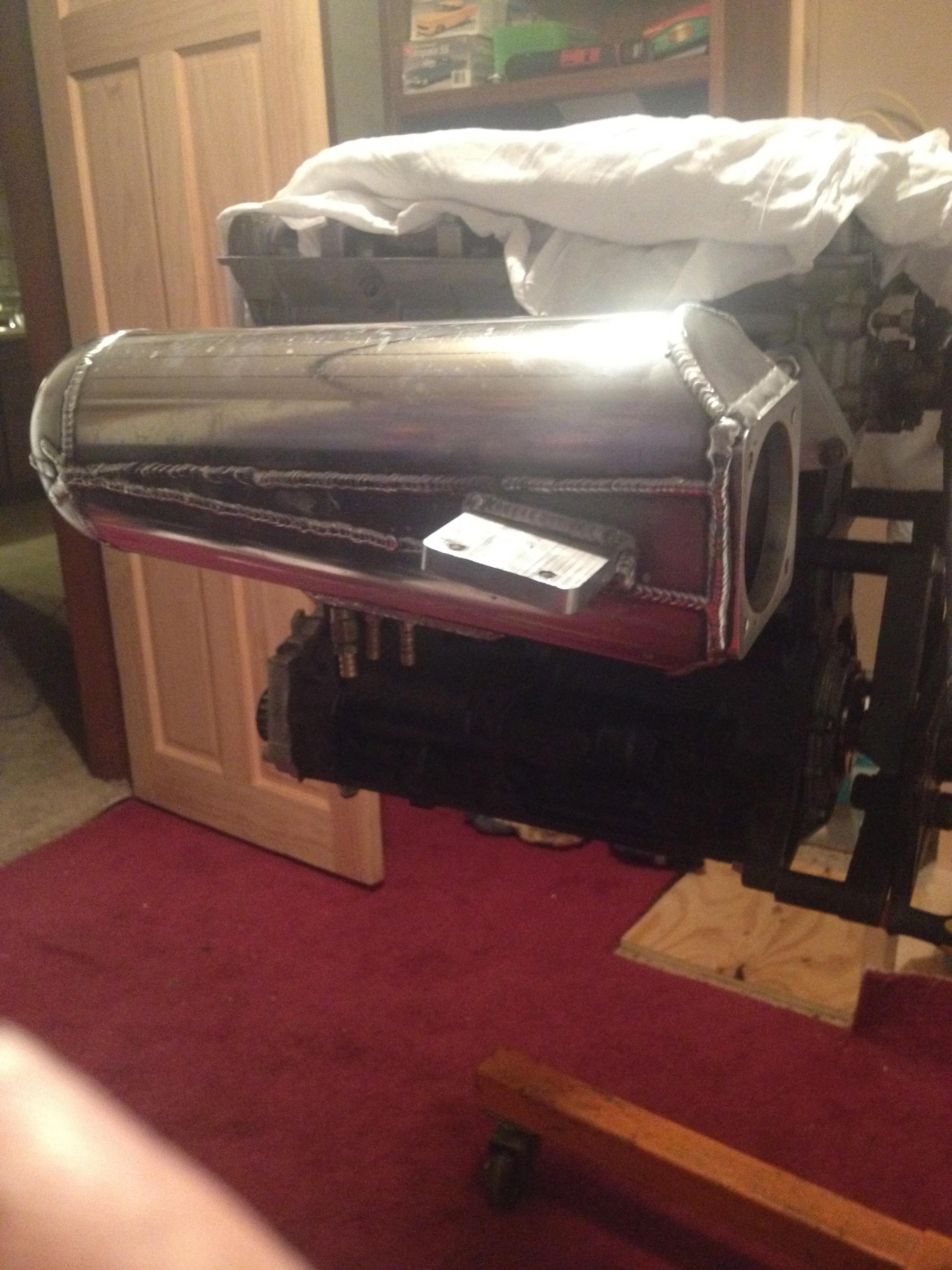

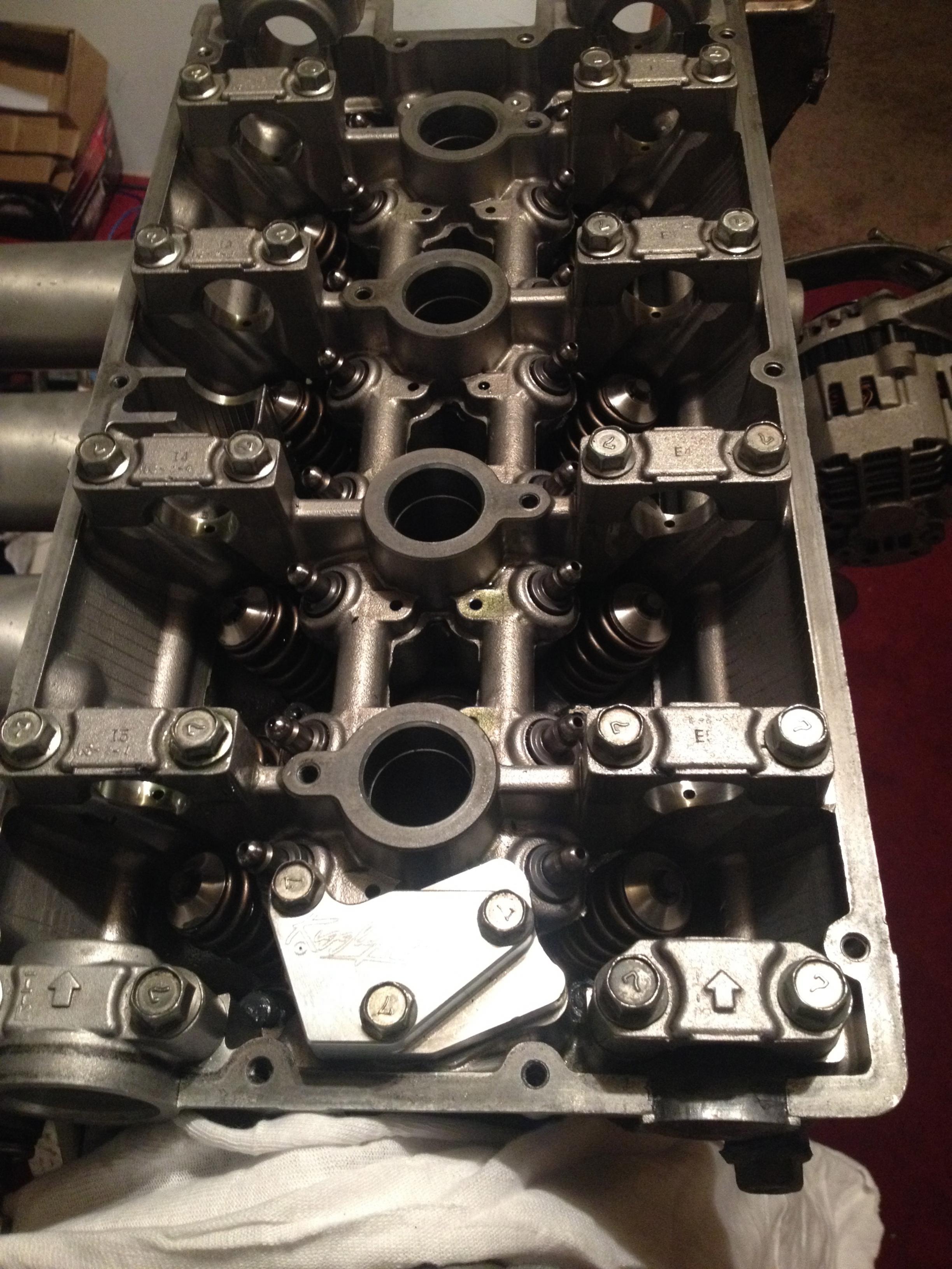

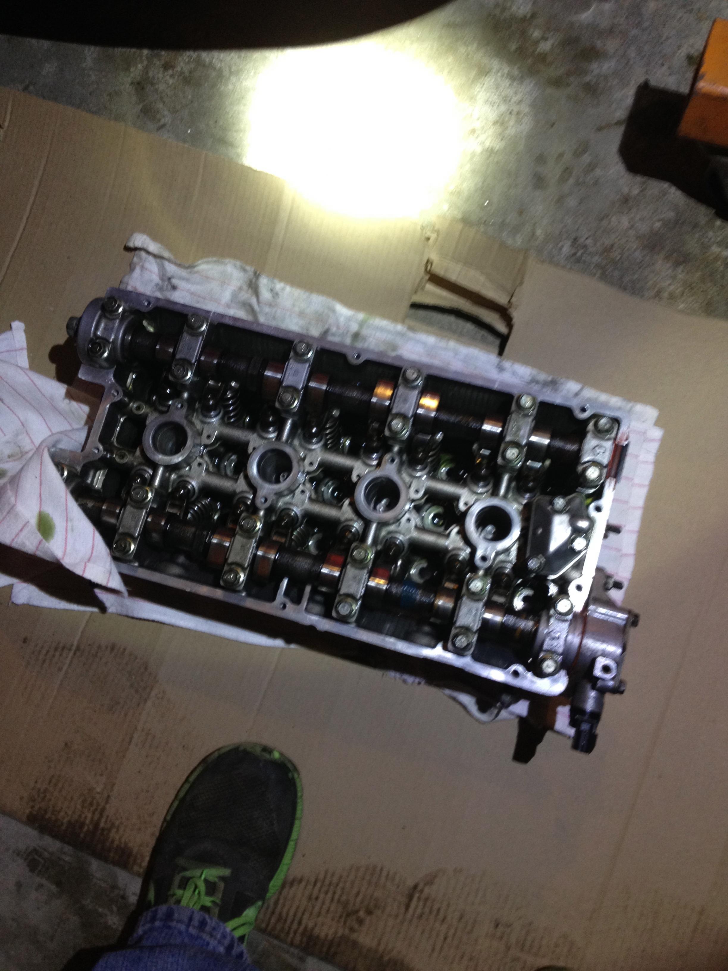

so out with the 2.4 and on to the 2.0 i picked up a pretty raged looking 2.0 block with the intention of building it up until I realized the same built I was going to do has already been done and was ready for me to pick up. Thanks to a member here I picked up a 6bolt 2.0 stock crank, manley turbo tuff I beams, wiseco e85 hd2 pistons, acl race bearings, kiggly main brace, all new and fresh. 6 bolt head with super tech ss nitrated valves, kiggly hp beehives, kiggly hla, mitsu 4 layer head gasket, l19 head studs all ready to rock besides cams. I also picked up a jmf drag mani.

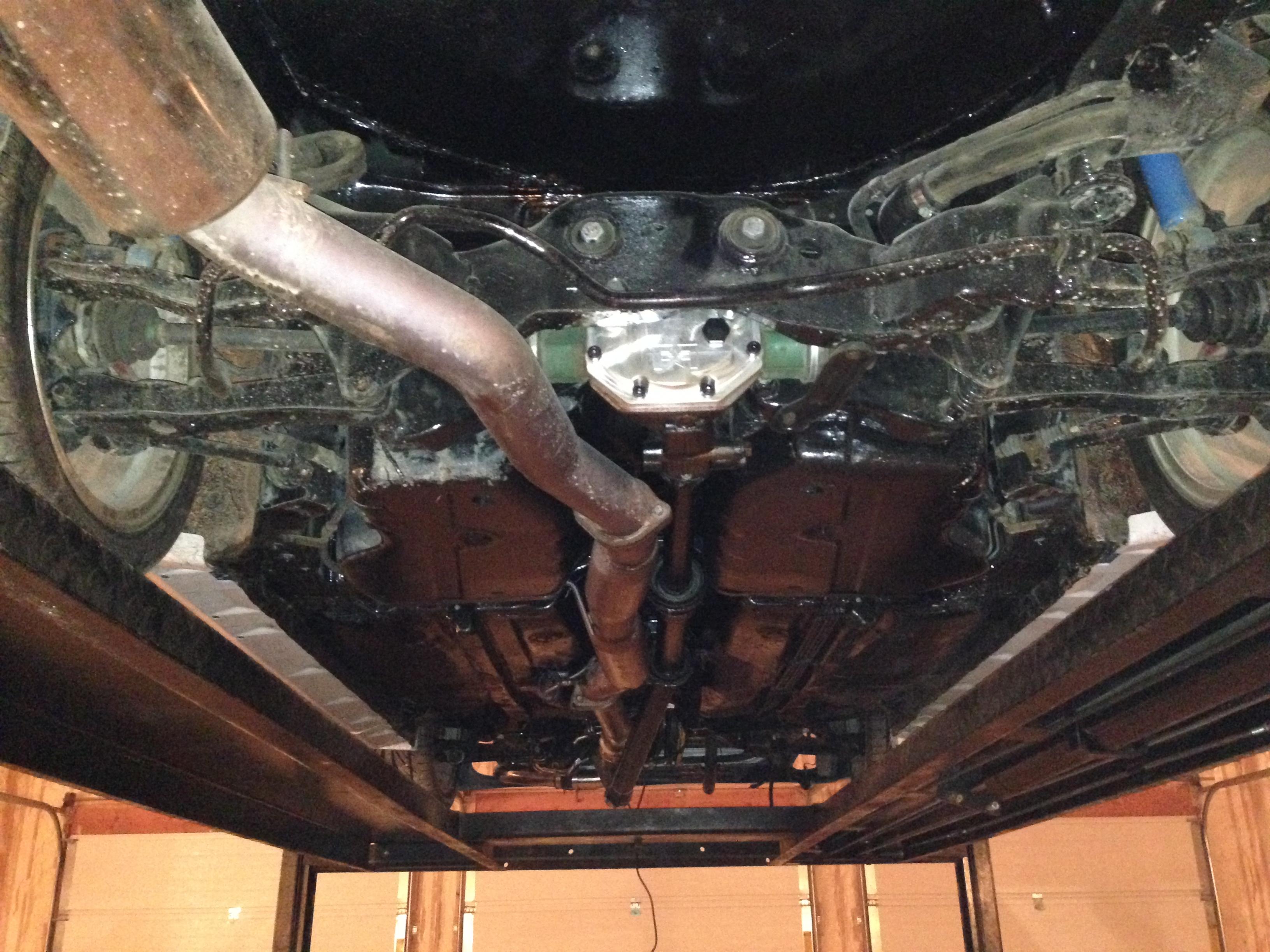

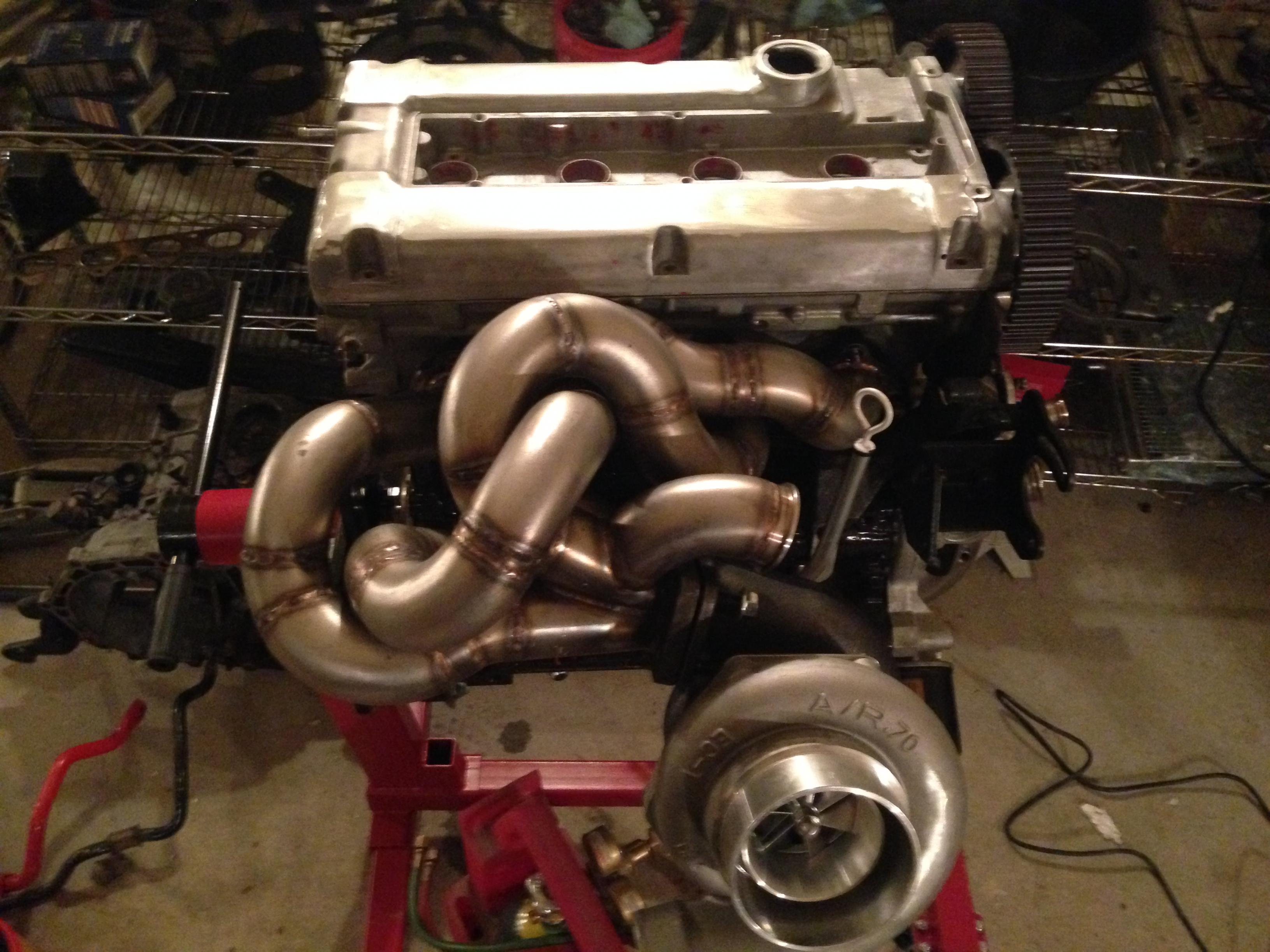

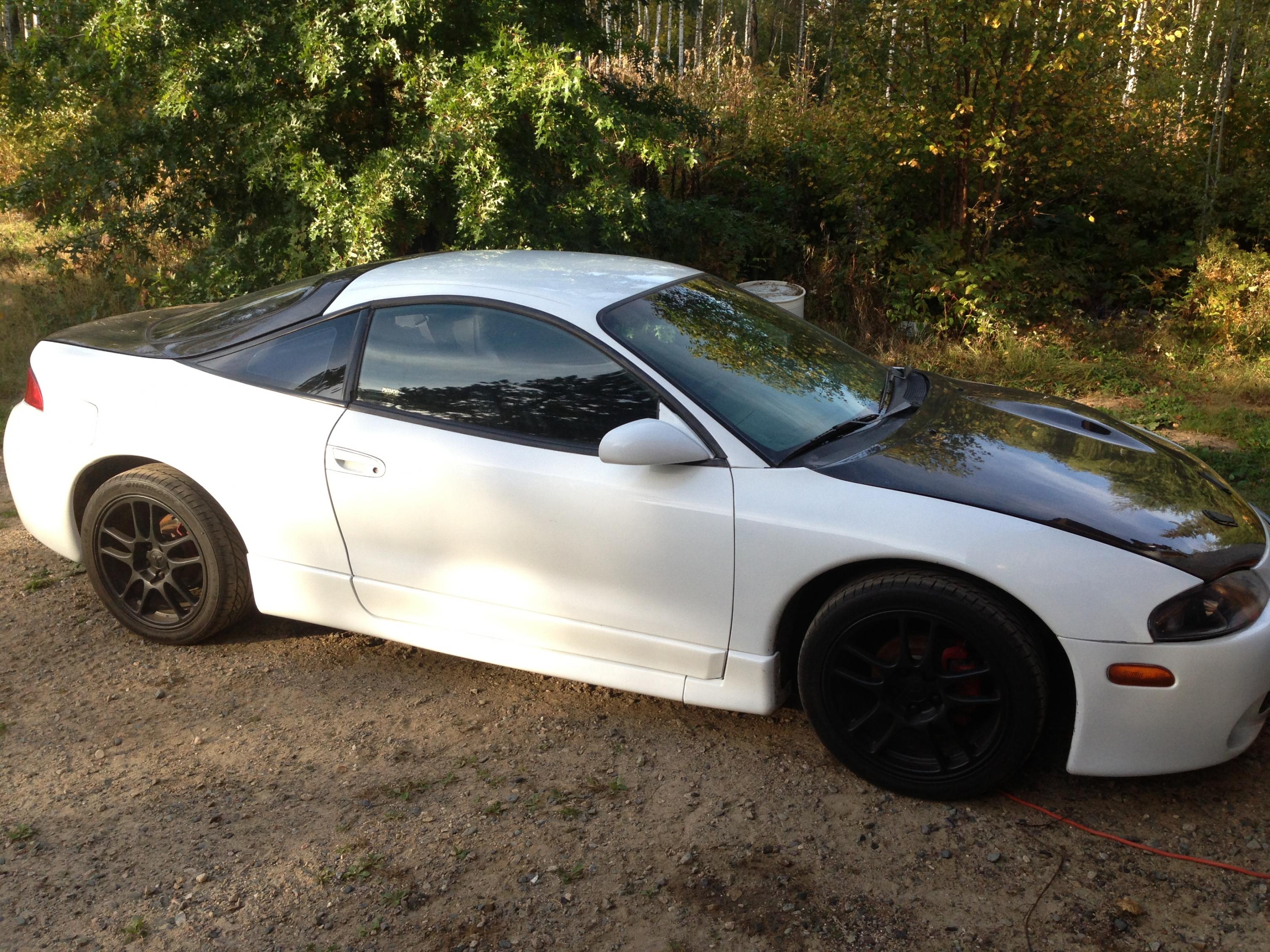

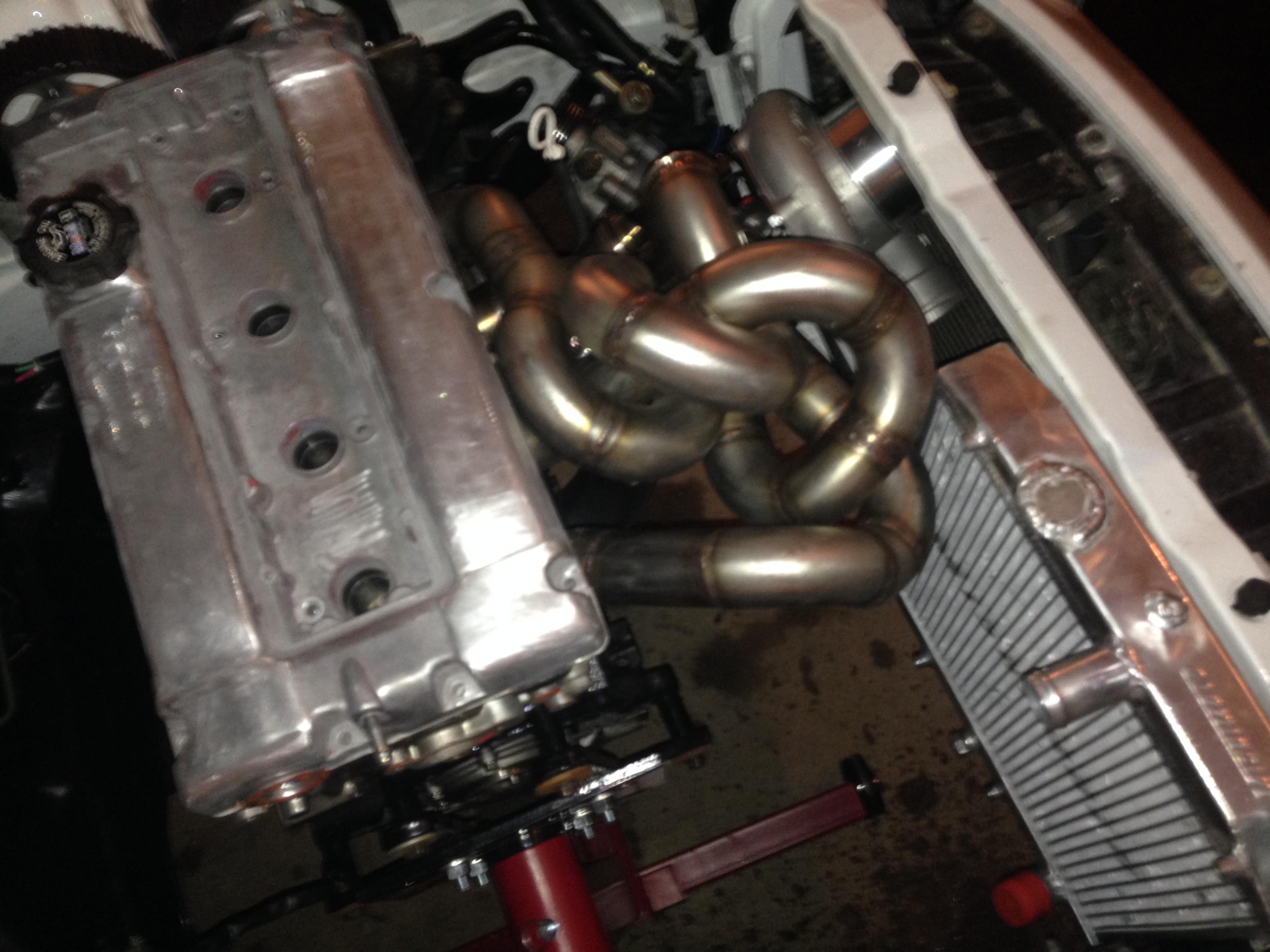

like i said team so here is andre's build so far. 6 bolt 2.0 bottom end with eagle rods and wiseco pistons. this year it will have a kiggly main brace and just freshened up etc. 2g head with bc duals ferrea stainless valves kiggly hla, kelford 272, l19. custom painted by andre wicked white car with carbon hood and hatch with speed glass. under car has all been blasted and coated. ff rear diff cover. this year forward facing manifold with a hta3786. oh yeah that pic on the lift is in his garage at home. baller status

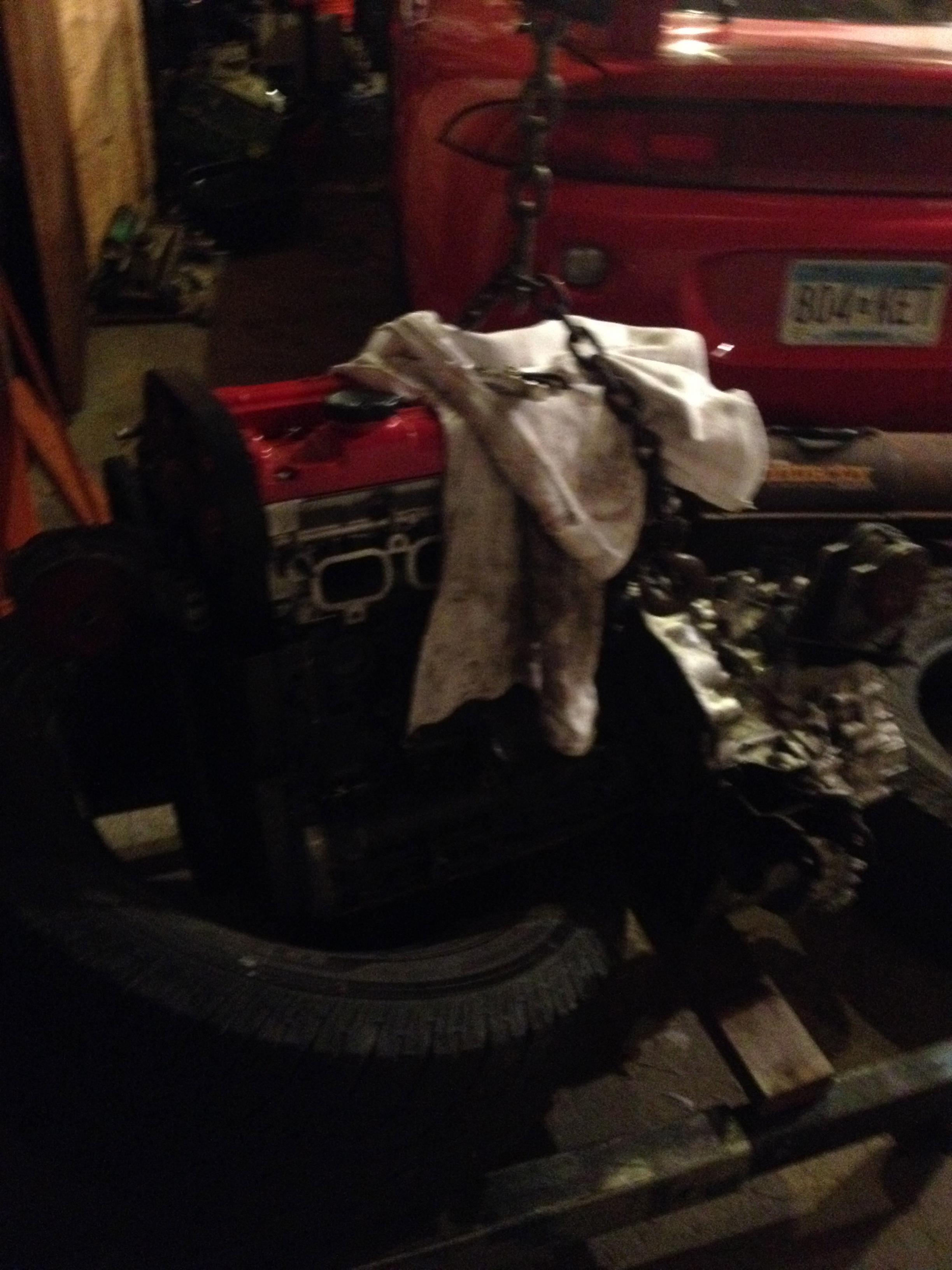

Here are some pics of the pg trip mine is the red 2gb carbon hood
