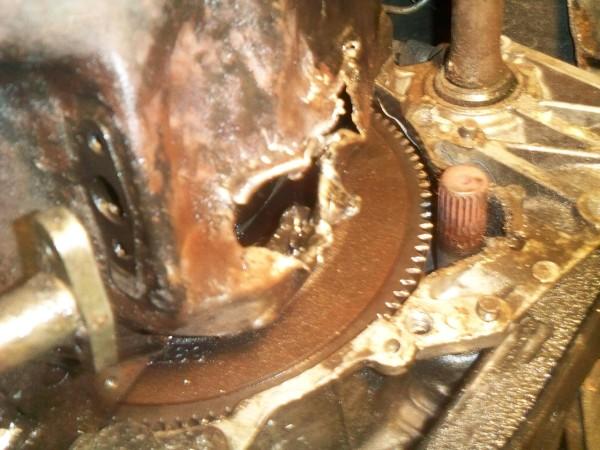

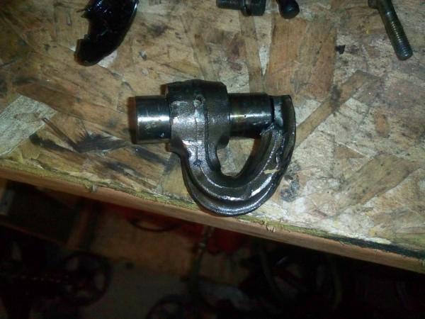

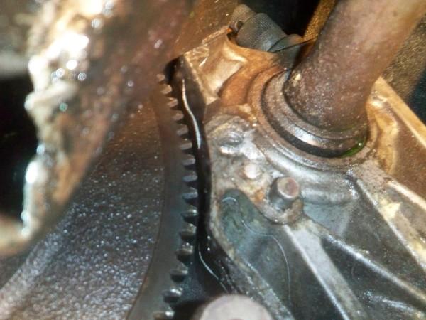

Here is some pictures of the destroyed 7 bolt some people have seen this some haven't enjoy thanks for looking
