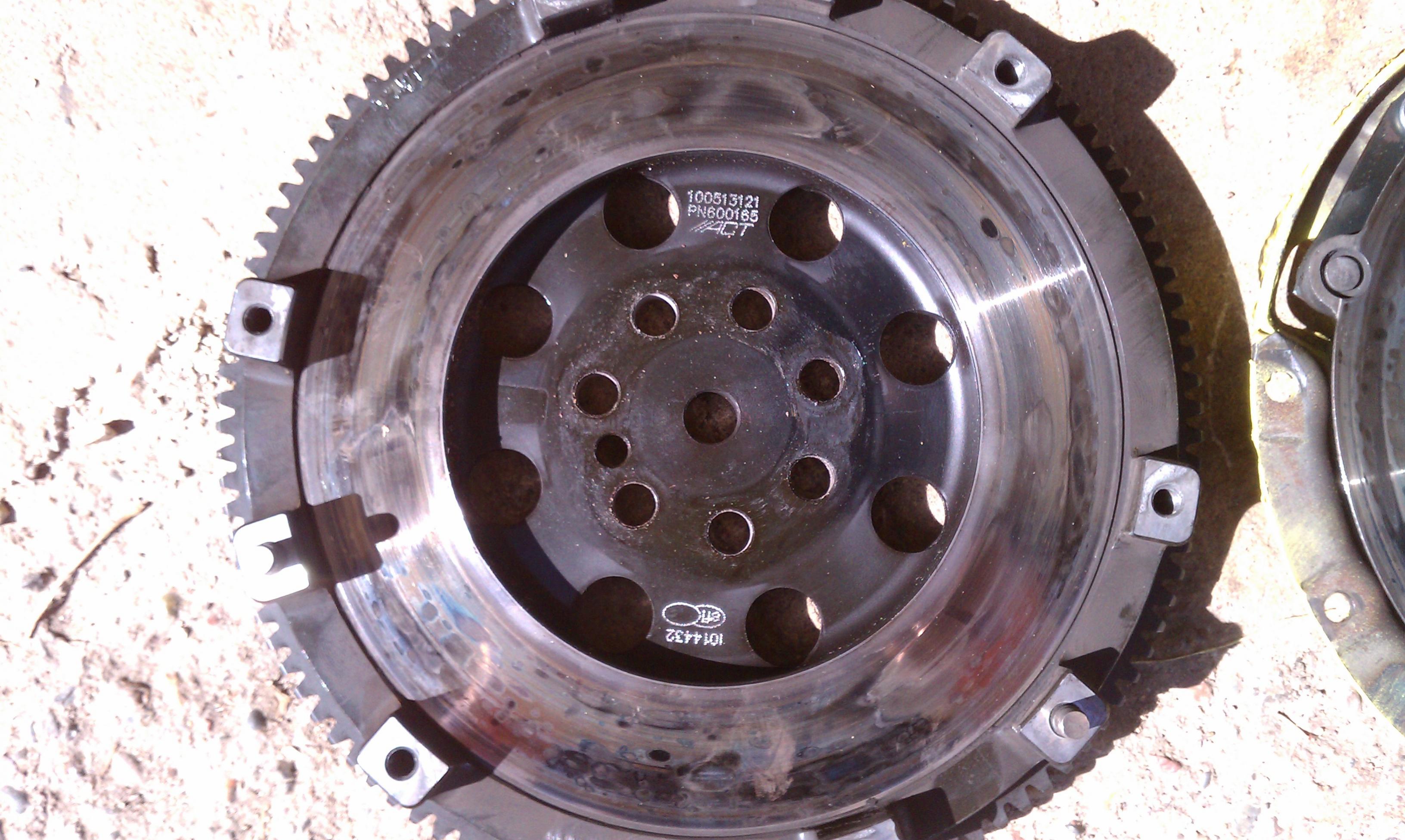

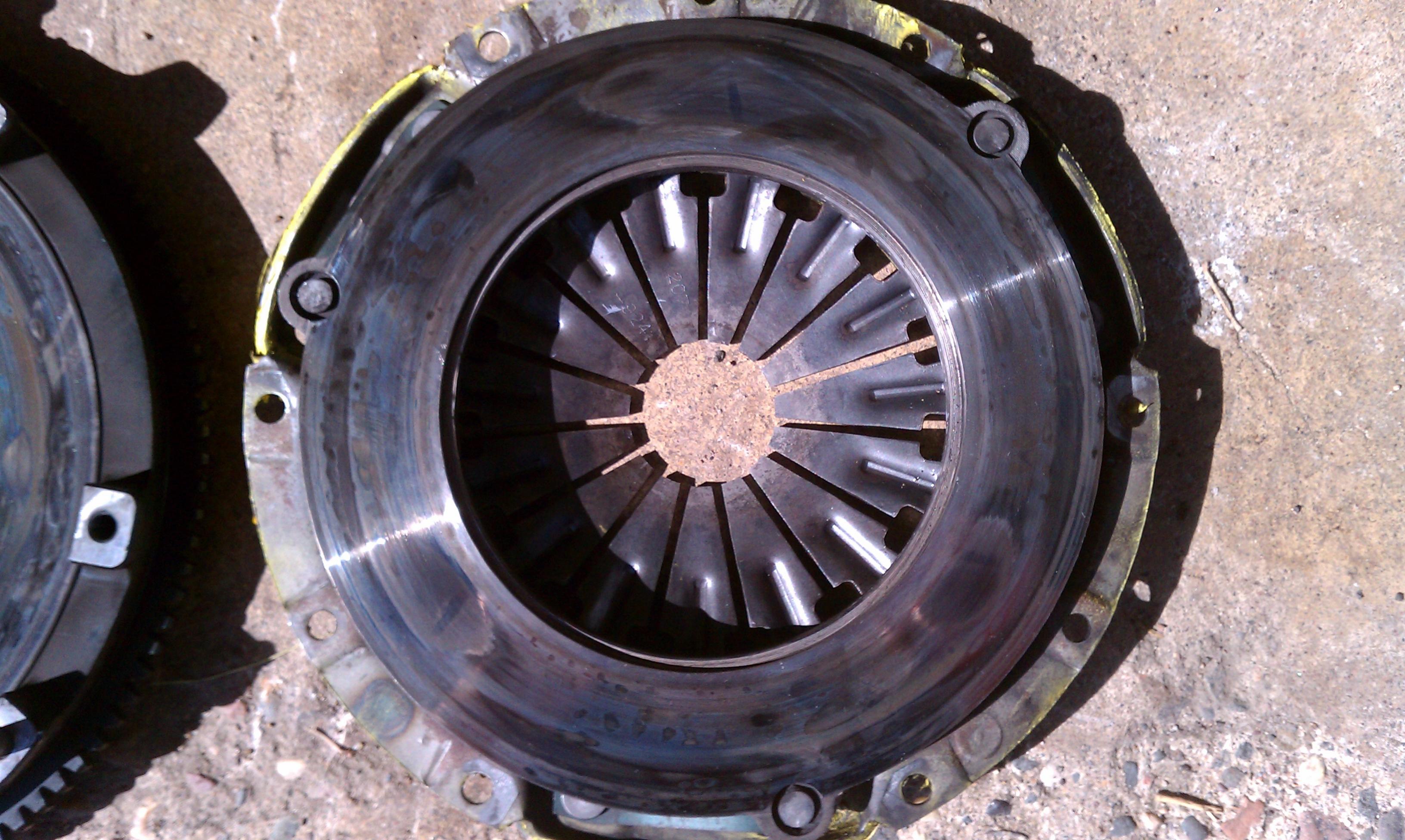

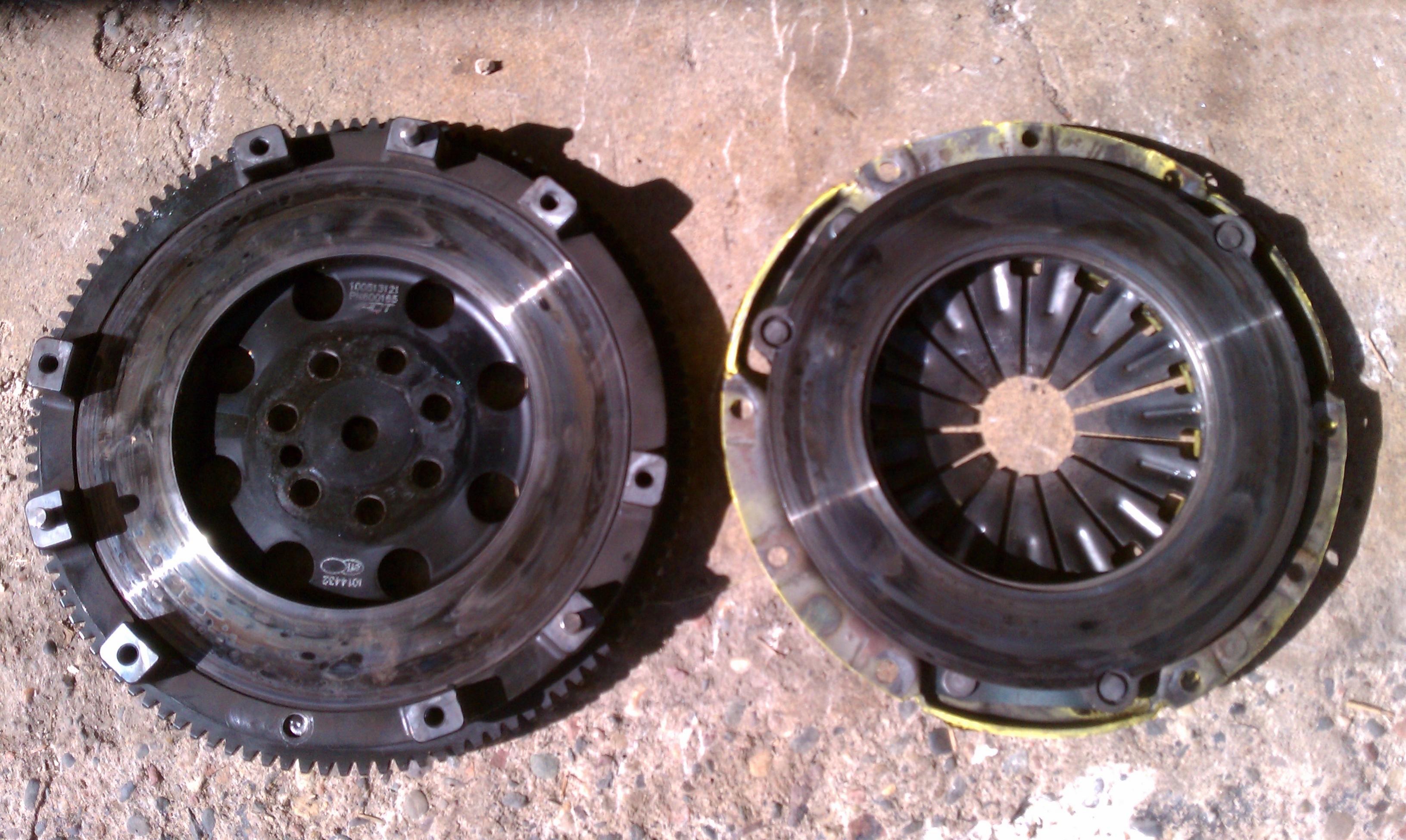

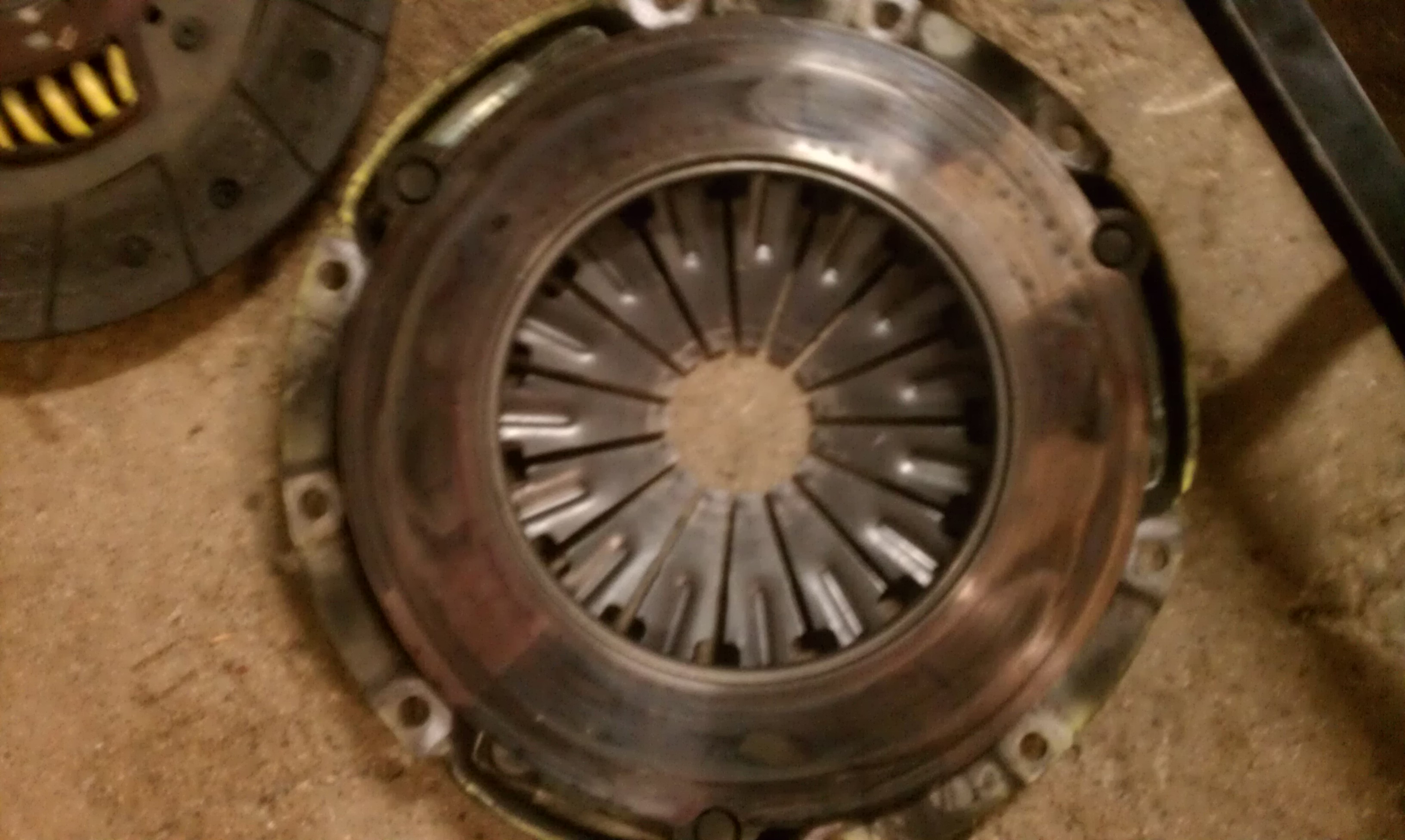

Usuable or unusable PP and flywheel?
Curious as to what you guys think about using these. There are quite a few hot spots as shown in the pictures, but I have gotten different opinions on them being able to be used again, so I figured I would see what everyone thought.

I'd get the flywheel resurfaced if possible and buy a new clutch if it was me.
I'd be super pissed at myself if I tried to save some money only to end up having to spend more money (trans fluid the clutch I should've bought in the first place) and a ton of time to pull ithe trans back off if the clutch started slipping.
Old 03-14-2012   #3
Re: Usuable or unusable PP and flywheel?
I agree, resuface and get a new clutch. They would probably go in and work ok, but they won't hold as much power as they should.
Old 03-14-2012   #4
