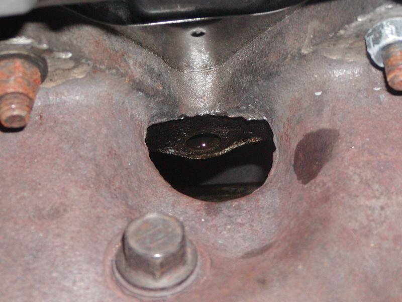

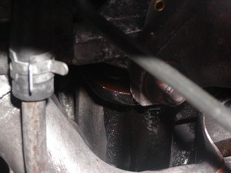

It looks like the waterpump is shot. I add coolant/ water and it just leaks right out. On the other side above the transmission its leaking oil. I'm not sure if its also leaking oil by the exhaust manifold or if its just running and dripping from there. I will post the pics and try to explain best I can.
Note: I just replaced head gasket and all the ones above that.

It doesnt even look like the head is all the way on...

sonofabitch...

WHOA, THAT IS NOT GOOD hmy:
Besides stating the obvious, I would say it's time to take it back apart. Which is also obvious. Hard to really tell anything from the pic of the corner of the head.
Did you use the correct size head bolts/studs?

That center exhaust manfiold boltis actually an open hole into an oil gallery. W/o a bolt in there its gonna spew oil everywhere.
Nick
