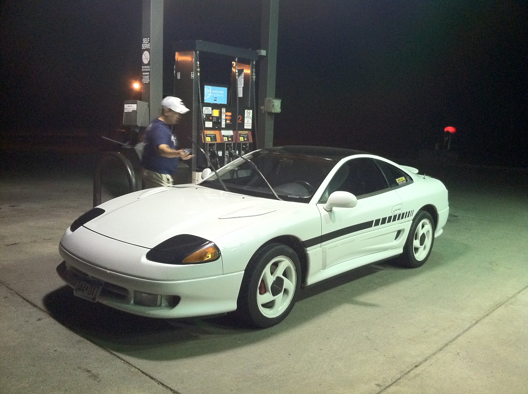

Pictures at first purchase:
ID:	11990   Click image for larger version

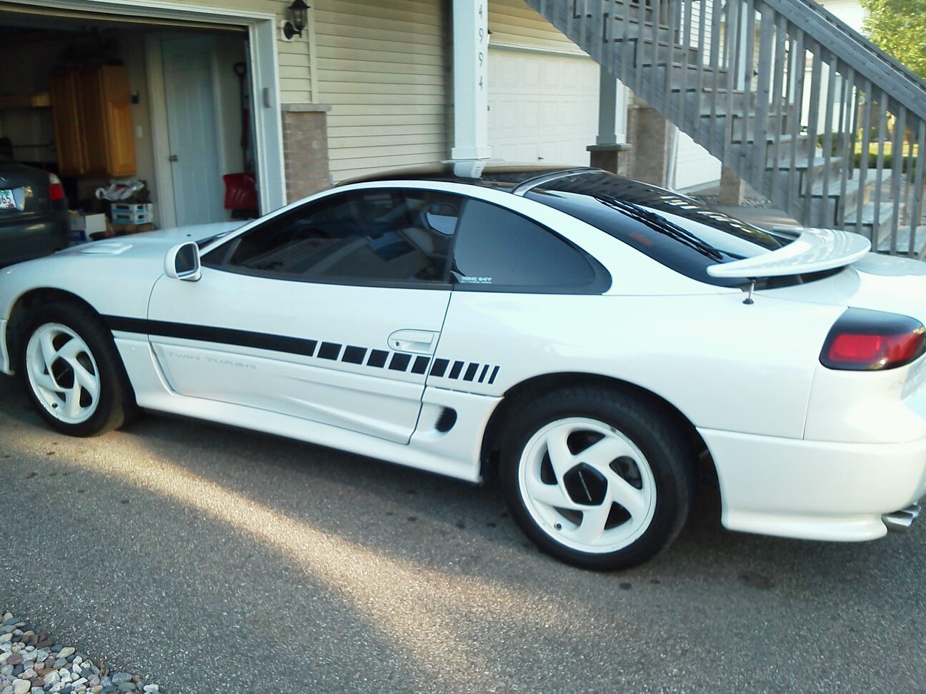

I had this 1/2 way completed last night, then went to bed and shut off my computer . First post updated
Most recent picture with decals pulled, legal rear tail lights, and working window regulators:

Old 09-15-2011   #7
Re: Lucky #13...Back in the saddle....92 rt/tt
Does it still have the stripe on the side. I think i saw you yesterday on 169.
Old 09-15-2011   #8
Wasn't me as the car has been in my garage now, having crap ripped out of it, for about 30 hours now. Last time I drove it was Tuesday night.
Must be a clone.
