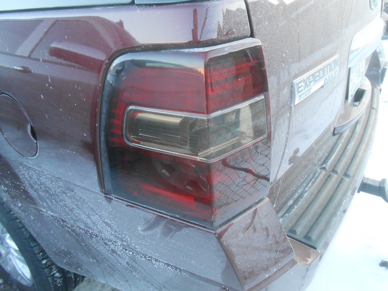

Its nice if you want to not go quite as dark to hopefully not be bugged by the cops. But you can go darker. Kind of dirrrty picture

Re: tail light tint
Originally Posted by AwdGSX13 View Post
crappy tinting clear? lol thats funny.
dbc500 is for tinting with base coat not adding to clear coat. you can do it to clear coat but is really not the right way to do it.
the method is basically taking a single stage and mixing a small amount with clear, and then go over again with another coat of clear. It turns out nice and still retains a gloss. We also use different products, and shoot with waterborne.
At any rate i'm sure he will be happy either way.
