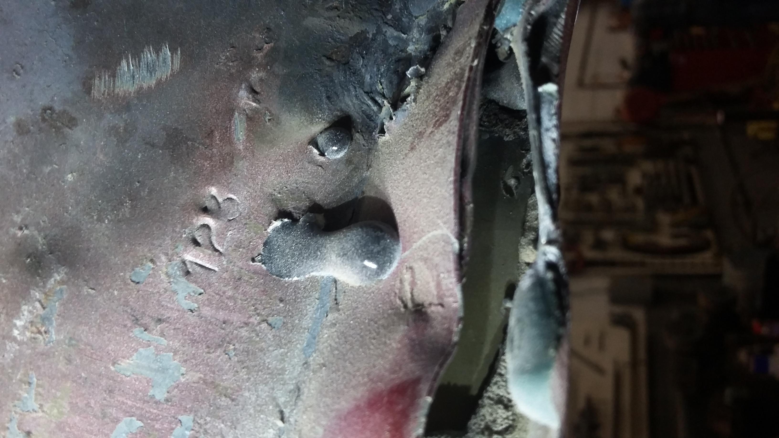

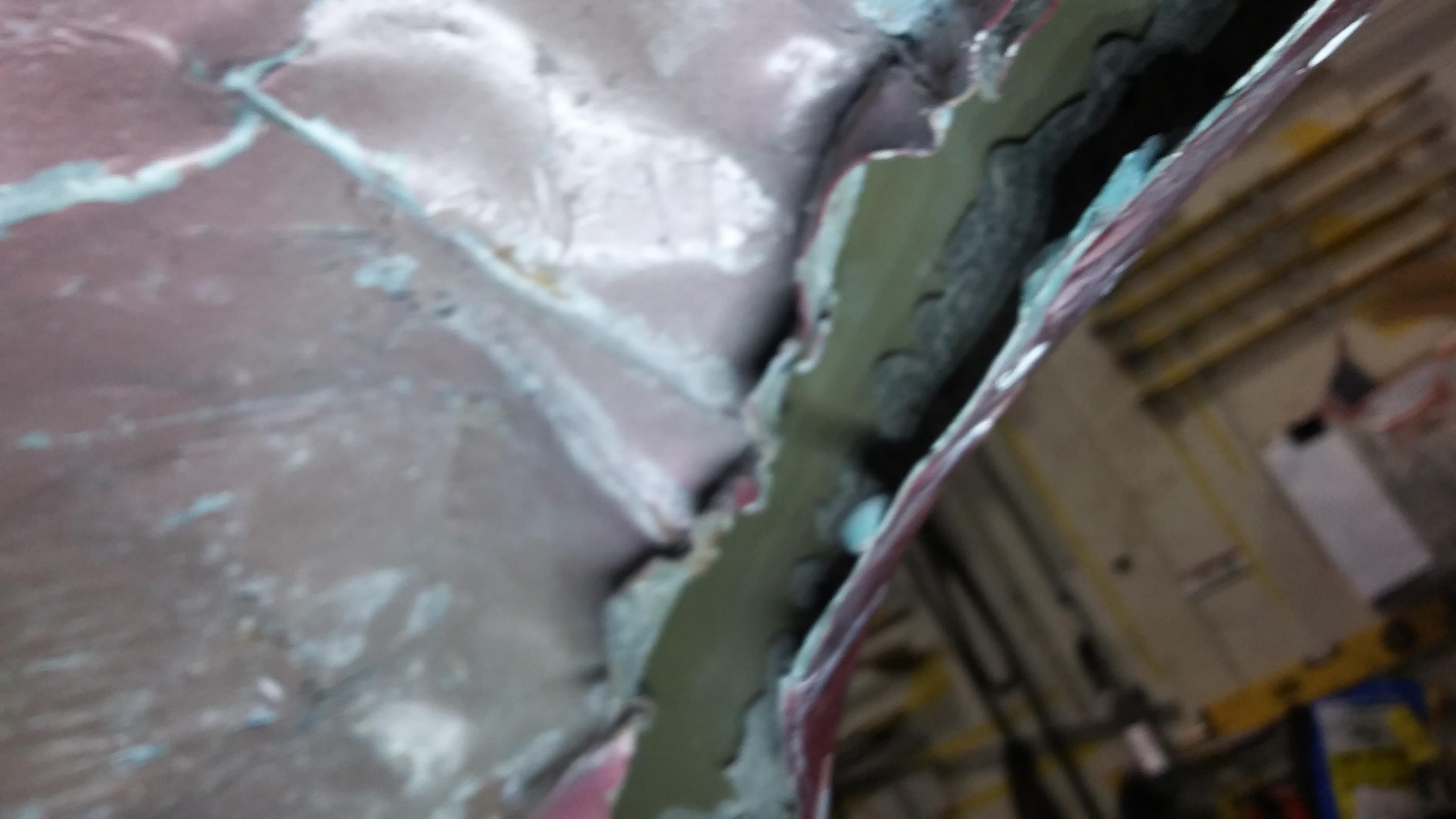

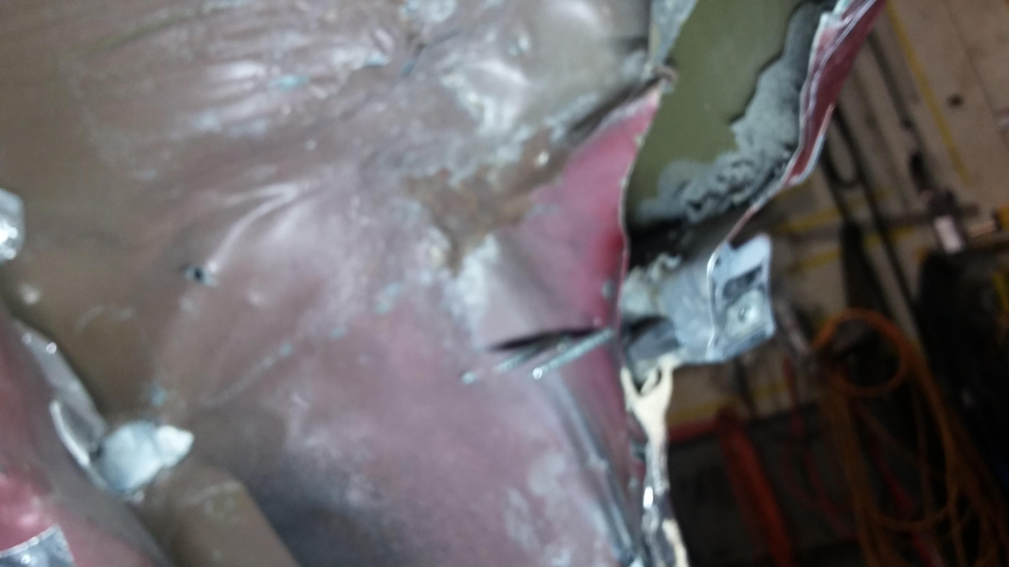

Here's some pics for now. This is a car that I was asked to redo the work on. After we sent it to a body shop to put a quarter panel on. This guy tells us he is the best. Well this is his work. You be the judge.

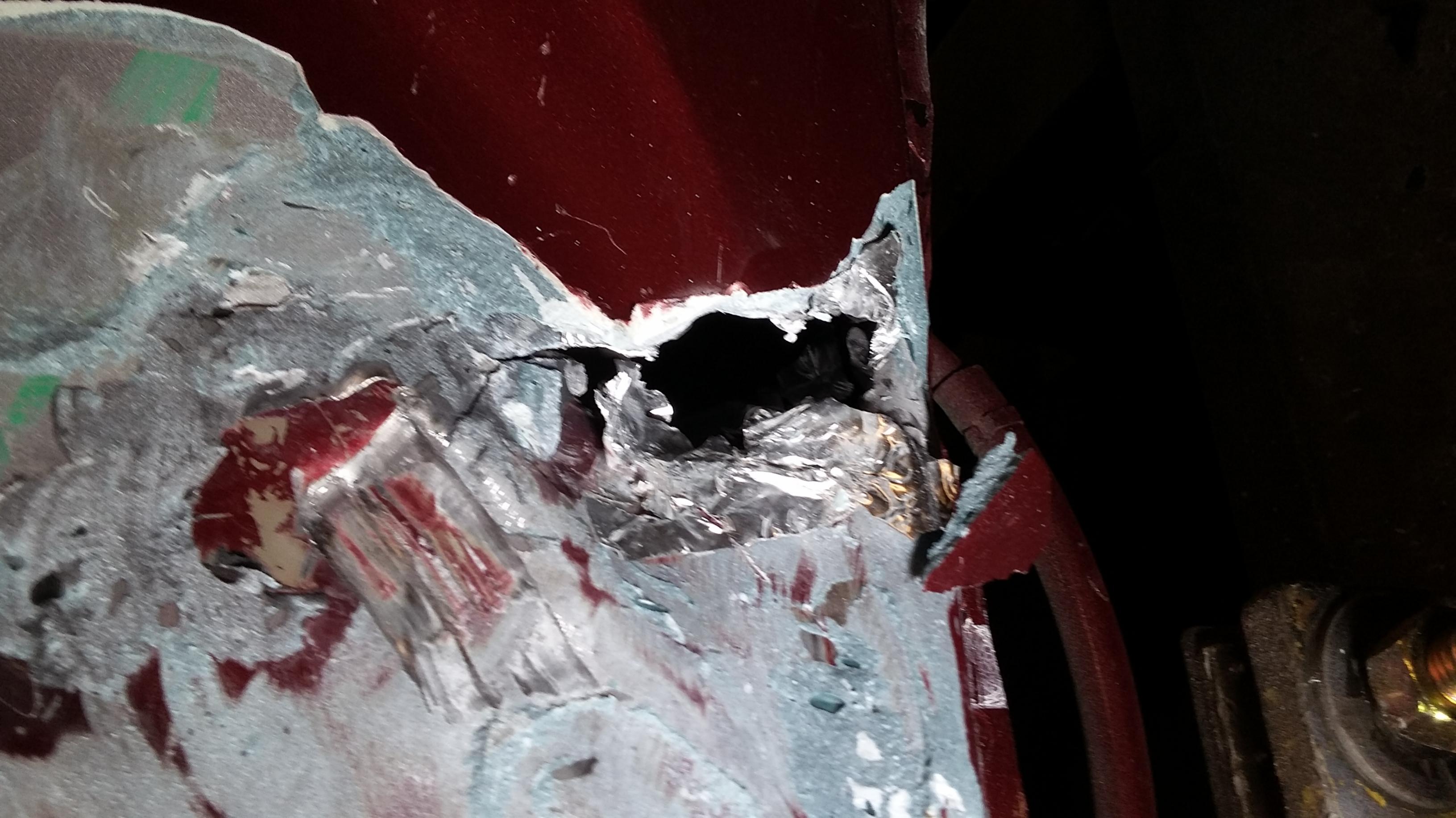

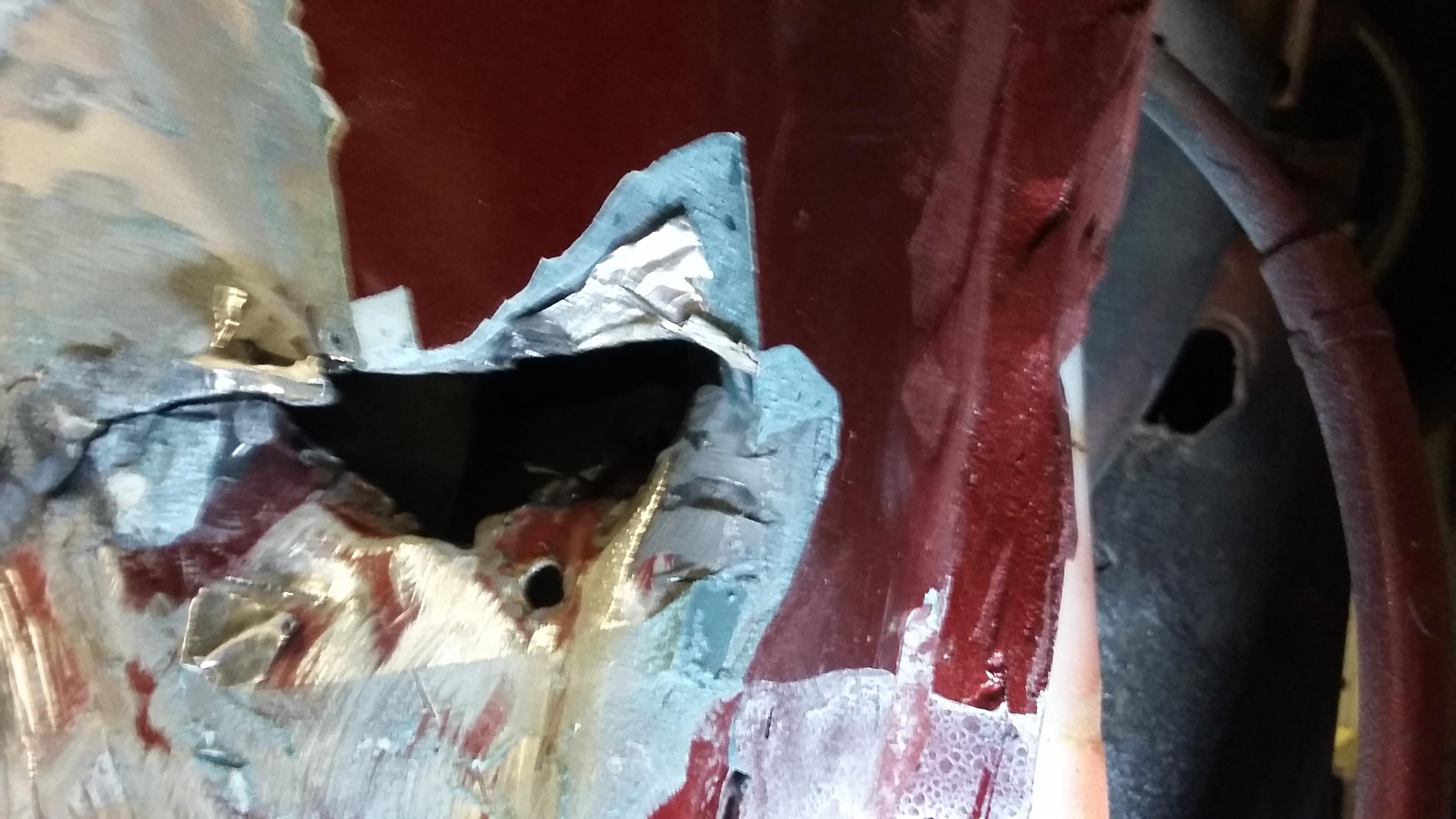

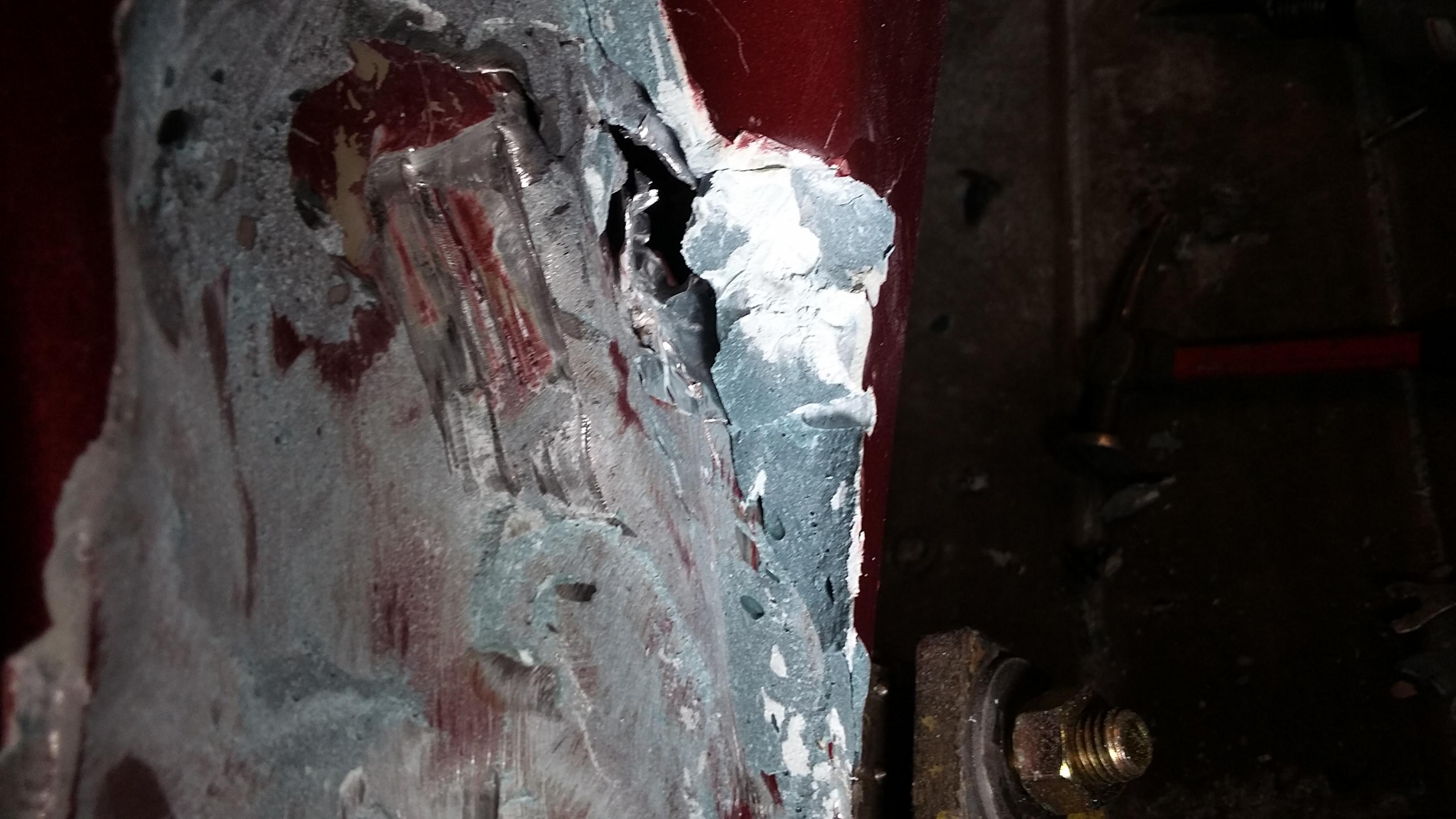

So in these photos shows were the new quarter panel meets the rocker. It's shows how my bond and filler the body shop used to make this think look right. The hole you see in the pics is where the put some hvac tape so the bond wouldn't fall in. I found in some spots the bond / duraglass was over 1 inch and a half thick.

Re: Bad body shop
These pics show where the quarter panel meet the inner fender / inner structure. It was a total surprise when I saw this. I took the plastic liner out and poked my head into the wheel well and saw this. I couldn't believe my eyes. What kind of body shop or person would think this is ok? I was really surprised on how bad this car was. Cause if you looked it before I took the hammer to it. The paint was nice and the door gaps were nice. It didn't look like it had a 55 gallon barrel of bonds spread on it.
